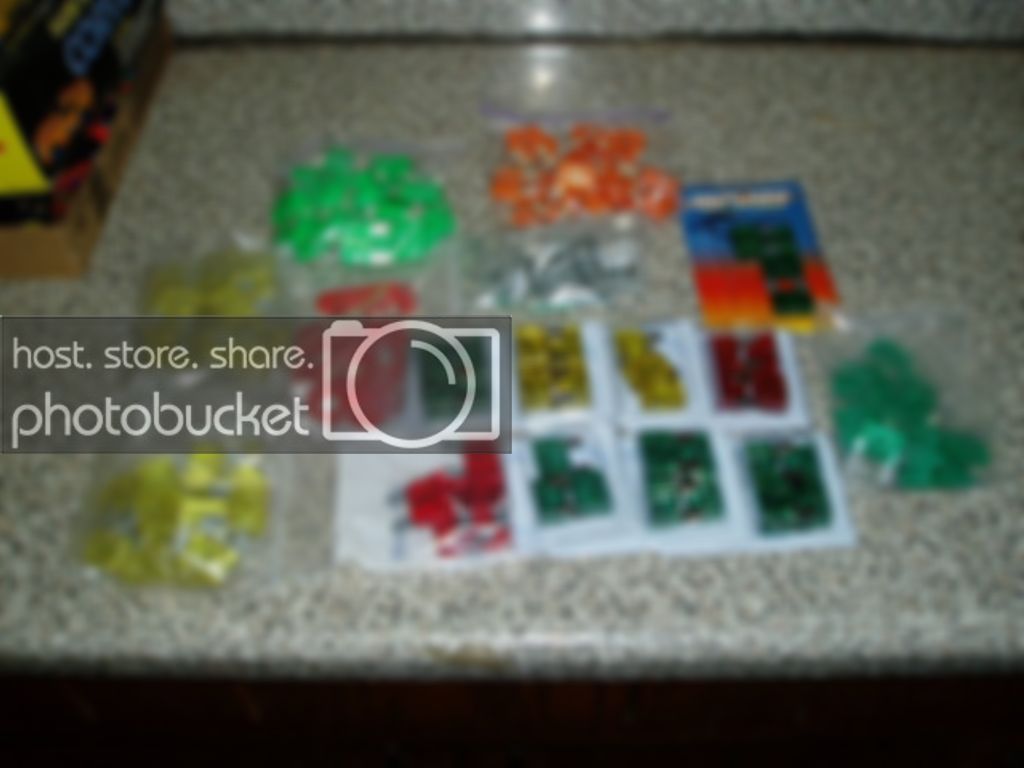

FYI, I still have about 150 MAXI fuses lying around. //content.invisioncic.com/y282845/emoticons/biggrin.gif.d71a5d36fcbab170f2364c9f2e3946cb.gif

and WOW lol 150 MAXI's eh?

And I have a bunch of MAXi's sitting around too. lol

And I can't sell these MAXI fuses to save my life. Nobody in their right mind wants a bunch of 20 amp maxi's.
