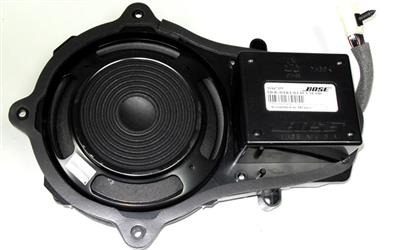

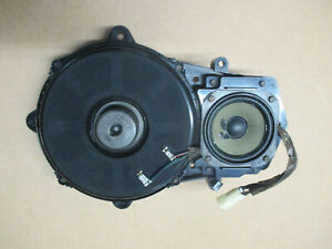

The default corvette speakers have a black box on the back. I am guessing this was an amplifier of some sort for midbass. They came with 3" tweeters and an 8 inch sub in the doors.

I'm not too impressed with Alpine S line. Type R is quite nice and X series has always been top tier. Really in general I find the lowest model line for anything typically is to be avoided and anywhere in the middle will be a better value/performance. For entry level components I've used the Kickers in my pickup and they're OK for the money I thought. If you like yours, keep them. You might could get better performance whether you keep a 6.5" mid or bump up to 8" if you spend some time/money/effort in sealing and sound deadening the door locations. That's generally the most return on investment for time and money if you're after better midbass.
If you can get 8" and 3" woofers up front in the doors you may have some good options for 3 way fronts CDT has a good range of offerings or you could just browse Crutchfield and see what's out there off-the-shelf for 3 way kits with an 8" woofer.
