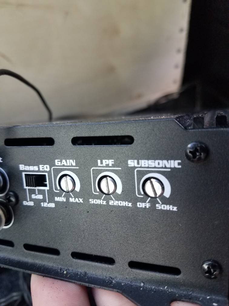

Where would you set the SSF and LPF? I ask because they aren't exactly labelled well. I'm not sure if SSF is 0-50 or if off is actually something like 15. Box is tuned to 36hz

I would do SSF @ 32ish if you're tuned @ 36hz
I like my LPF @ 60-65hz
This is sorta a preference thing so it will vary between user but especially with the SSF you need to know the limits of your sub.
I would do SSF @ 32ish if you're tuned @ 36hzI like my LPF @ 60-65hz
But how to know where the knob needs to be for the 32. Is halfway 25?

yeah thats the way i guess it, u should go 60% and see how it sounds, play deep stuff if sub sounds weird rise it up tad more... lpf i always do 80-100hz but if u don't play rock u can stay 80 or under.. i just adjusted mine 30 min ago..
