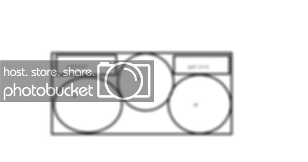

well if you only have a height of 31" then you cant do two on bottom one on top either. Sounds like you might have to come up with a new plan.
well it might fit if you space the bottom two out as far as you can then put the other in the center.
ok this is just made up real fast but you get the idea..
Well yeah problem is I dont have a modelling program or anything to tell me if I can those 3 18's on that baffle, the numbers are a tad hard to crunch
Im not set on a slot port. Im all for a 4th order, diamond port, maybe a folded baffle or something.
Just looking for ideas. Im not afraid of fiberglass either
