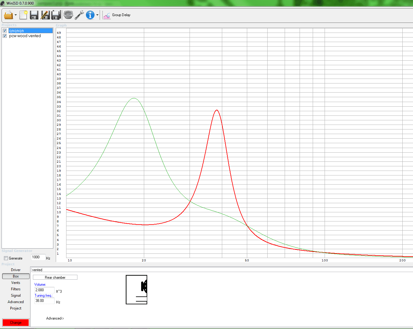

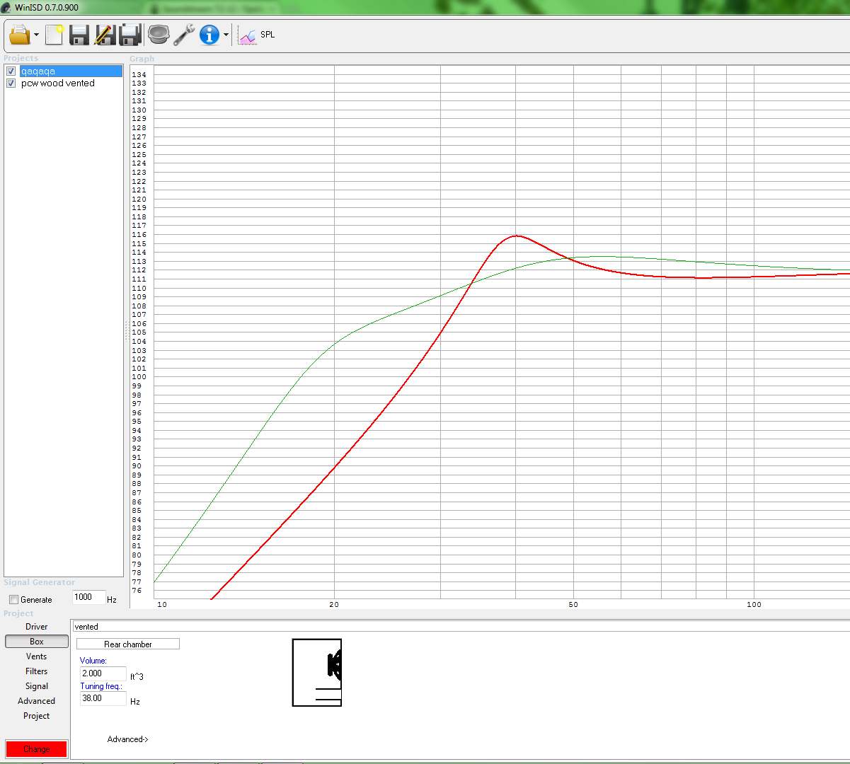

Anyway, I've tried this out in winisd, in the recommended box which is 2 cubes at 38hz... not really a fan of this, looks pretty peaky and the group delay is horrible, don't know what others opinion on this would be. The green line is what I currently have, the red one is with a T2 at 350WRMS.
SPL
Group Delay

alright great, hopefully the response curve looks a little nicer than what I plotted. Otherwise I'd probably stay with what I've got now. Just curious, what's your opinion on those response curves?

I would contact Moble Enclosures to design your box. he can design a kick ass box.
so basically you're saying it's crap lol. and nah I design my own boxes, I don't feel like paying someone to do it, I enjoy learning how to do it myself.

For future reference all you need for those modeling softwares to give you a response curve is Fs, Vas, and Qts.
IMO that's a decent looking response curve. Cabin gain should give you a decent boost around 50-55hz so you'll wind up with more of a plateau between 35 and 60hz or so when you actually measure response. You might try tuning a little lower to mellow out that peak a bit, but at the end of the day the accoustics of your vehicle will be a bigger factor in determining actual performance.
Just by the mechanical specs it seems like a much more robust platform than what you have and could only be a step up IMO.
