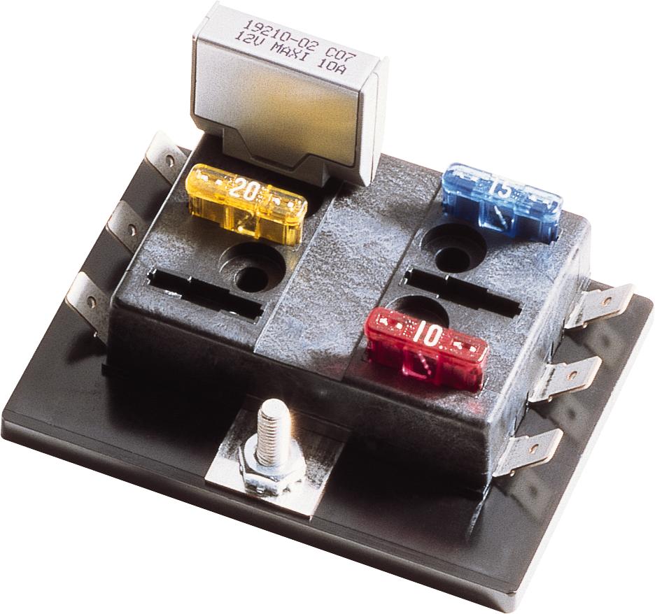

i've used these Bussman fuse blocks before. Autoparts stores sell them.
Bussmann 15600-06-20 Fuse Block ASSY.
allows you to have one input and individually fused outputs. the relay could feed this then you have multiple fused outputs. granted, the relay can usually only handle 30A or 40A and the wire at the battery would need to be fused for the relay contact rating. 10awg for 30A and 8awg for 40A.
