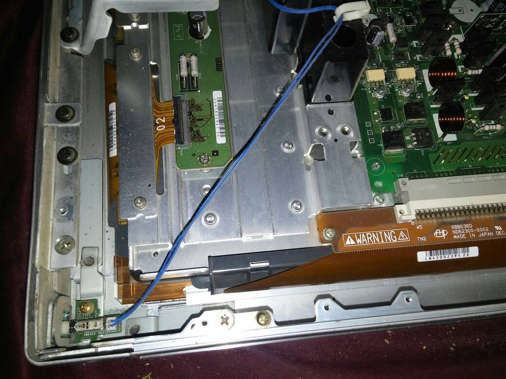

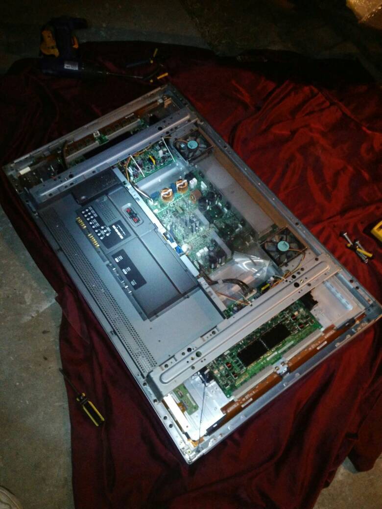

So i flipped the tv over took off the back panel now its laying in the backyard on the ground on a blanket. I dont even know how much IF any soda did leak into the edge of the top side panel because the back side is dry and too many pieces seperate the front side.

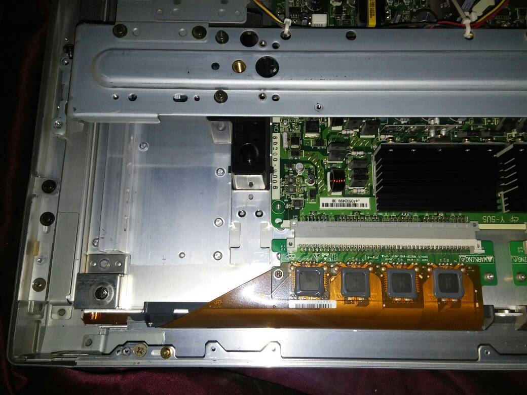

mainly i would worry about it seeping into the connections on the edges of the screen. the plastic front cover comes off. the glass screen is glued to a large piece of aluminium under all the circuit boards.
Im assuming my only option is to leave it opened up laying on the ground to take it apart? Theirs a gazillion pieces and screws in this thing.

i dont know if id worry to much about it if you dont see any signs of liquid. its a lot easier to check with a flashlight. if you do take it apart just remove as little as possible. the circuit boards, speakers, etc can stay attached. the front cover is held on by the outer screws around the perimeter.
I ve got a dozen or so out back, but its after midnight and im three deep in vodka/sprites. if you wanna mess with it just start removing screws from around the outer edge. theres not really that many parts. just keep up with what goes where and its easy.

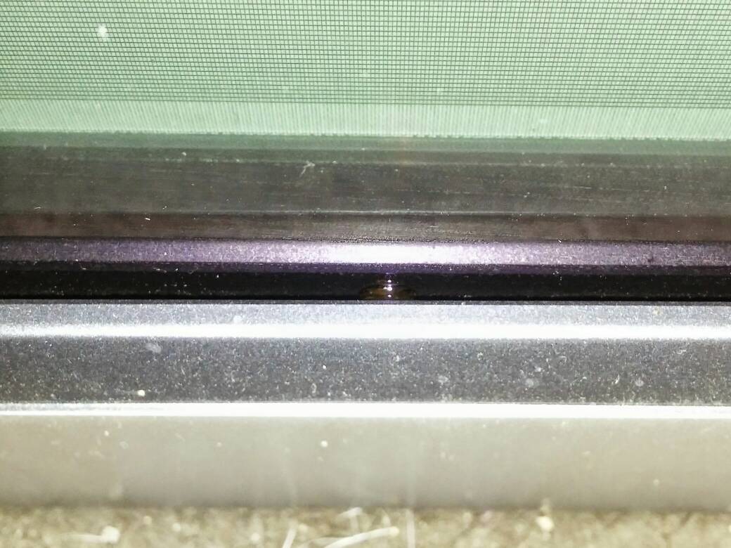

On this particular plasma tv it looks like it has a seperate outer glass piece which protects the second glass screen. Because when i set the tv upright to run a thin cardboard lined napkin to clean between the trim and the glass screen, the second part of the screen was swinging freely aparr seperate from the outside glass screen. And it looked totally dry. Only saw one wet spot.
But it looks like it wouldn't do any harm even if it were to get wet inbetween the outside glass and the second glass because it looks sealed... Hard to explain.
