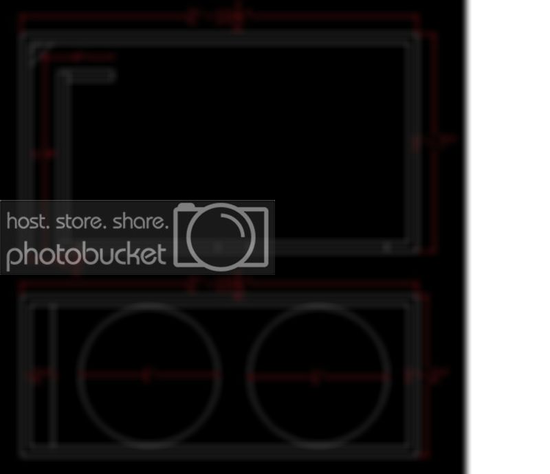

Here is what I came up with. Its 3.67 ft^3 and as best I can tell tuned to 31hz. I'm not very good with ported boxes though so hopefully someone can confirm this tuning, or I can fiddle around with it a bit more and try to tune it higher if thats what you want.
If this is right I can make some cut sheets for ya and such as well.
