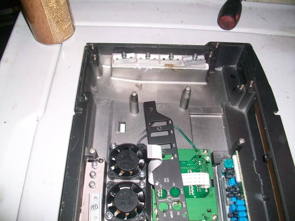

I knew something was loose so I popped it open and put the fan back in place, one of them was kinda loose.

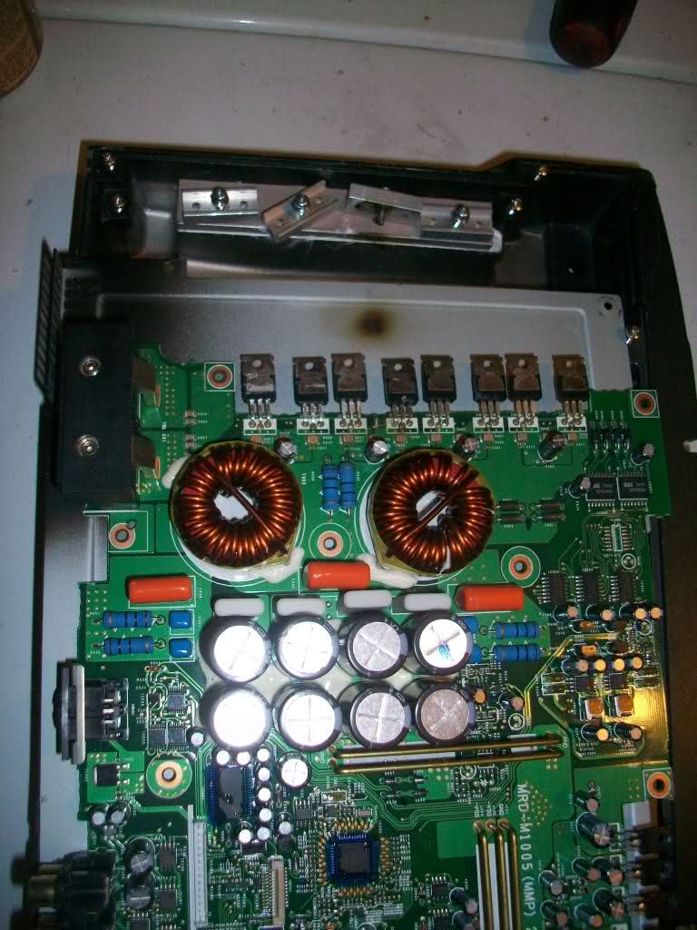

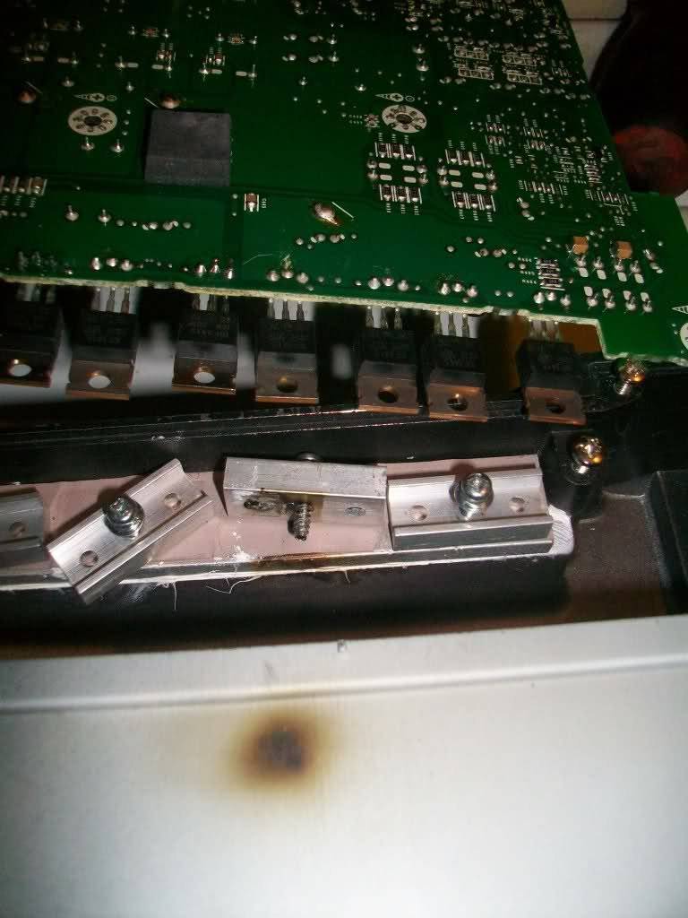

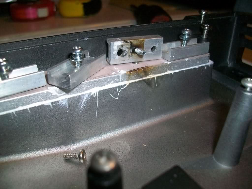

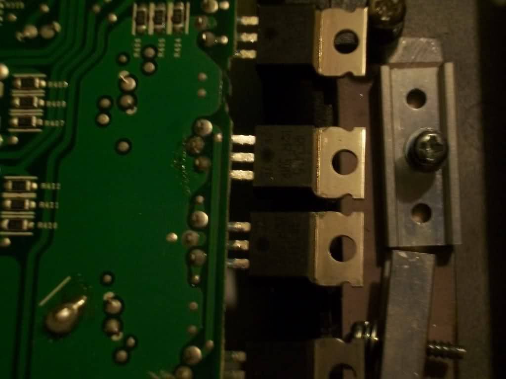

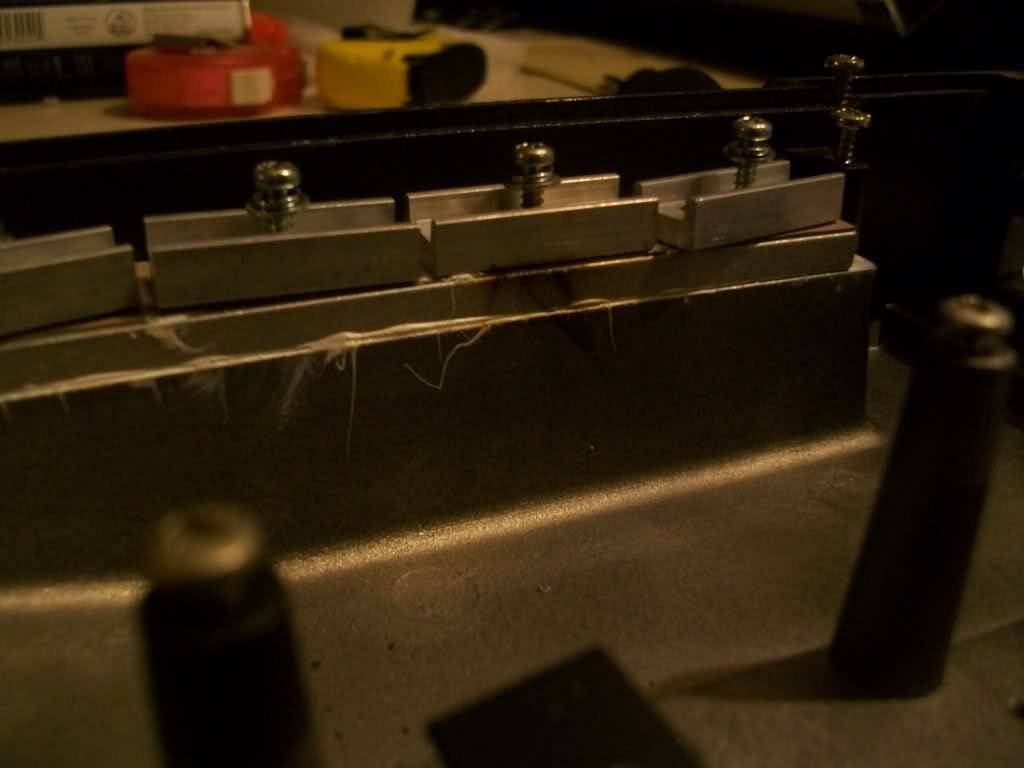

Here is what I found upon closer examination, you can see the burn marks on the side, but on the board itself there is NO sign or burning or any marks at all. Please advise me on what you think the issue might be, and what I would need to replace:

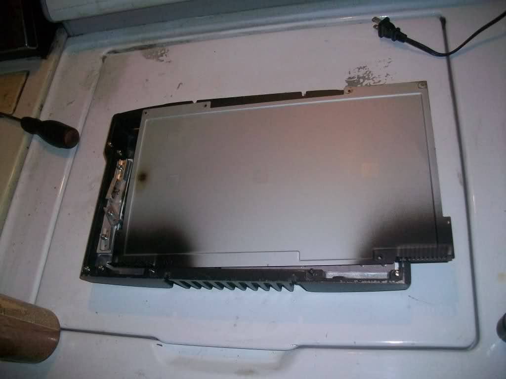

No, the dark marks on the corners of the pic below are not burn marks, it is paint from when I recoated the outside of the amp, none got onto the board. I coated it the day I got the amp, 2-3 months ago.
What you guys think?

I'm no guru but it looks like your 5-6 mosfets may have burned up or at least overheated enough to cause failure without exploding and melting their pins. (from the left) I can't tell what you are pointing to, camera flash is in the way.

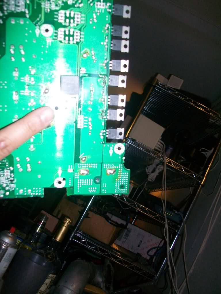

Oh I wasnt actually pointing to anything, I was just holding it at an awkward angle lol. In that pic I was just trying to depict the fact that there is burn on the actual board. All dark marks are only visible on the housing...btw are MOSFETS replaceable? It looks like its the #5 one specifically. Also, as part of the supply, wouldnt the amp not power up at all if it was damaged? OR what exactly does the MOSFET system power up? Just display? Just sound? Or everything?
