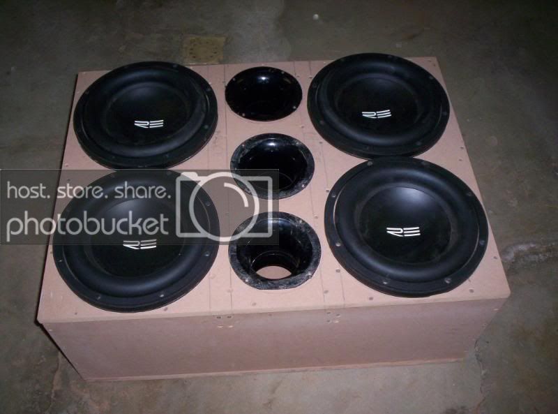

so I started my four RE MX 12's build today (pix)

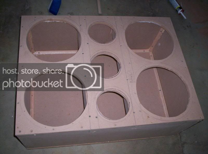

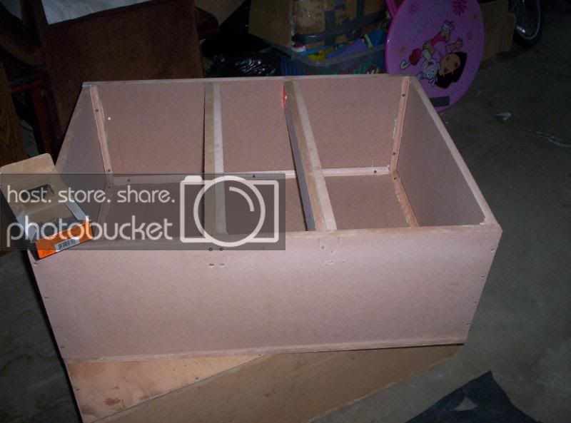

This is bracing since I dont think I have the room between the sub and underside of my hatch to add another ~1" of wood or else I'll have the sub hitting it and thats bad...

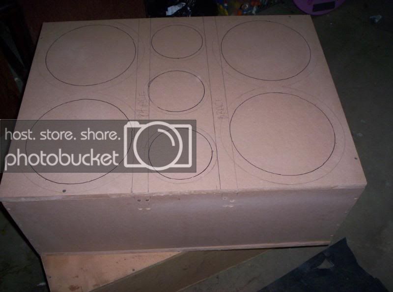

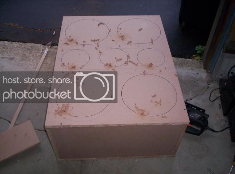

I had a nice little template going here, definately worked out great knowing where stuff was going to go and how much room I had to work with.

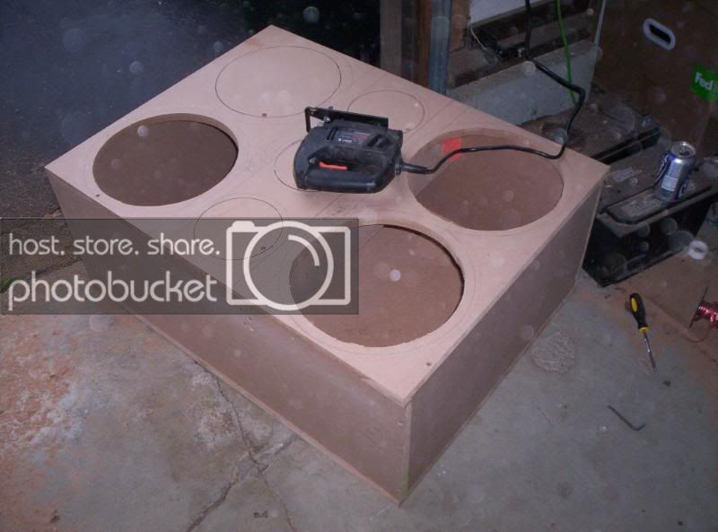

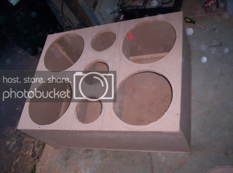

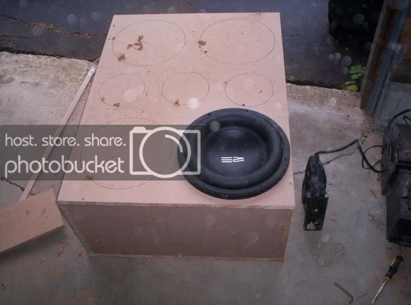

Drilling some holes for the jigsaw
First hole was a little rough but I got it in just fine
Getting there
Done!

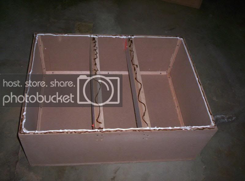

Cleaned it out and before I put the top back on lets put some glue and caulking on.
Here it is with everything screwed down, pardon the "45's" in the corners, it was my first time and I didnt do as well as I wanted!
Looking good so far

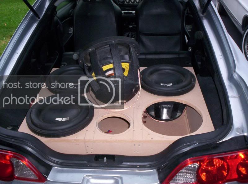

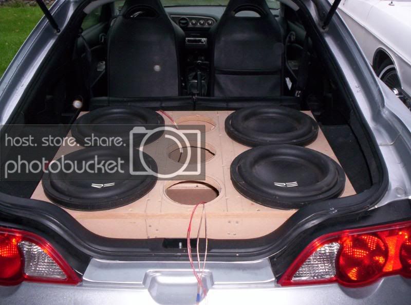

Box is in the car!

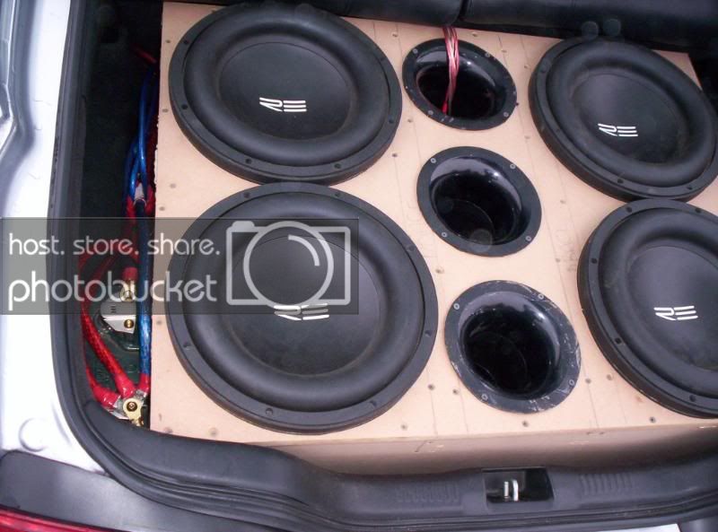

Wiring stuff up (each sub is dual 2 so each one has a 1 ohm load coming off it, the two on the left are connected internally as well as the two on the right, so there is a .5 ohm load coming out of the box, and each pair of subs has a 2500d hooked up to them!)

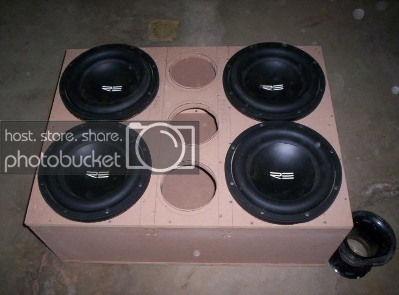

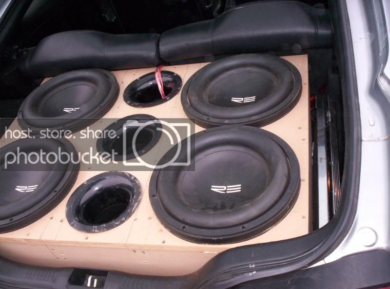

Subs are in...
Ports are in...
Extra battery is in...
Second 2500d is in...

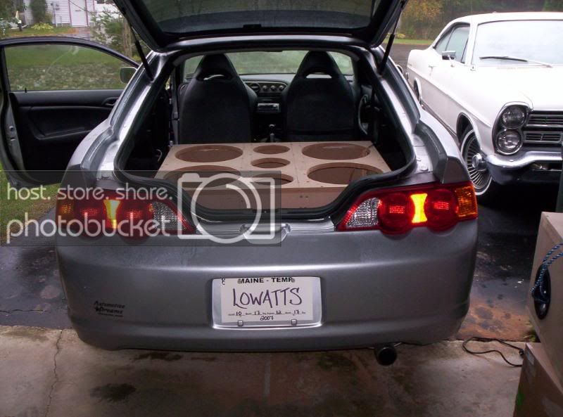

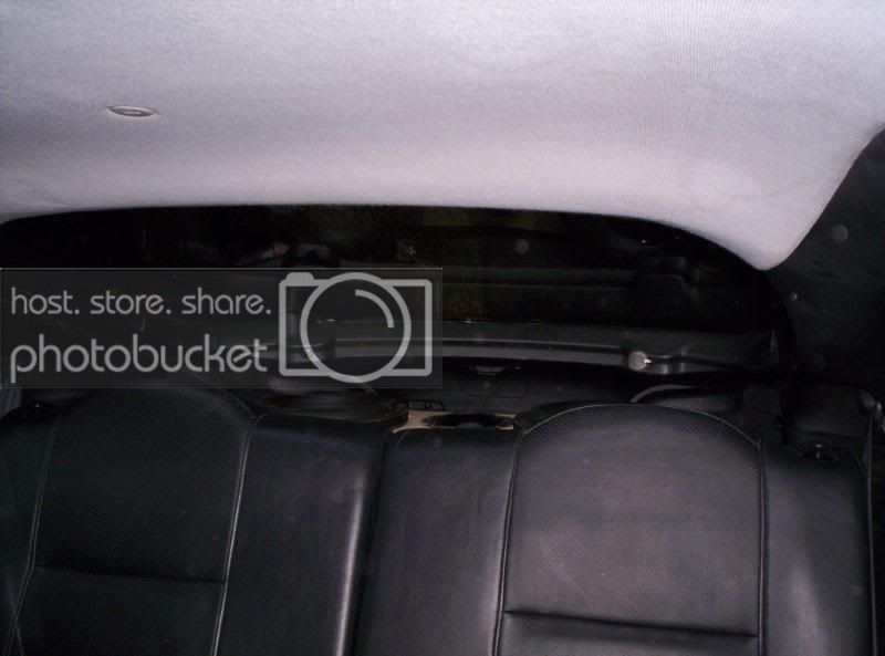

With the back seat up, cant see too much!
anyone want to see the end result???
Here we go!!
From inside the car, pardon the wiring, I was in a hurry to get it in (see my wiring mishap earlier haha)
And finally outside the car //content.invisioncic.com/y282845/emoticons/smile.gif.1ebc41e1811405b213edfc4622c41e27.gif I cant wait to hear it in all its glory!!
Questions, comments, concerns, criticism?
The ports are about 1.5" too short, luckily they were pre done so I didnt have to cut any. I do however plan on cutting the ones I have to correct size tomorrow, once again time was not something I had alot of so I just went with what I had and its tuned a few hz high, oh well.
