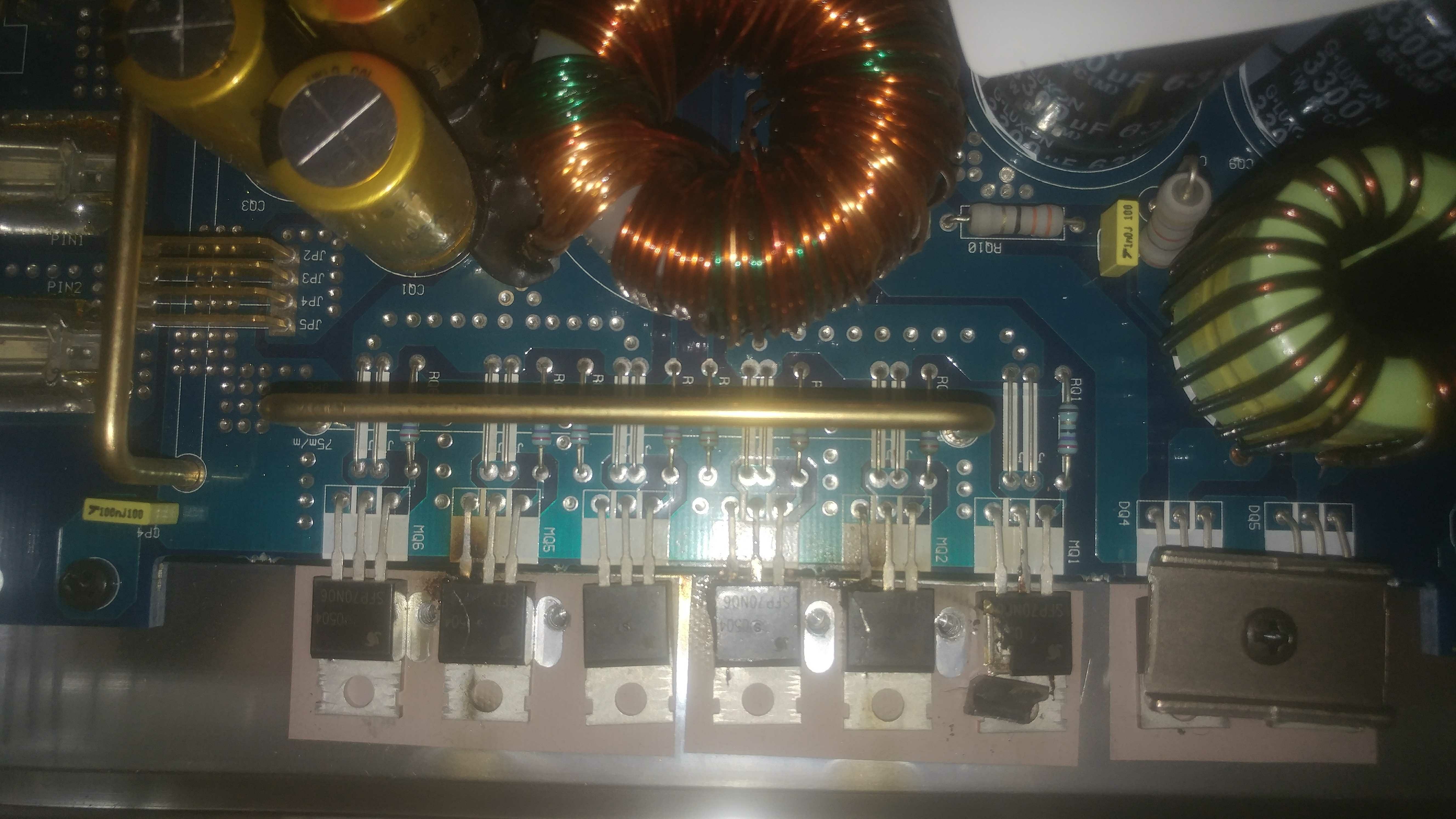

It is the one that went up in flames ill take it apart tomorrow and see what exactly failed

So it seems this is what went out I can prob fix or if you are interested in a trade let me know

Okay so I bought all the mosfets that need replacing just one question the amp has a 30a fuse so can it really put out 900w rms at 1 ohm?
