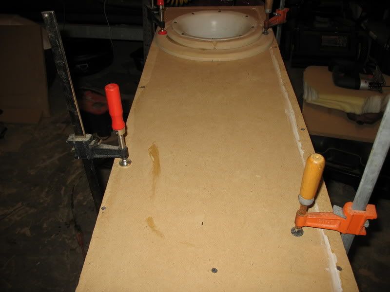

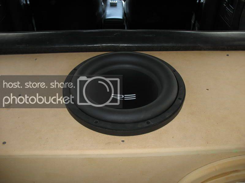

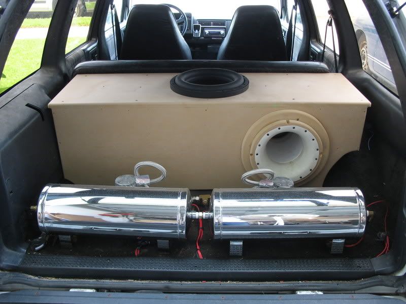

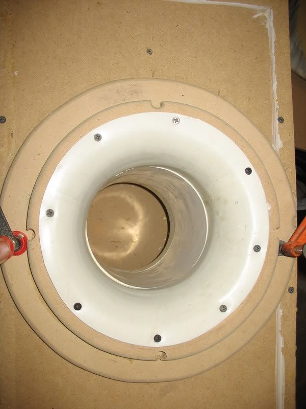

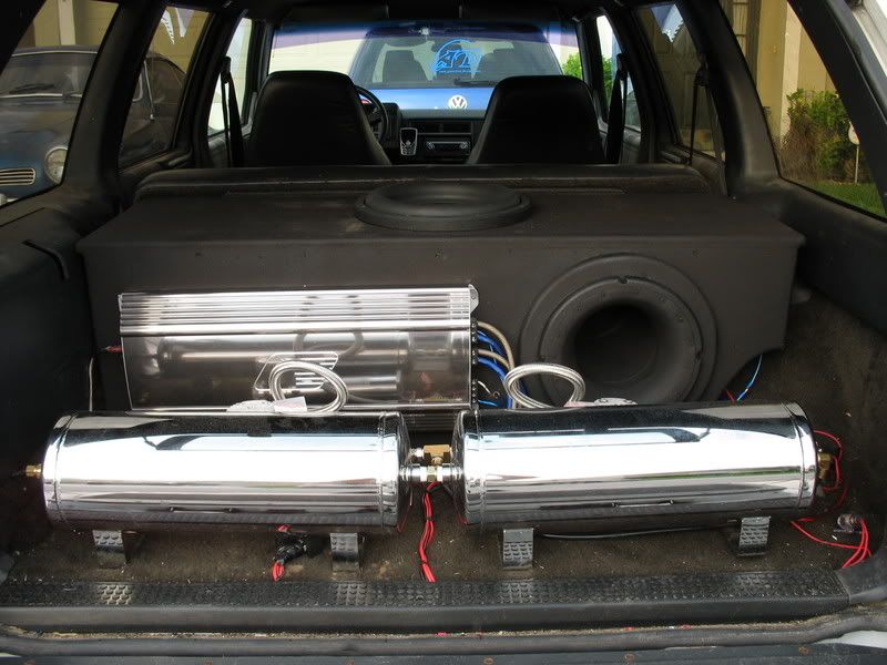

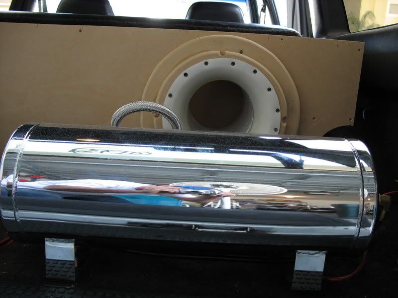

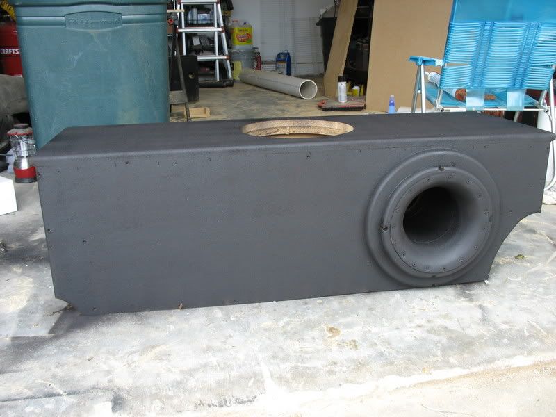

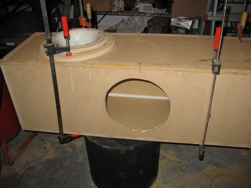

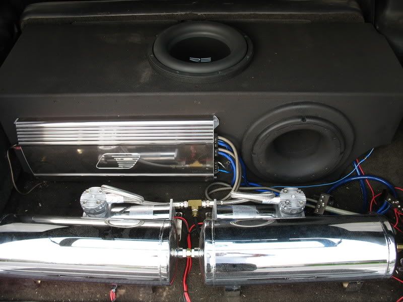

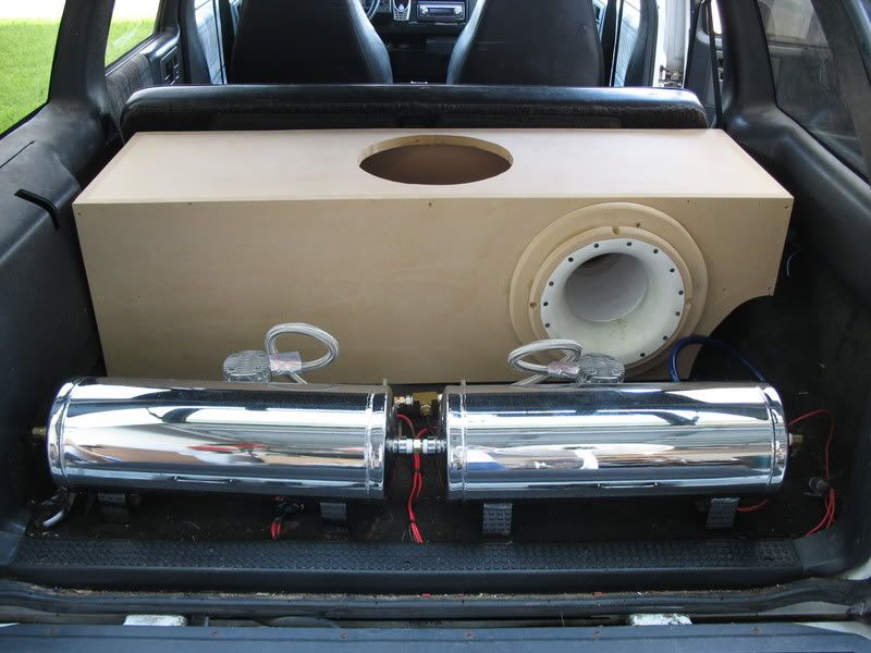

The box is 3cubes ported to 34hz. The problem was that it was to long to fit inside the box without the proper clearance from the back wall. The rings/spacers I put gave me 3.5" of clearance now. It's a flared 6" (on both ends) port. I figured this would be good for the RE MX 12". Heres a few more pix of the truck too.//content.invisioncic.com/y282845/emoticons/cool.gif.3bcaf8f141236c00f8044d07150e34f7.gif
Truck looks good, wish I could bag my blazer.//content.invisioncic.com/y282845/emoticons/frown.gif.a3531fa0534503350665a1e957861287.gif
