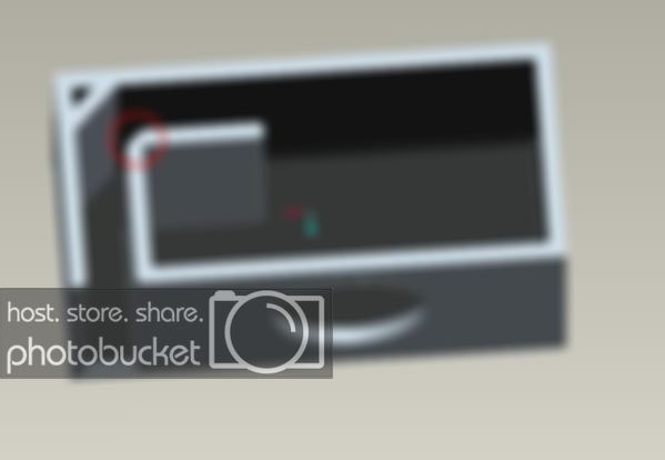

Brian Owens 10+ year member CarAudio.com Elite 1,296 3 Denton, Tx Apr 22, 2010 #32 . . . .since 45's don't remove standing waves. As for maintaining proper port width, 45'ed corners dont allow for nominal width anyway, only nominal radius (1/4 turn corners/edges do,) lol. geometry people, lol. Click to expand... My comment had nothing to do with 45's and standing waves. What I was saying is to 45 the inside edge of the port along with the outer edge, like in the picture below. . .Helps maintain nominal width. geometry, lol.
