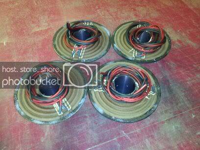

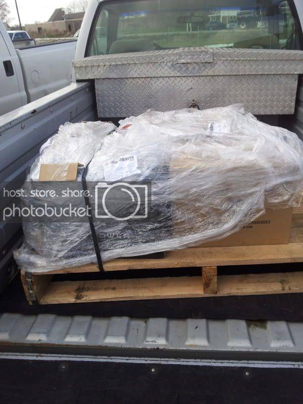

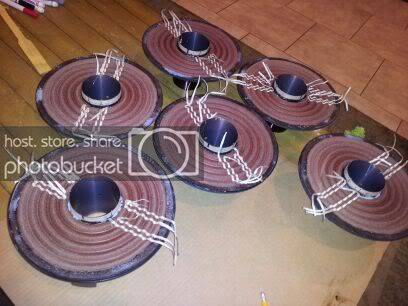

OP Skip01 5,000+ posts Diggy 7,339 0 Marrero,LA Feb 28, 2012 Thread Starter #24 Specs so far on subs: 3" coil 2.25" winding length 85mm xmax Flat wound coil 18ga 2000wrms 10.25" spiders (12"-18") 8.25" spider (10") True nomex material spaced on woofer for linearity of driver movement But they are all custom built too customers needs, so things will change as needed ---------- Post added at 06:32 PM ---------- Previous post was at 06:32 PM ---------- Oh an this stuff came.....yessurrrrr:
