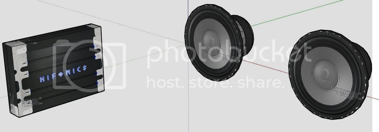

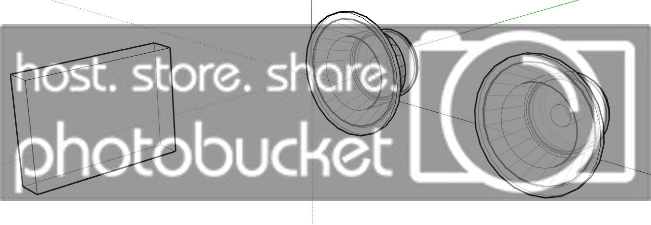

what can I say. I was bored at work :p I decided I wanted to visualize things better so I made a mockup sub with its key dimensions the same as a Diamond Audio D12"D4 sub.
I've played with adding textures to items before.
Fairly easy if you know how
