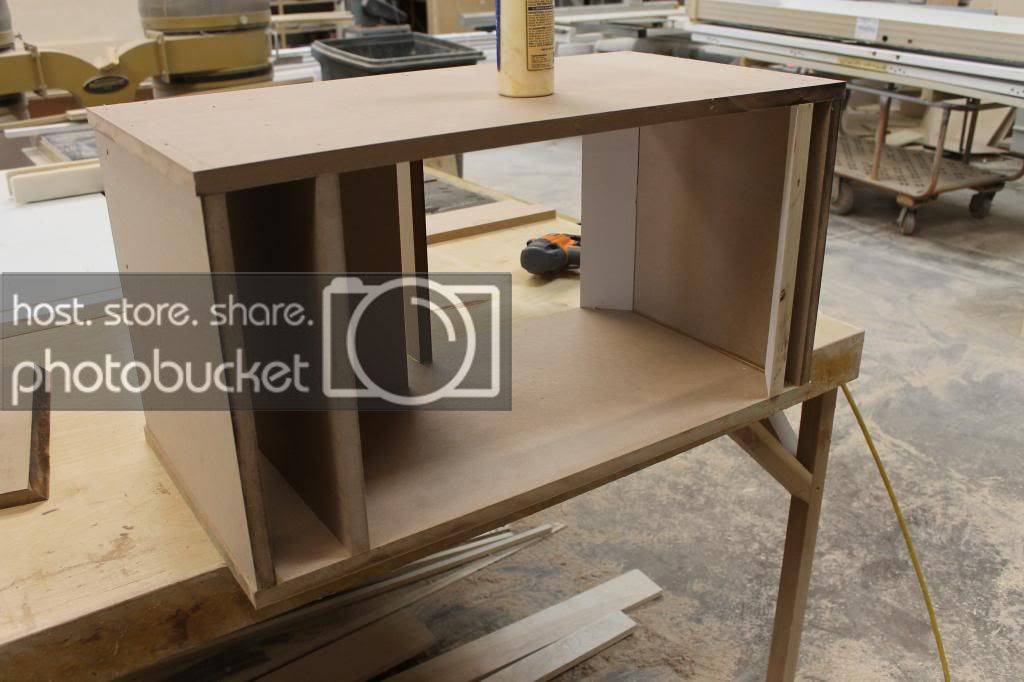

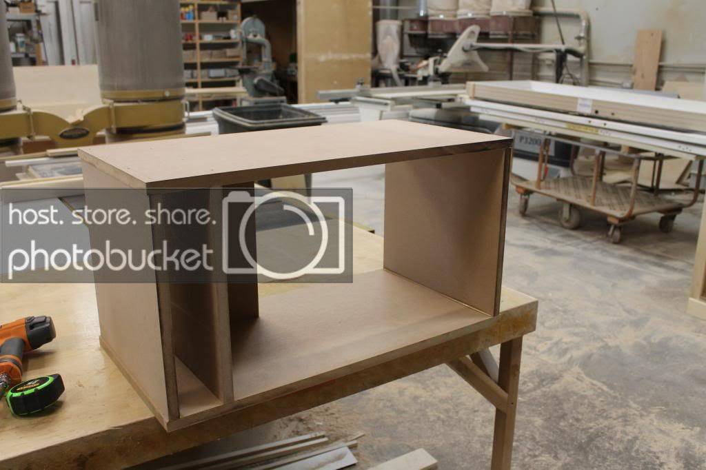

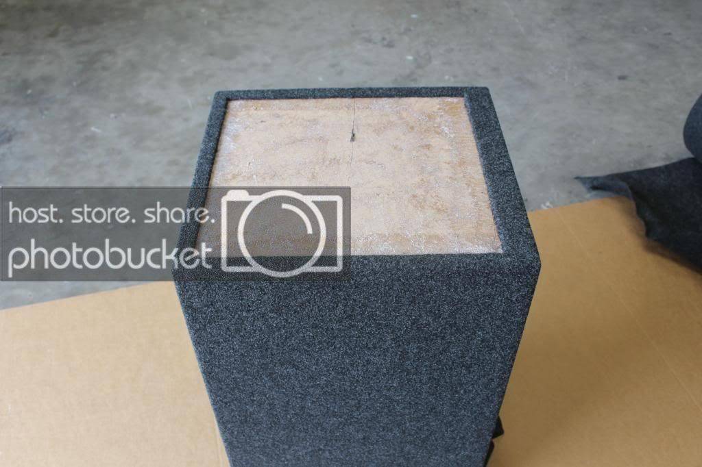

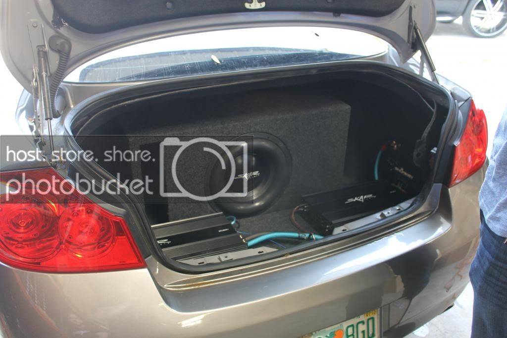

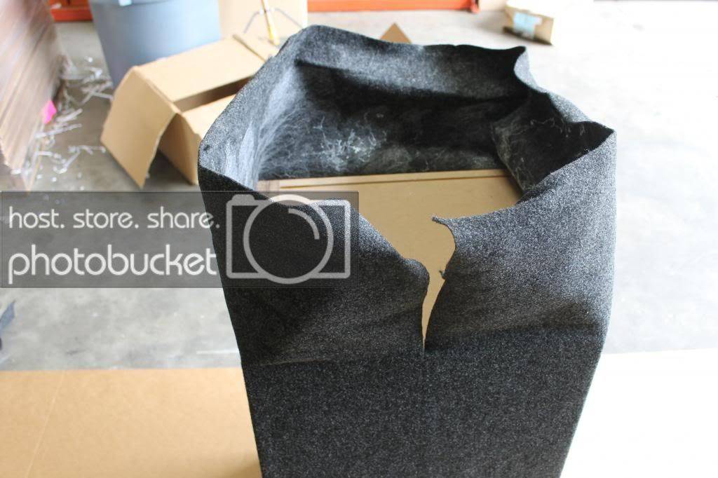

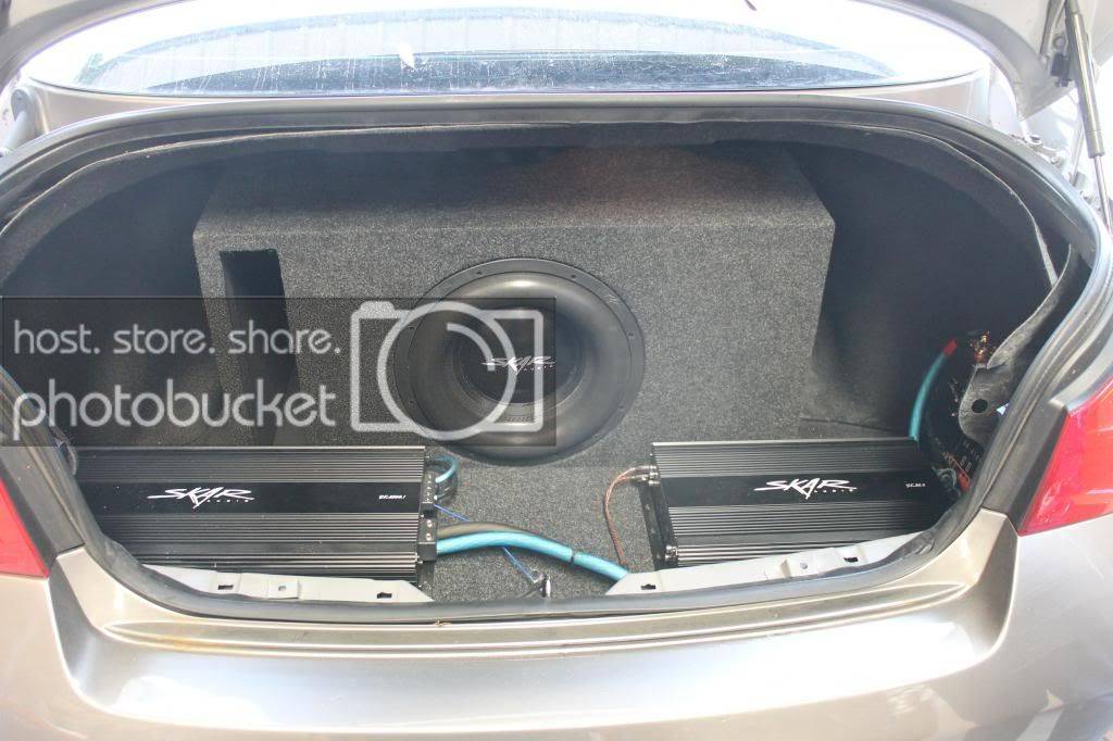

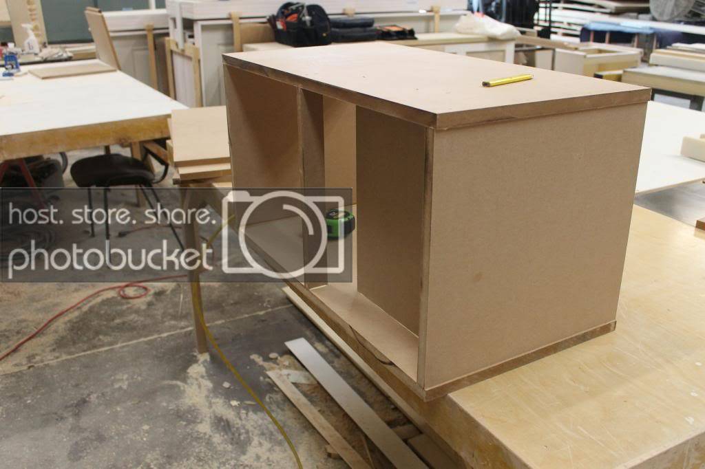

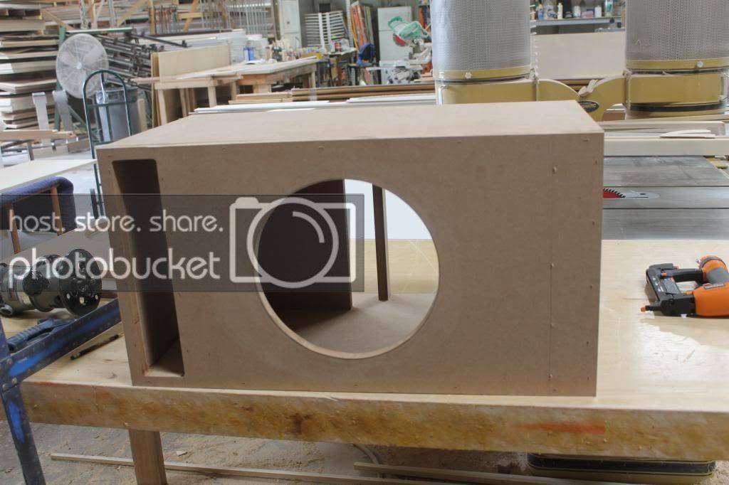

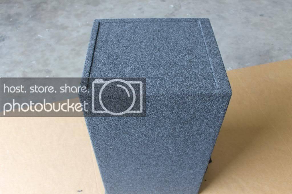

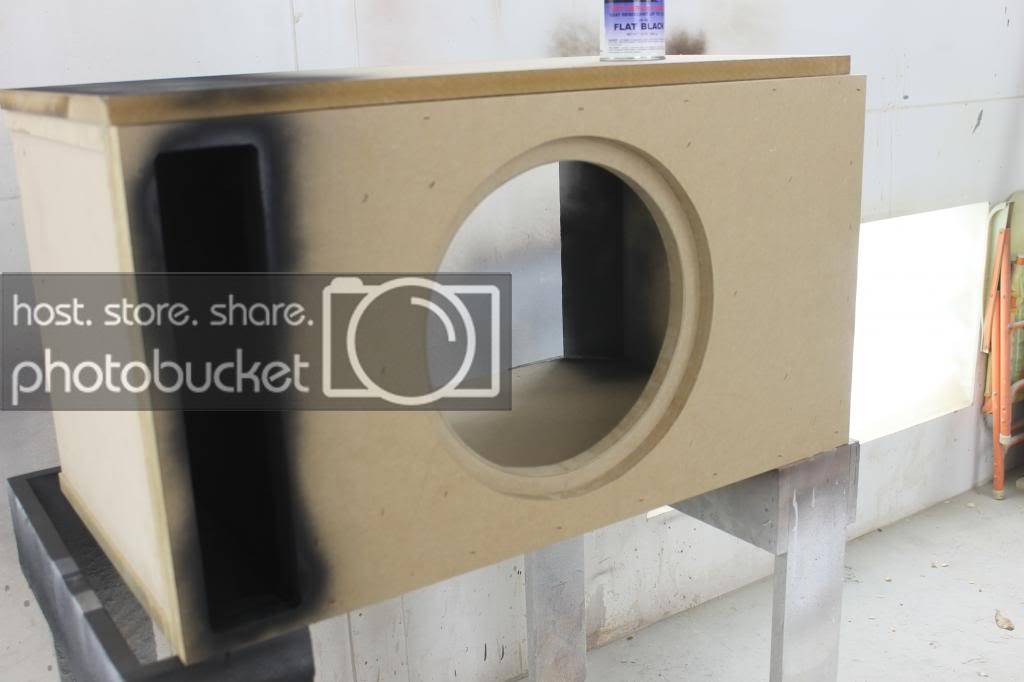

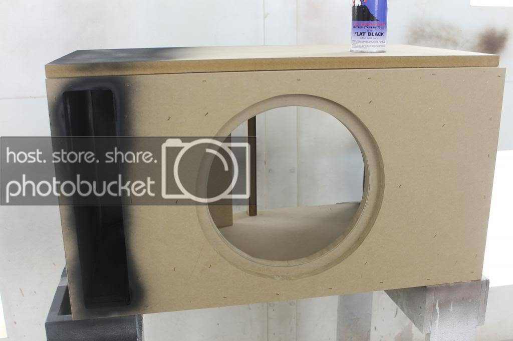

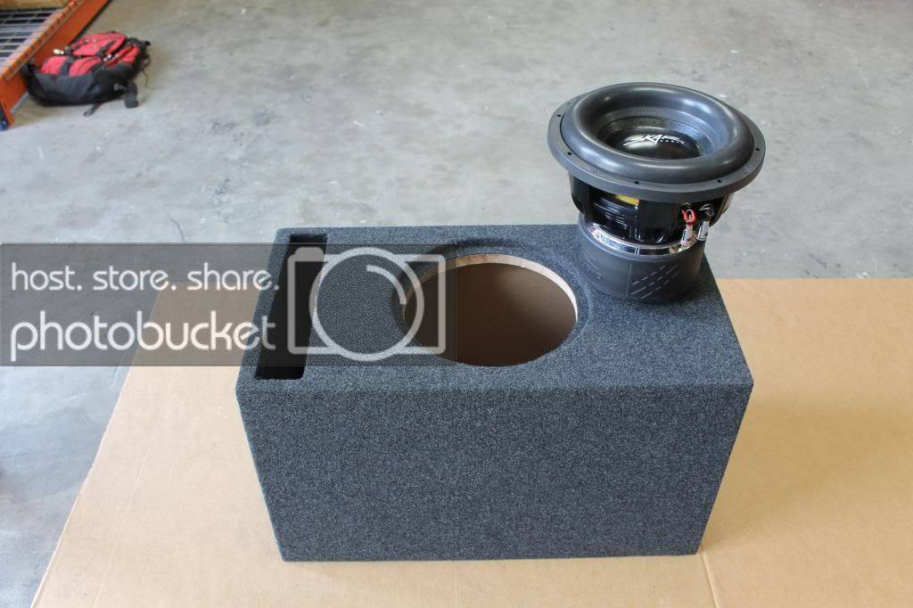

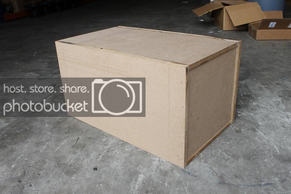

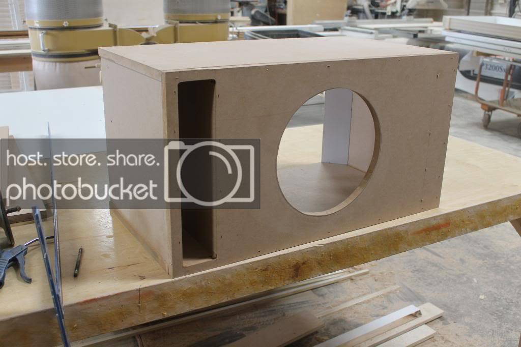

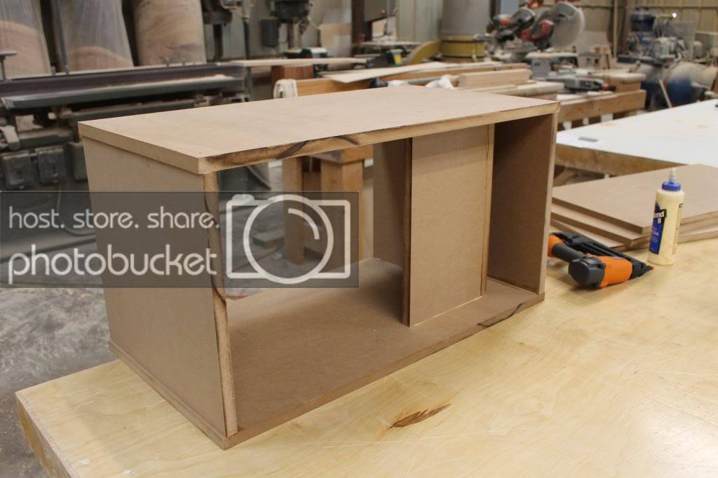

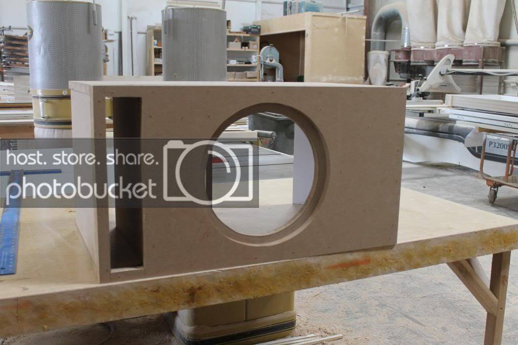

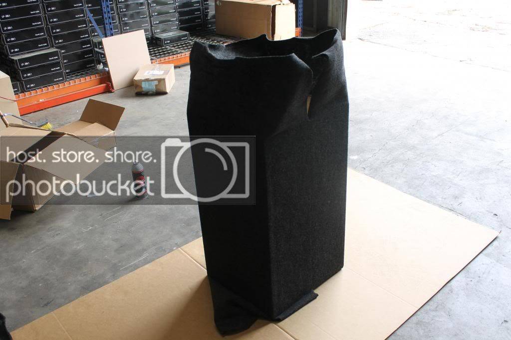

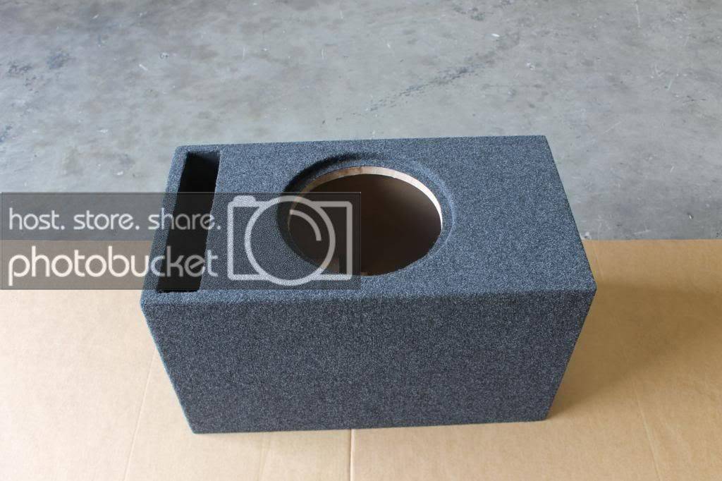

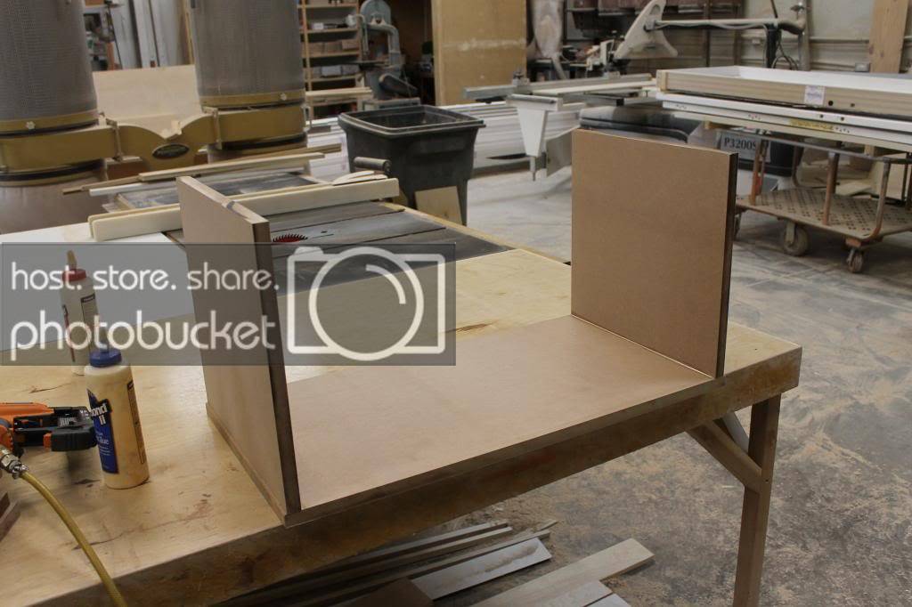

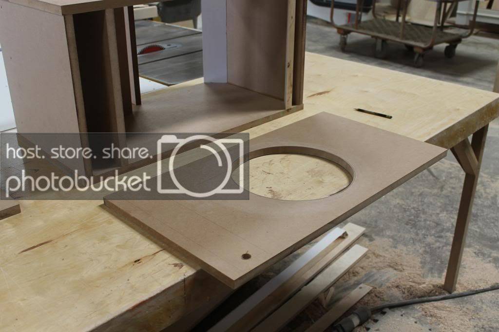

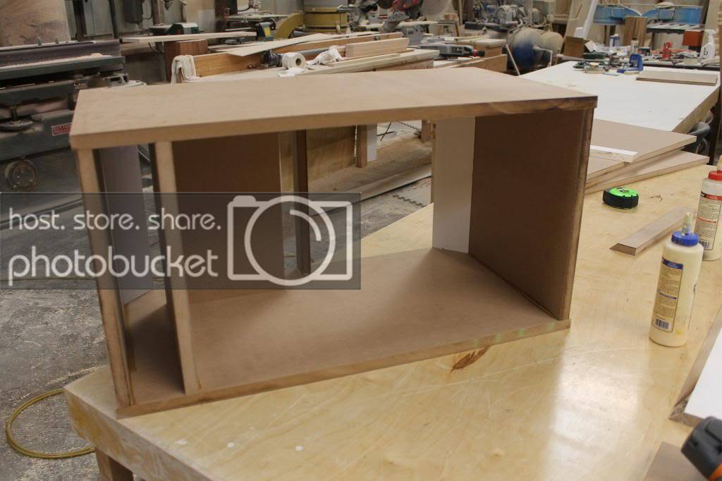

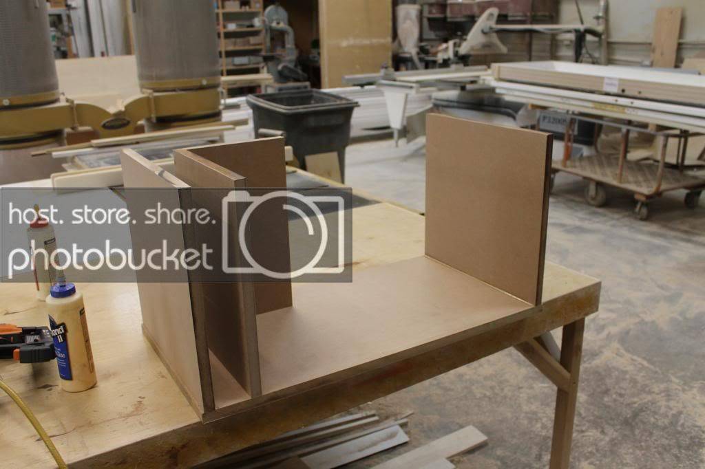

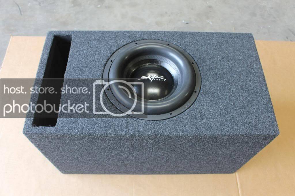

Today at the Skar Audio HQ we put in action the first production model ZVX-12 *V2* that we had sent via air before the main shipment arrives this April 5th (only a few short weeks away)... This build log below shows the start to finish process of an enclosure we built in house for this new 12" woofer and is followed by a live testing video.

Vehicle : 2007 Infiniti G37
Subwoofer : Skar Audio ZVX-12v2 Dual 1 Ohm 1500 Watt RMS 3" Coil
Enclosure : Single 12 Custom Ported Enclosure (3ft^3, Tuned @ 34 Hz)
Amplifier : Skar Audio SK-2500.1D Monoblock Class D
Build Log Pictures
