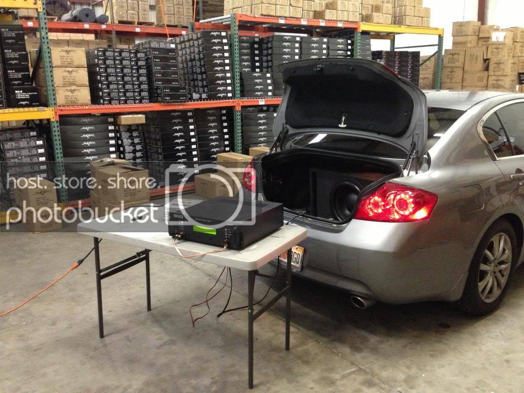

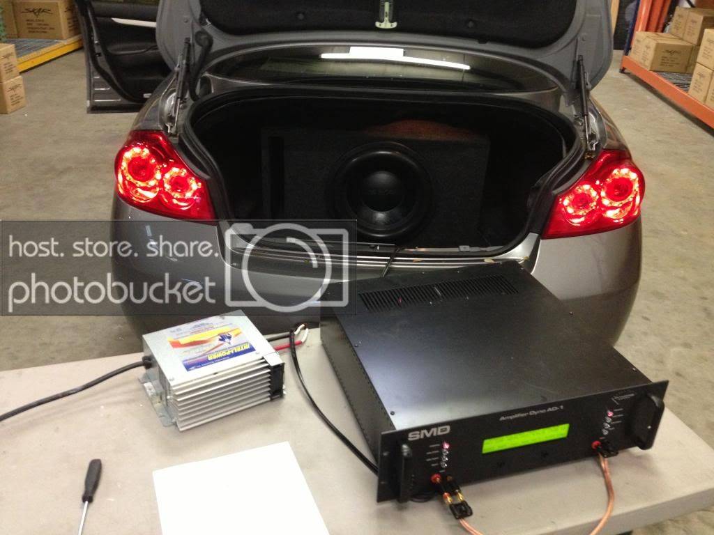

Testing was performed today during lunch break on the SK-3500.1D which is normally powering a ZVX-15 in the G37 pictured.

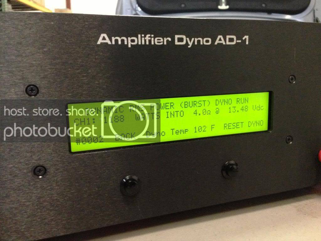

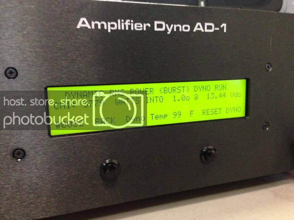

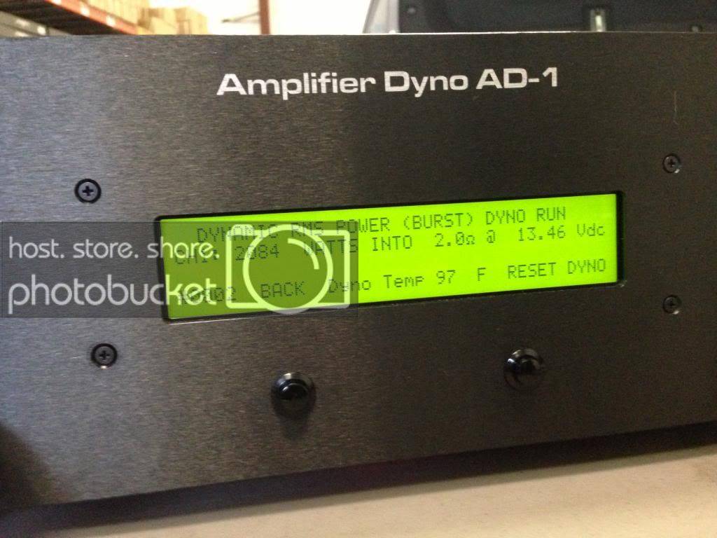

This SK-3500.1D was put to the test doing the Dynamic Power Run Test using our brand new SMD AD-1 Dyno today, you can see the results below.
Dynamic Power Run Test on this machine measures BURST Power Output up to clipping. It Stops measuring once it reaches clipping.
It is a fun test to run on the machine and the only one used in the pictures below - however once we get a new deck in the test bench later this week, we will post results of Certified and Un-Certified runs as well!
Dynamic Power Run Results
Power @ 1 Ohm : 3,779 Watts @ 13.44v
Power @ 2 Ohms : 2,084 Watts @ 13.46v
Power @ 4 Ohms : 1,188 Watts @ 13.48v
