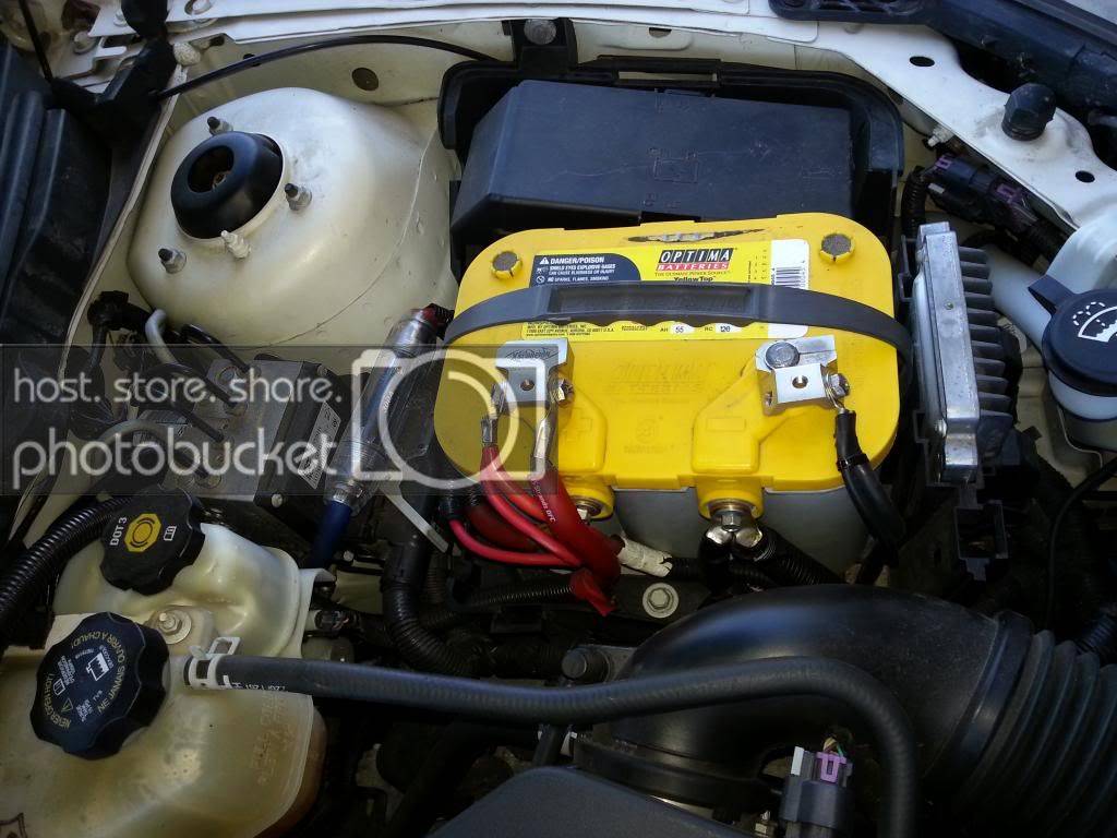

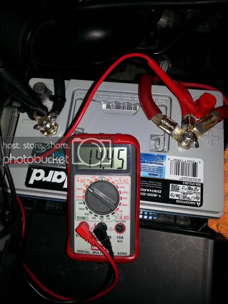

Soooo, after searching and searching. I found my answer!!! It's been done before.
Hope he doesn't mind me stealing his pics. lol
problem is I've never seen, nor tried to put a top post in my car, Pontiac G6... and I doubt there's gonna be enough room between the post and hood, if any at all.
You can lay an AGM on its side if you have the room to utilize the post..Have you looked into post adapters?I remember looking at those a couple years back.
Im running the terminals in the first pick..They work just fine for the last 5 years..Just need to at least check/ tighten about every 3-6 months..Use a socket rather than the Phillips head screwdriver for best tightened results
