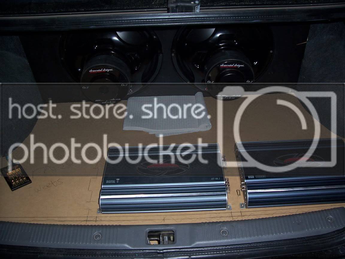

It isn't pretty, and I never got it sealed as much as I would have liked.
But it has served me pretty well.
I actually have re-done it since I took these pictures.
And the biggest thing I changed was removing the center seat belt.
It was such a pain when creating the first baffle.

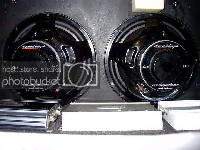

this is my current GTi, no doubt you have seen it before.

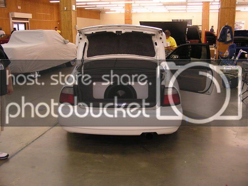

this is my friends install that i did for him with two aura NS15's - as you can see we relocated the amp at the end of the install.

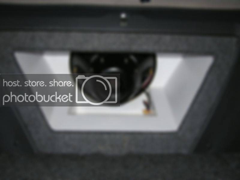

and this is my first IB in my 2000 saturn SL2. i never got around to finishing it because of weather and soon after it got nice out i joined the navy. so new car, new install //content.invisioncic.com/y282845/emoticons/smile.gif.1ebc41e1811405b213edfc4622c41e27.gif
