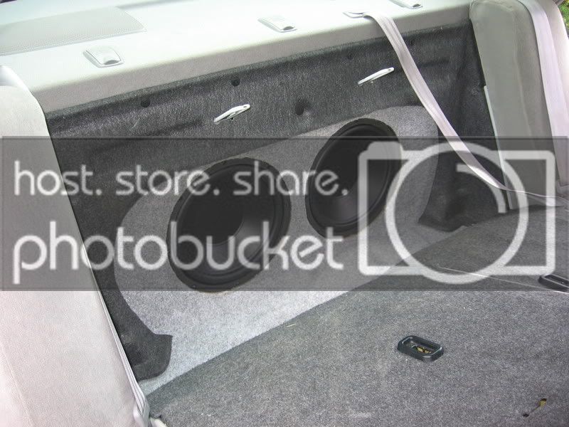

as far as a quick removal. your best bet would be to make a 'baffle' for your baffle. lol. it would be a 3" ring or so that fits in the seat fold area like in that honda civic or the saturn that i posted. and then you would make another panel that bolts to that using hurricane nuts and bolts, and a foam gasket between the two. the one ring would be almost permanent but the second ring would be removable.
that would be my idea of a removable baffle.
