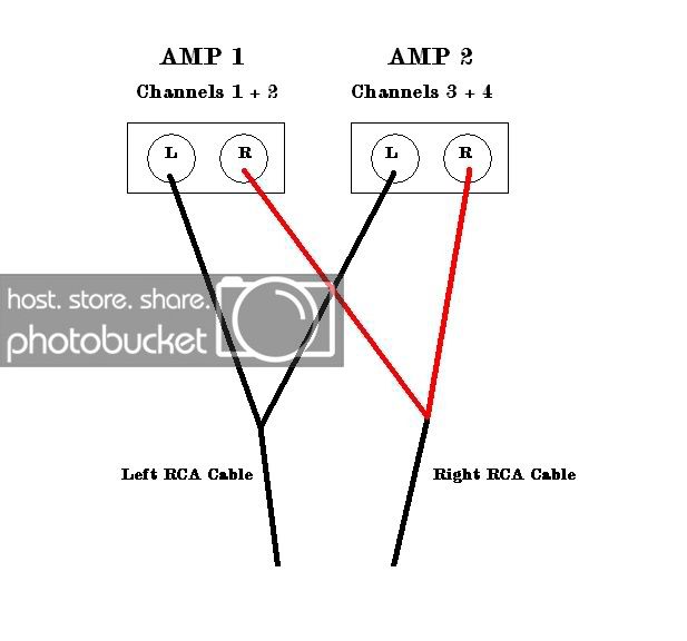

i split the RCAs coming from the front output as such, i took the left RCA cable, and using a Y adaptor, split the signal to the Amp 1 Left Input and the Amp 2 Left Input.
I split the Right RCA Cable (red one) using a Y adaptor and fed that signal to the Amp 1 Right Input and the Amp 2 Right Input.

on both sides, i bridged the L+ and the R- like it said. when i used y-splitters, i took the L signal, split it and put it to the 2 left signals. one right signal got split into the two right inputs. stereo?

that will be stereo..

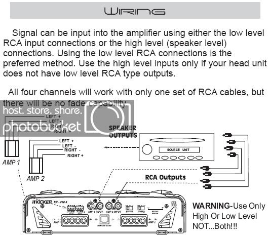

in light of ur response (appreciate it bro), i reviewed the owners manual again.
you were 100% correct, just gotta figure out which inputs to use. when i brought the question of whether i need to run RCAs from the Rear HU output to fill up the amp inputs, i wish u had been around then, lol.
whatever, at least i have a gameplan now, i didnt wanna risk shorting anything out by just trying an array of multiple diff possibilites.
check this out from the manual, bc i still cant tell which inputs its telling me to use when using just one. i gotta actually see the amp, and its 3:20 in the morning, and i park my car in an outdoor parking lot.
also, listed in the features is this:
"SAMS (Stereo And Mono Simultaneously) Amplifier will
operate into a bridged mono load and a stereo load at the same
time."

reviewing the manual even FURTHER, i apologize for wasting everyone's time if u read this thread. it appears that when bridged, the amp is not capable of producing stereo sound. this is in contrast to the 2006 ZX (i have the KX). here are the power specs, if i'm not mistaken, and i really hope im not this time, its to be expected that they are mono.

No amp, when operating in bridged mode, is capable of producing stereo output. This is why that particular mode is commonly dubbed "mono bridged."
You're combining the outputs of two separate channels into one single output. By definition, with 'stereo' meaning separate left and right audio signals, it simply isn't possible to get it out of one lone channel's output.
When you bridge 2 channels you have 2 inputs but only one output. With the RCAs setup the way you have them now the amp is combining the left and right signal for the output. Using your diagram and assuming channels 1&2 are the left speaker, run both of the left RCAs to the inputs on channels 1&2. Then run both of the right RCAs to the inputs on channels 3&4.
