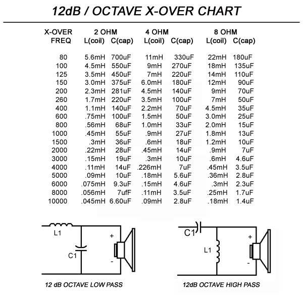

these are 12dB/oct slope which is better than a typical "bass blocker" which is a 6dB/oct slope.
these are plenty efficient. run them in stereo and maintain a stereo image.
you could wire them in parallel and bridge the amp but there is no good reason to do so and you're just making things worse. your balance and fader should always work properly. if not, you're doing it wrong and just listening to noise.
the reason bass blockers or passive crossovers need to be made to the speaker's impedance is because that affects the crossover point.
for a simple 6dB/oct crossover:
a 4 ohm crossover would behave 2x as high if wired to a 8 ohm tweeter (crossover frequency is doubled when speaker impedance is doubled)
the real danger comes when using an 8 ohm crossover on a 4 ohm tweeter because the crossover frequency is halved.
with higher-order crossovers the effect is worse because values move in opposite directions

both methods work fine. you don't need to use the crossovers on the amp but without them, the amp will produce full range and try to amplify low frequencies. The passive crossovers just provide a higher impedance to frequencies below the crossover point, but amplifier power is still wasted. the crossover circuit doesn't consume power but it will affect phase on the output.
