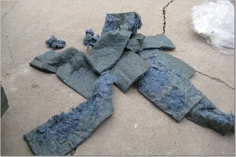

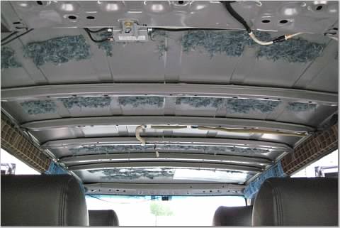

Next you will need to remove the "factory deadner" which is just a wool type material. This is it removed!

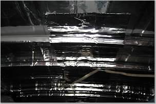

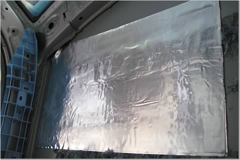

Then its time to map out and install. I chose to start in the center and work my way back then do the 2 sides.
Here is a pick from the back with most of the roof dampning installed.

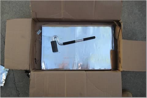

The picture above shows some of the work in progress as well. I cleaned off as much of the factory glue and wool as I could and then just layed over top of it. I used a roller to push the air out of the damplifier. The roller can be purchased from Second skin as well.

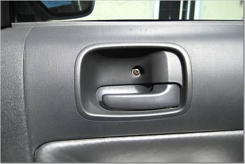

Next we did the doors. Again, its a Scion so not very difficult to remove the door panel. For the front doors, you remove the triangle peice first.
Then the phillips screw in the pull handle.
http://im1.shutterfly.com/procserv/47b8da35b3127ccea80d8102a63500000016100AZtGrhs0ZtWKA
Then the other phillips in the opener handle.
Then just pull gently around the door till the body clips pop lose and then gently lift away. You can now reach the back of the door and unplug the wire harness to the switches.

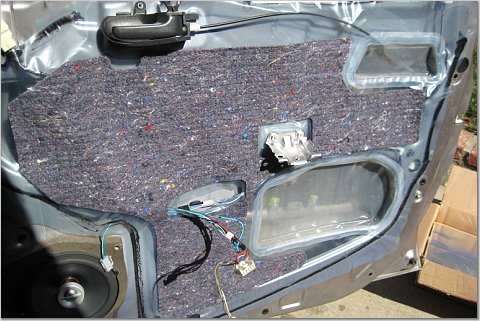

Here is a few more pics.

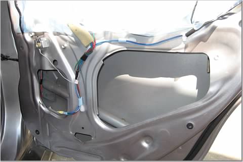

A view inside your door and the obvious absense of any sound deadning material.
I then took and cut down the sheets to half there size and put them into the doors. This again, thanks to the second skin product was easy to do. I will post pics of the doors finished later.

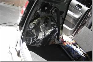

Then I did the rear hatch. Again I will post pics of the rear hatch finished a bit later.

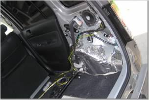

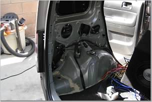

I then decided to remove the rear seat, spare tire, cubby and plastics and tackle the rear quarter panels. This is an area that really needs attention if you have a sub enclosure.
