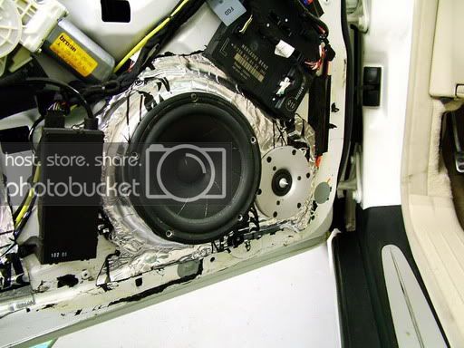

I would go for #1. I dont know much on T/S parameters, but Id bet .3 net with fill would sound very nice.
Sorry I should have stated that to begin with:
Seas Excel W18E001
Scanspeak D2904/60001 -- will go in the stock A pillar mouting location aimed sort of central to car (adjusted of course to what sounds best)
My arbitrary guess of a crossover point will be around 2kHz
worked well in door so your application should be excellent
