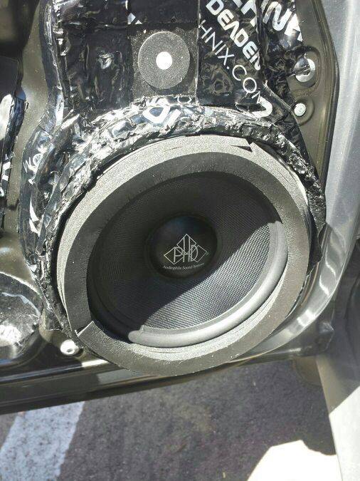

As far as the review, I believe that one was @av83 ; though I do run the FB mids in my car and am extremely happy with their performance. Ignore the hack job with the deadener as I went overboard, but here's how I currently have treated my FB mids:
Seems to be the winning combination to getting the most out of those mids. That sponge rubber weatherstripping around the front ran me 8 bucks for two 10ft rolls at a local hardware store. Should take 2-3 layers to mate to your door card when complete.

As far as the review, I believe that one was @av83, though I do run the FB mids in my car and am extremely happy with their performance. Ignore the hack job with the deadener as I went overboard, but here's how I currently have treated my FB mids:
Seems to be the winning combination to getting the most out of those mids. That sponge rubber weatherstripping around the front ran me 8 bucks for two 10ft rolls at a local hardware store. Should take 2-3 layers to mate to your door card when complete.[/QUOTE]
