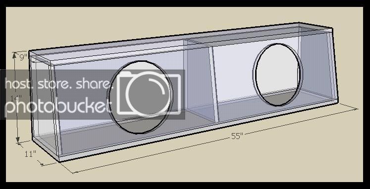

Roughly about 1.6ft^3 in each chamber after subwoofer displacement. Sealed. Total Volume = 3.52ft^3.
Housing two 12" Fi Q DVC 1 - .16ft^3 Subwoofer Displacement.
Whatcha guys think? Its going behind the seat.
I guess not much of a difference in sound. But the bracing would add support throughout the enclosure and would take up just as much space as a divider.
