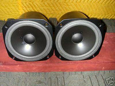

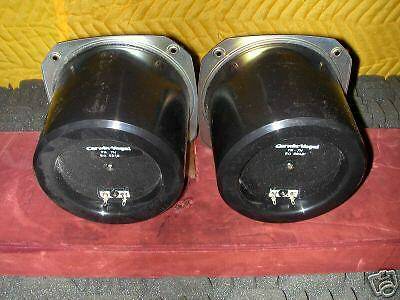

Cybe, what are the specs and shoot me some pics, if you would.
They're 8 ohms, and I wouldn't feed them more than like 60-70 wrms.
