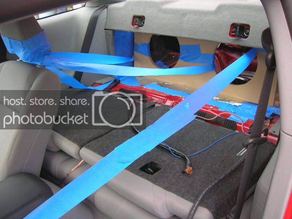

let me start off by saying that this should be a fairly quick build as my completion date is BY APRIL 7th! im glassing two SE 10's prolly ported, will have to see how much room i think i will end up with. looks to be ~3 cubes. on to the pics

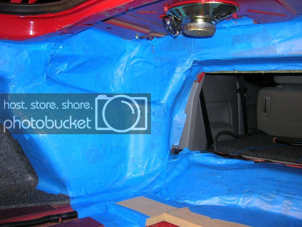

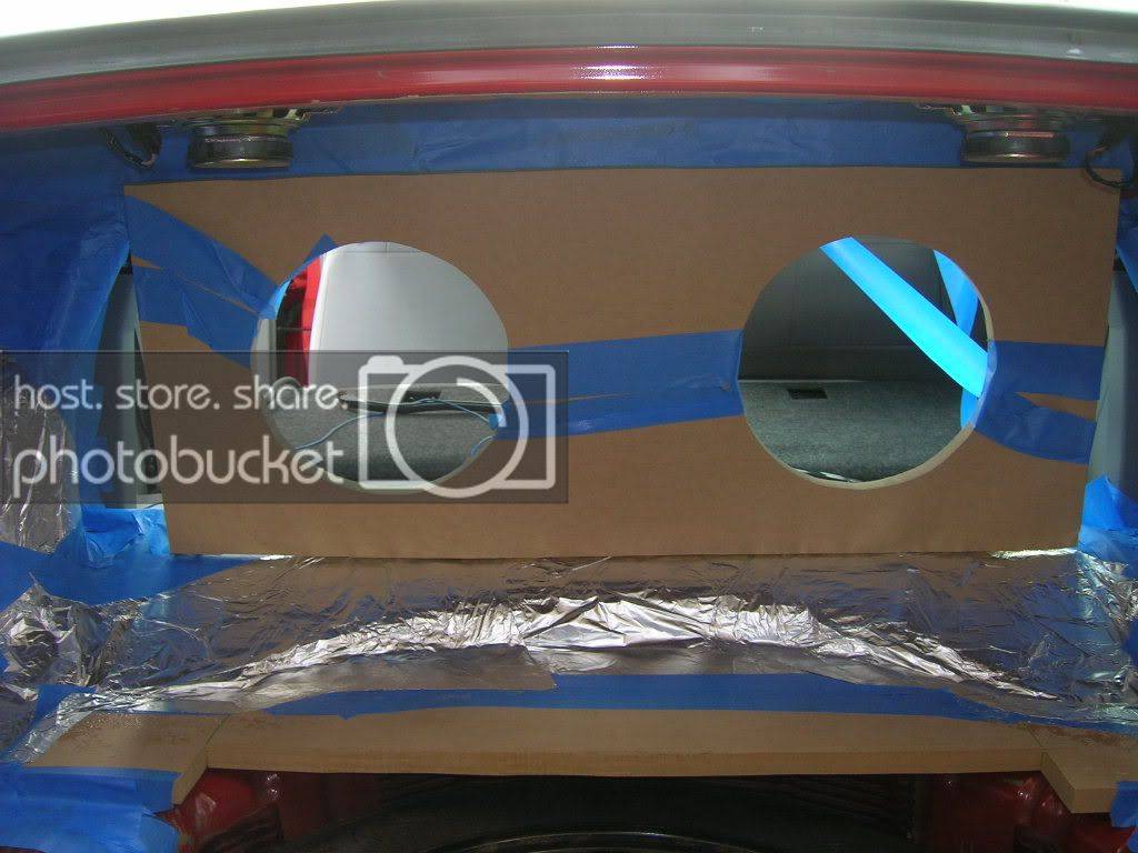

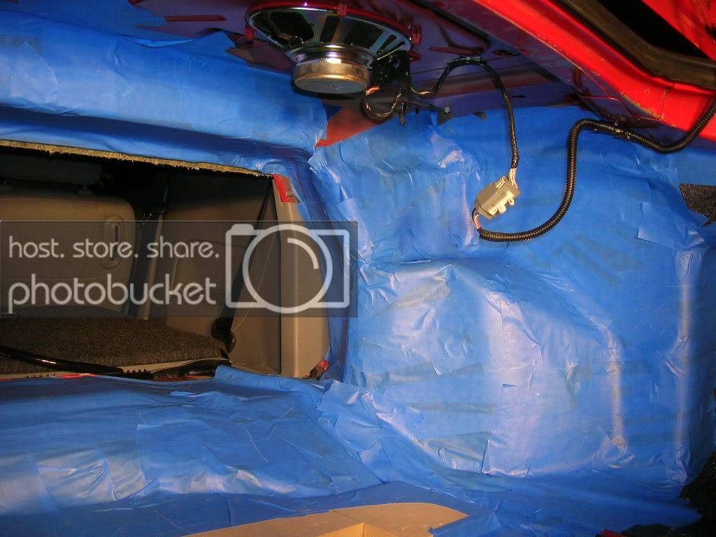

this is it for now, glassing begins asap in the morning. the tape looks as though some ends are loose, but i promise you that their is tape under those loose ends, the glass will push them down as well.

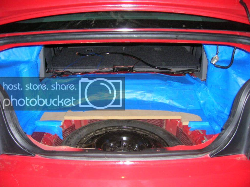

pictures will be up tomorrow. i have to foil over the tape and spray it down with tire shine as a mold release and then pics will flow all day pretty steadily im hoping. just crank my music and get working!
2005 mustang, i will post a few pics in a minute. my camera died.....so ill try to find some batteries before i finish haha.
the plan switched up a little bit, its not gunna be as huge as i thought it would be, as i want it removeable. its gunna end up sealed, and mostly mdf, but not all.
