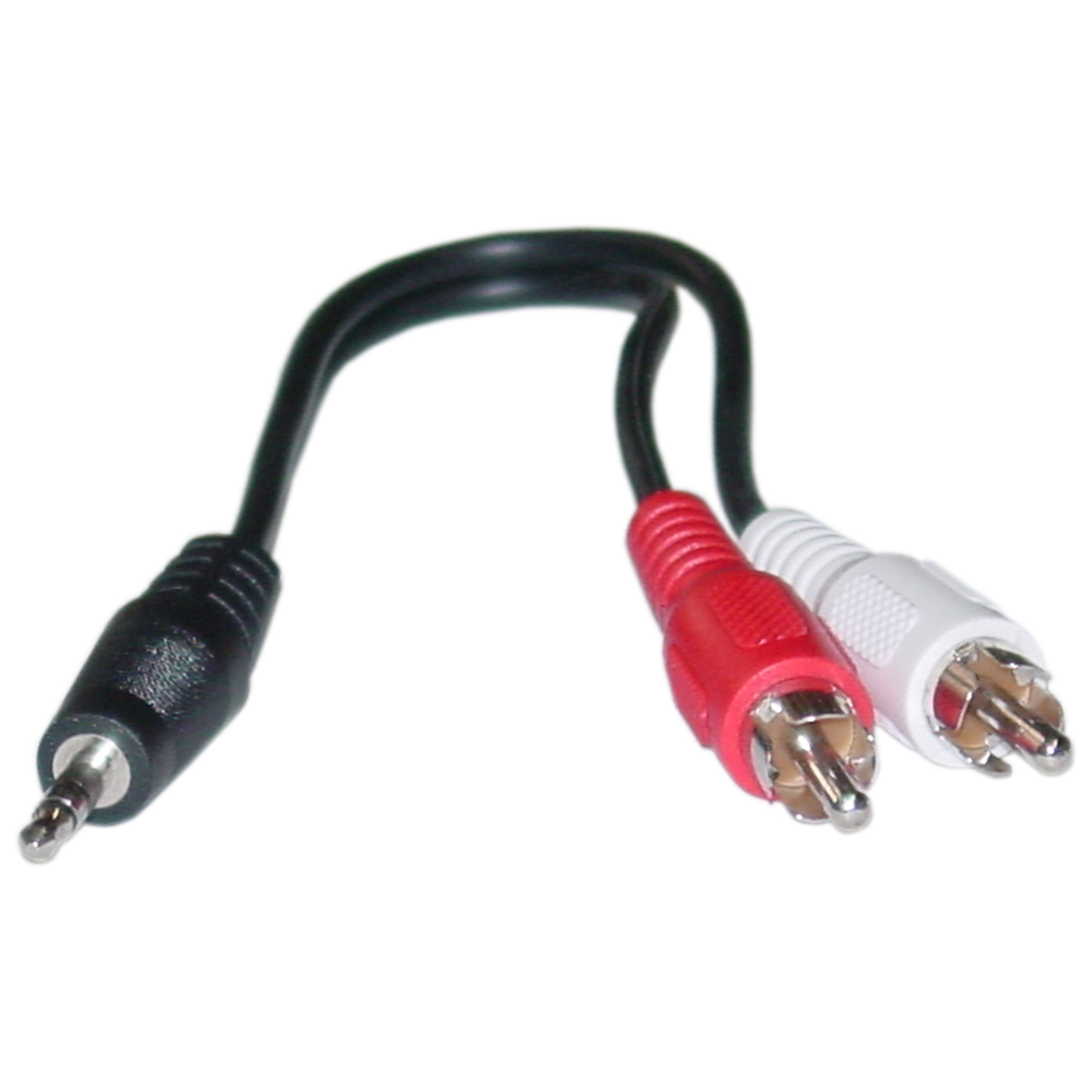

As far as getting the signal to the amp, I used one of these. So you would plug that into where the green one goes.
Newegg.com - Rosewill - 3.5mm Stereo Splitter cable (6 INCHES)
Which then plugged into one of these.
