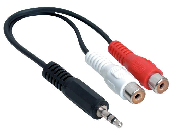

As far as the line in would this work?
If I have a sound card that had a subwoofer output 3.5mm jack, can I run one of these.
Then that just goes to the input on the amp?
