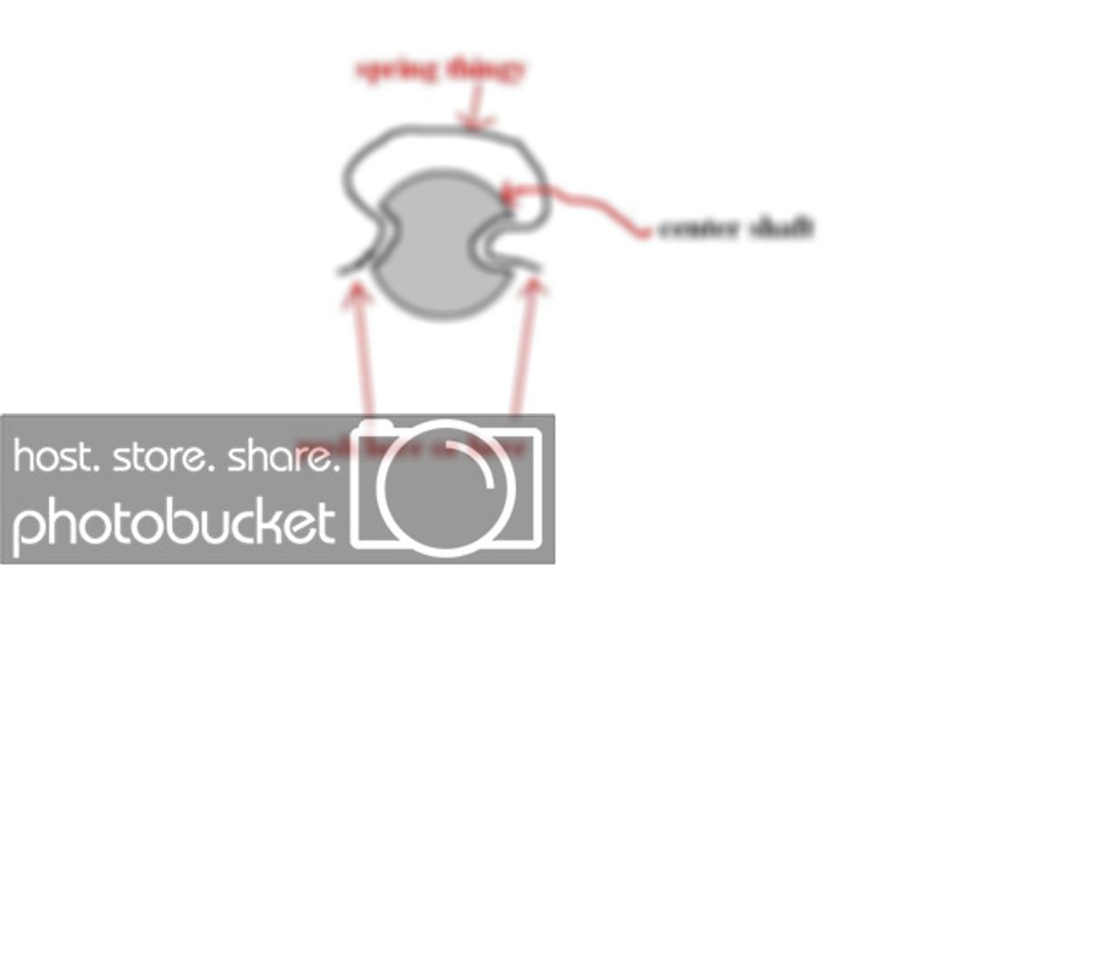

the window crank handle?
there is an "ohm" " Ω " shaped piece that holds it on. i just use a small screw driver and push it out. its pretty hard to get to it. or you can go to Autozone and borrow the actual tool that is used to do it. if you use a screw driver get ready for that bastard to go flying. ive lost them before
