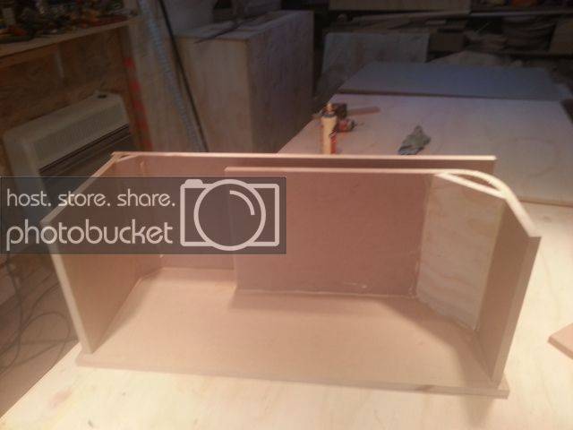

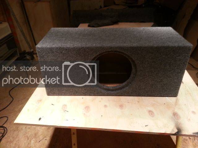

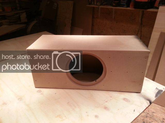

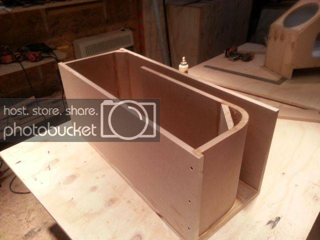

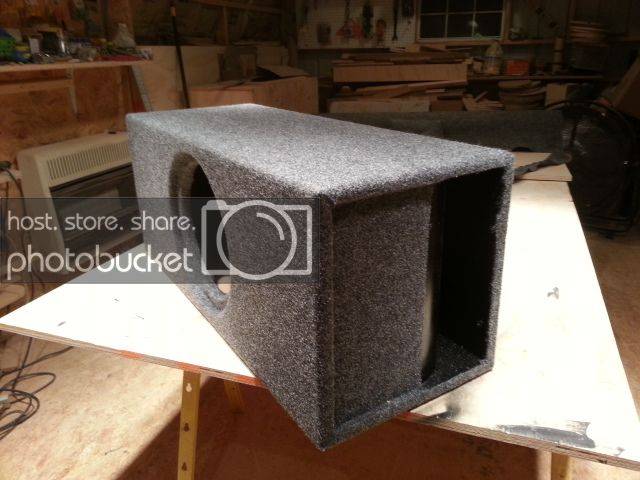

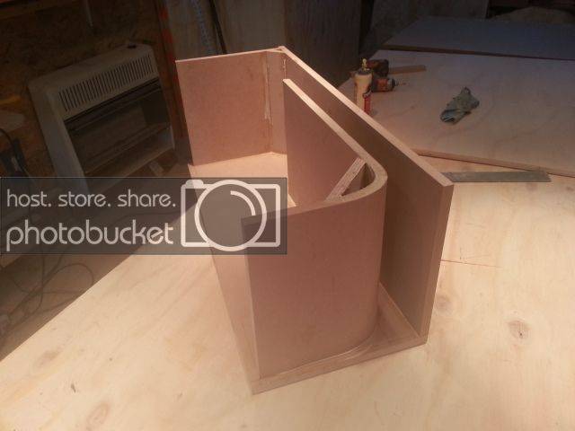

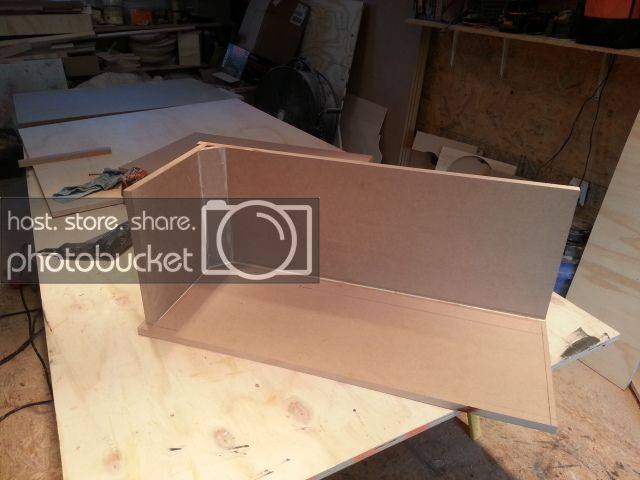

Single T1 12" in 2.25cf net @ 34hz......sub back with kerf port to the side.....flush mounted sub...

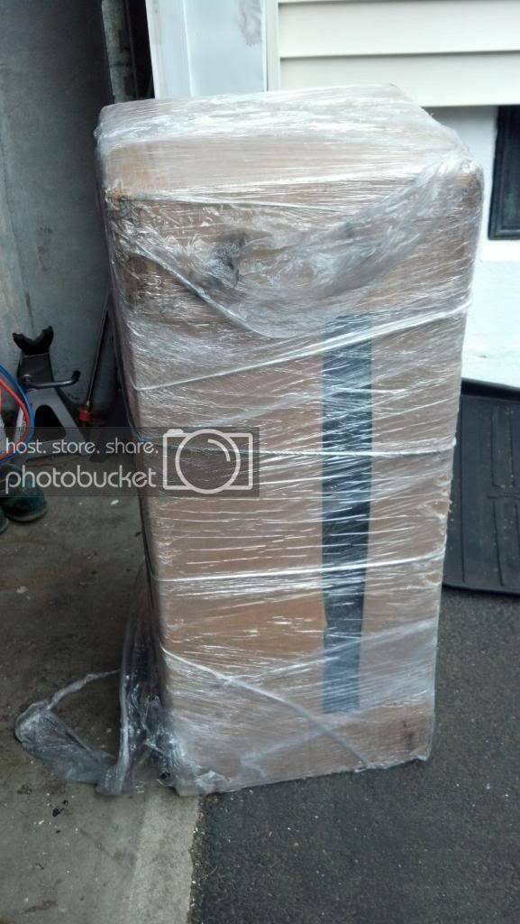

received my box early am. these delivery companies are very weird lately. amazon prime delivered a package in an unmarked blue van. now fedex delivered from a penske moving truck.
Packing was amazing!

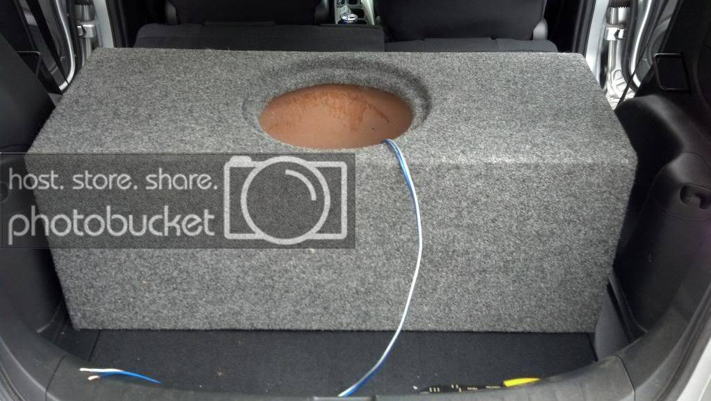

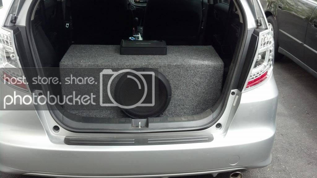

Old box removed and new one in. Lots of room all around still.
Had to cut out some carpet from inside the speaker cutout. It was a tight fit. but it fit nonetheless. Pounds much harder now! Now i need to do some deadening.
Thanks double07! Quality work like everyone says! Would recommend you to anyone needing a box!
