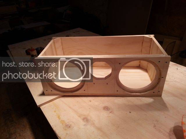

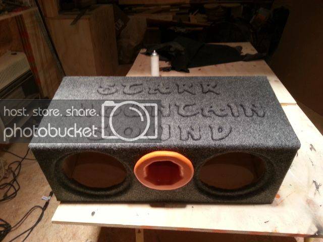

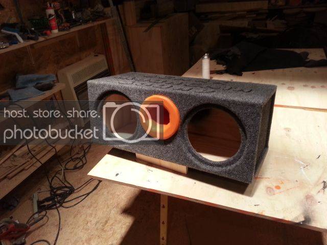

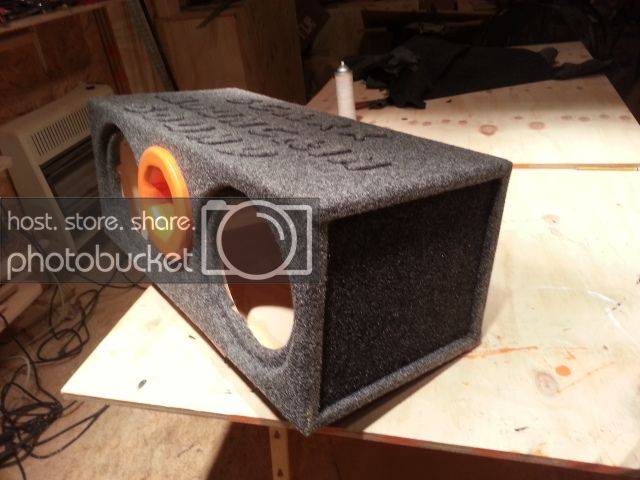

Pair of level 3 10s....Arauco...flush mounted....octo....2.1 cf net @ 34hz
Dead sexy! Are you able to flush those ports?
Yep octos can be flush mounted and I almost done that with this one but I didn't want to use all my tricks on 1 box....LMAO
What are the dims? Might want something like that for the se's. Yeah, I know I said no more box.
My card is out in the shop on it.....But I believe it is 33"w x 13"h x 15"d......
