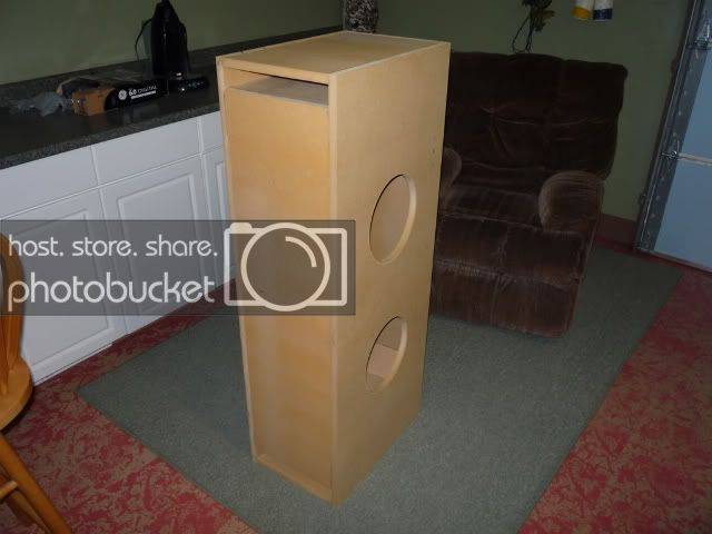

RyanM923's 10" OG Assassins 4ft^3 at 28hz build
Looks good, do you live in denton?
Yep, but all of my box building goes on in Rockwall since all of my tools are at my parent's house...apartments FTL when building boxes.

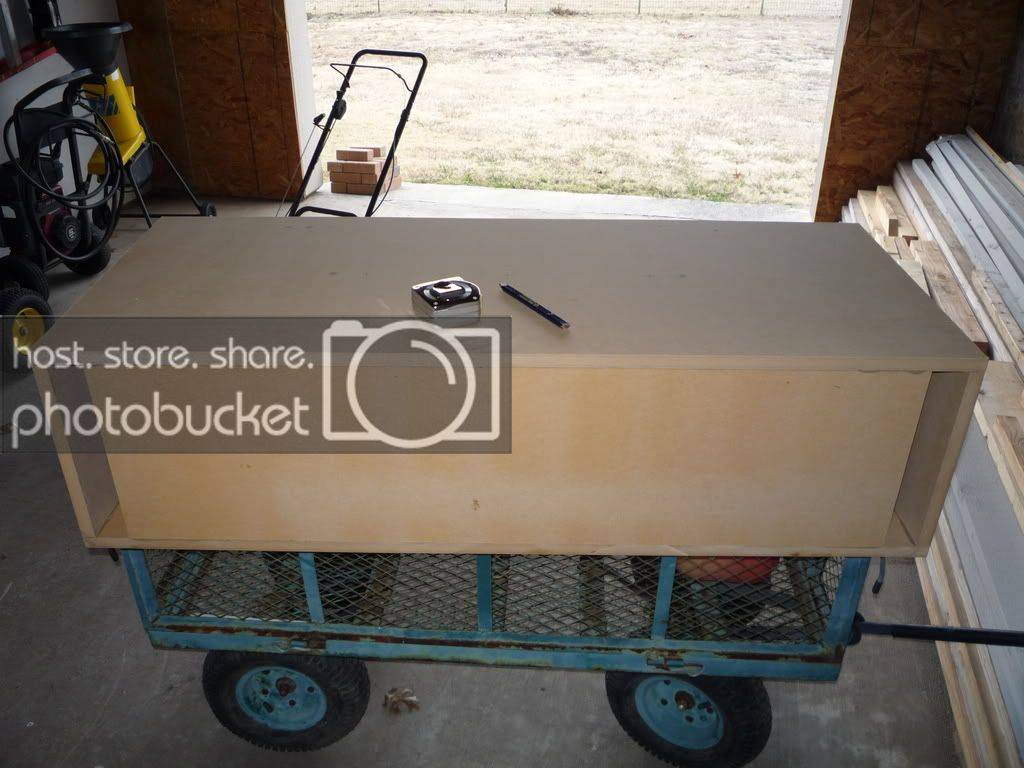

never seen a box built without screws, brads, or clamps...
I'm using a brad nailer, which is that the hose is leading to in the second pic.

Thanks. Well, after having a massive amount of leftovers, I finally got the top on...but no pics until I have the holes cut tomorrow. I still haven't decided if I'm going to roundover the whole thing or not. It's just a temp box for a couple of months, but since I'll already have the router out for the holes I might as well roundover the edges...

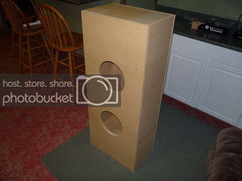

But I did get the top on this morning.
