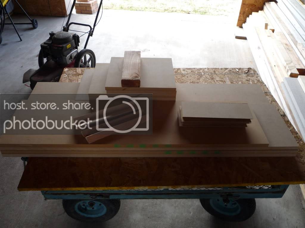

everything's cut.

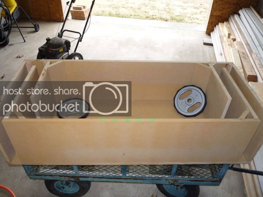

laying the first port pieces down.

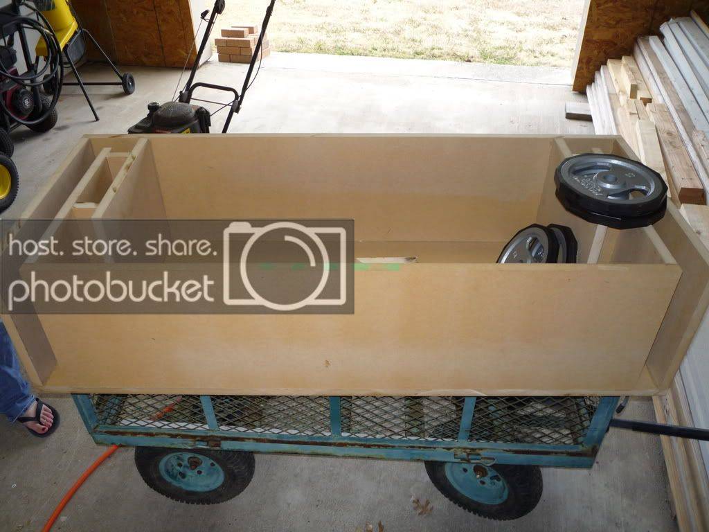

Getting the rest of the port secured.

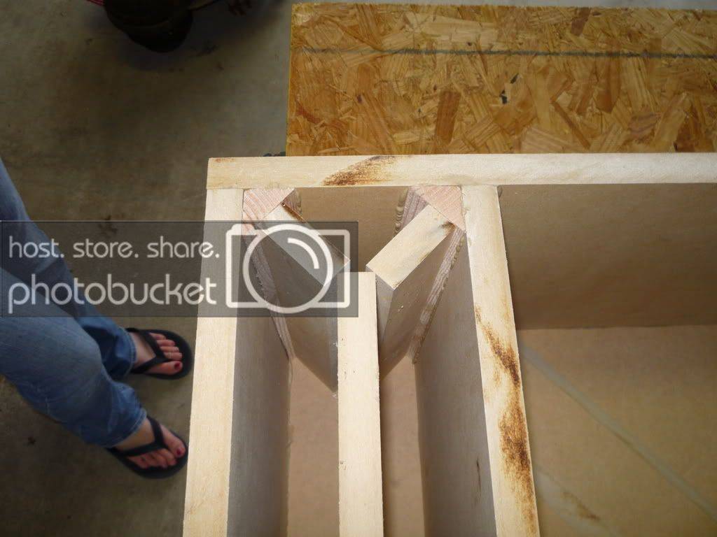

pain in the *** 45's...my table saw did not like cutting these at all, and because of that I have some gaps to fill in on the sides.

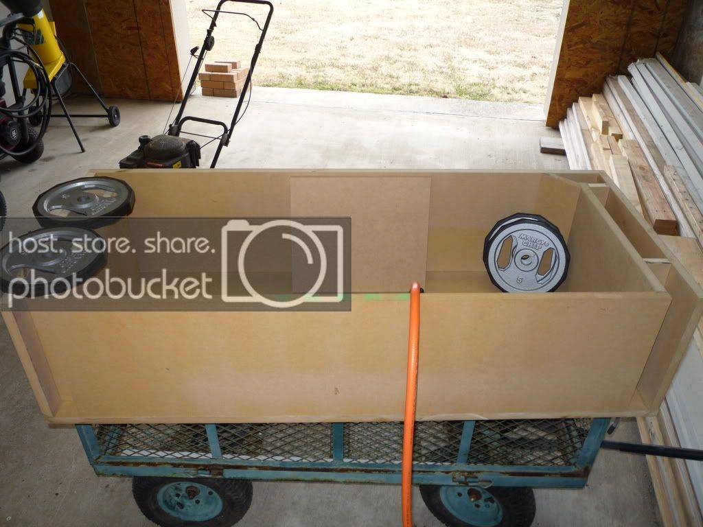

The rest of the 45's being put in. I'll be doing the top of the box later on tonight, and routering the holes tomorrow morning.
The box should sound pretty good. I'm anxious to see if I have enough power or not with the 4 channel.
