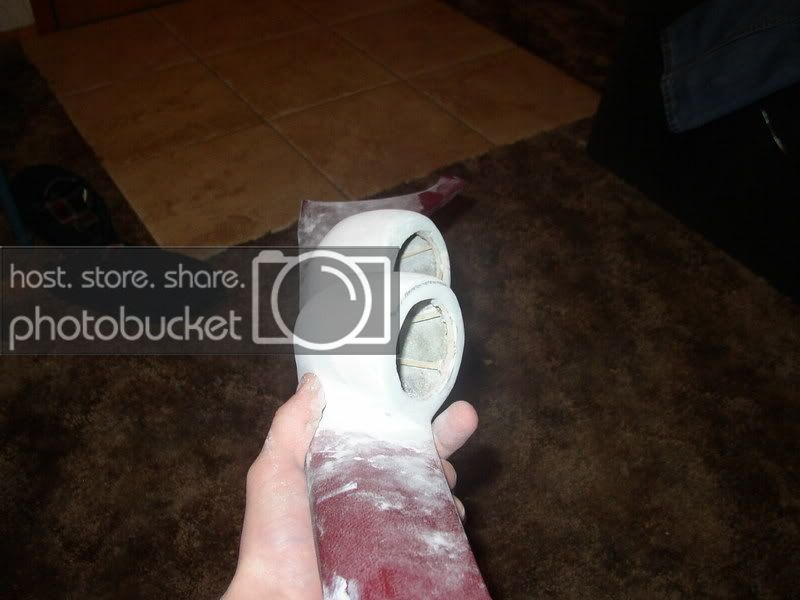

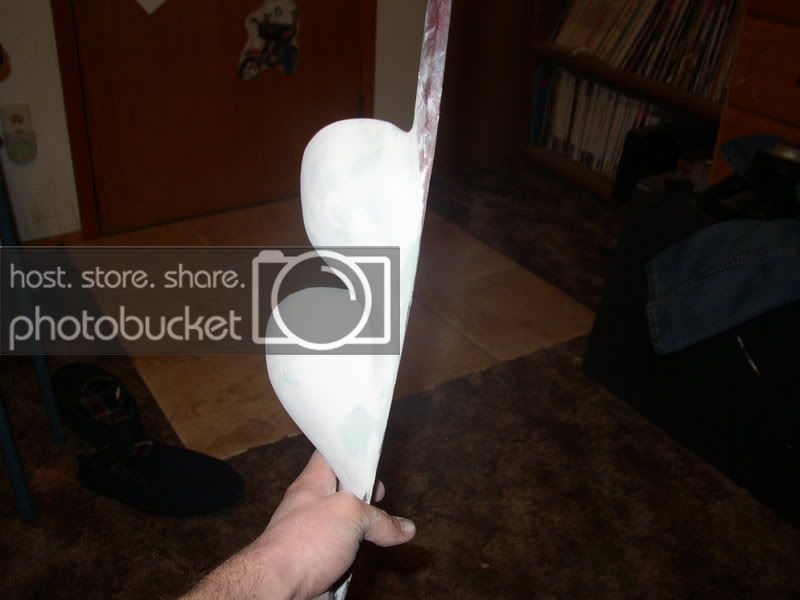

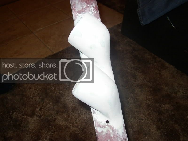

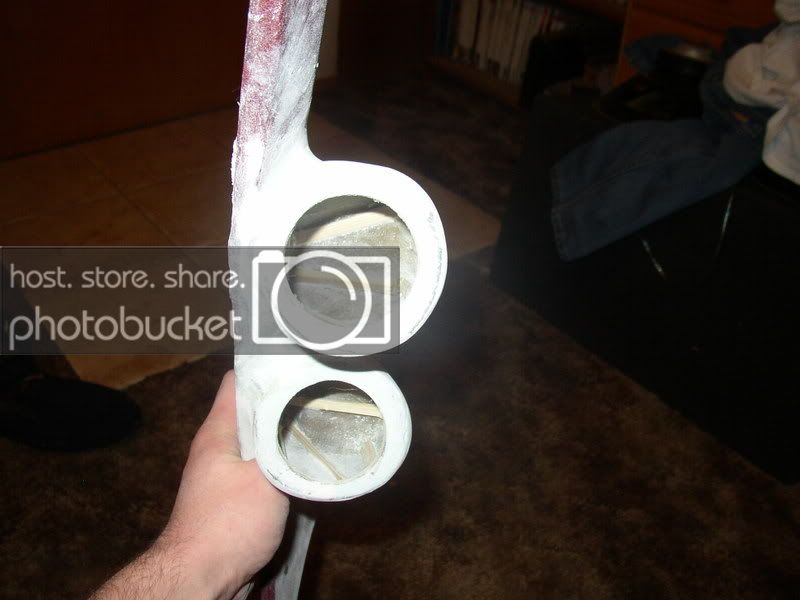

even though its not car audio i thought it was worthy of putting up. these are pods for gauges in my truck...
ya, it was kinda hard the way i did it with the sticks. i would recomend using a piece of pvc pipe, that would make it way easier cause it is already round.
i piddled around with the skeleton part for like 2 hours to get them right. the fiberglass to like an hour, half an hour each day cause its cold and doesnt harden very well.
and i used cloth on the first coat, then matt to fill in the wrinkles where the cloth kinda fell through the sticks.
Next time try using fleece or spandex for the first layer this will give you the nice curves that make it look organic.Then you won't have holes were the FG can fall through.And on smaller projects like this you can just use kitty hair or enough bondo to make it soild.
ya, is that the stuff i see every one use on boxes? the stuff that looks like a sheet? but dont they staple it tight? how would i use it on plastic?
looks good and same concept as a speaker pod. always good to get ur glassing skills up its a handy skill to have
and for sticking it to plastic use high temp hot glue or CA glue. both have worked well for me and not pulled apart as the resin was curing, just make sure the plastic is cleaned of an oils and roughed up first with course sandpaper
