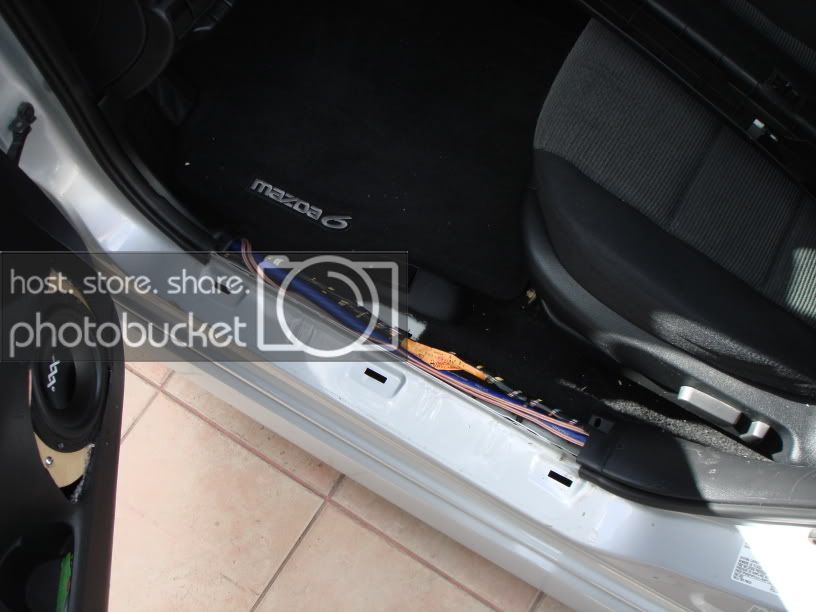

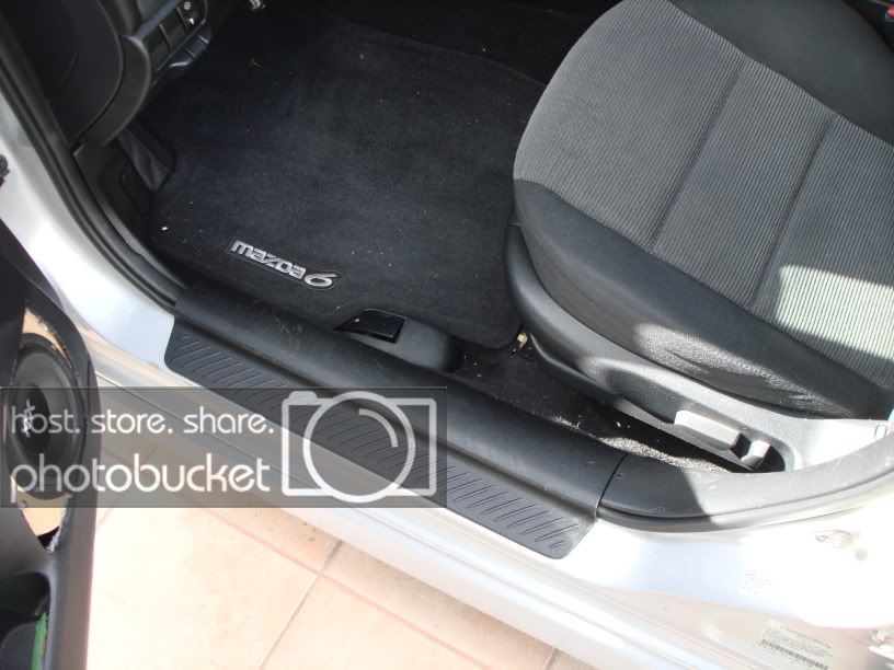

Haha I love that build log, but I think he's referring to what I mean by door sills. I'm uploading pics now. Just realized my trunk latch is busted again though //content.invisioncic.com/y282845/emoticons/frown.gif.a3531fa0534503350665a1e957861287.gif.
As you can see the first pic has the door sill on, hiding the wires completely //content.invisioncic.com/y282845/emoticons/biggrin.gif.d71a5d36fcbab170f2364c9f2e3946cb.gif.
That's a run of 0 gauge Kicker Hyperflex and 4 16gauge speaker wires.

i dont think itll work in mine. theres no space to put the wires there. so it looks like ill have to take out the carpet.
Aw that sucks.. You sure there's no space? Mine doesn't really look like there is space, but they manage to fit there. Try dropping something there and putting the panels back on and see if they close, put like a marker or something about the size of 4 or 0 gauge. If not, then yeah, under the carpet you go! //content.invisioncic.com/y282845/emoticons/tongue.gif.6130eb82179565f6db8d26d6001dcd24.gif
well the palstic thing that is for where you step only covers half of teh space of the door. so if some fit, alot would still show. ill see if i can work someting out.
