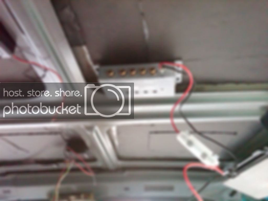

eCrack the clearance up there is pretty tight, but there is a little bit of wiggle room in between the rails, for example the thickness of this video amplifier is about as thick as I could go without having it pop its outline through the headliner:
But the wiring harness idea seems really great, that's probably what I'll end up doing, thanks!
