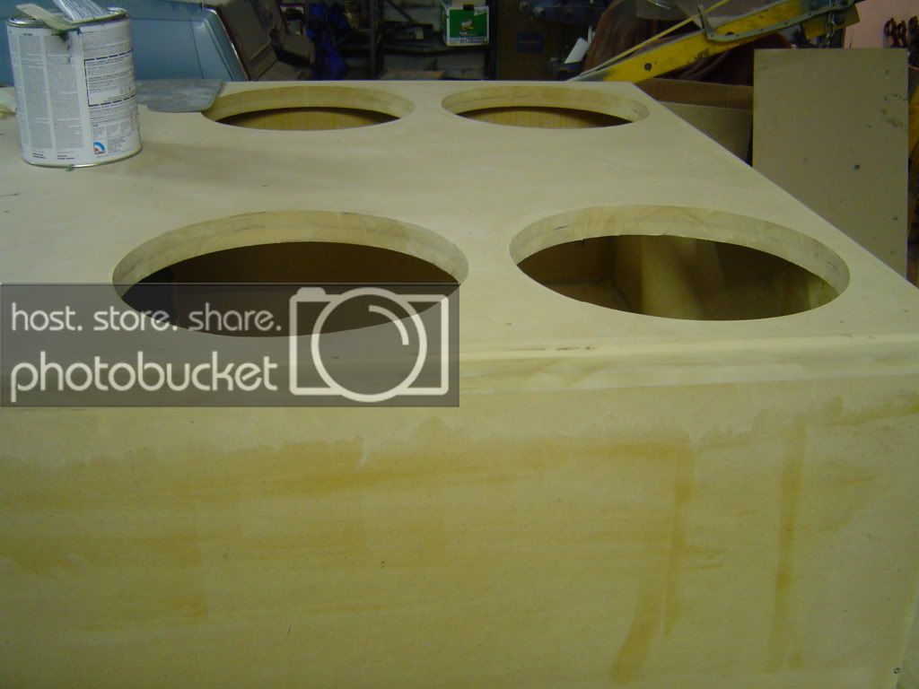

rounding edges w/o router
its best to just invest in a router. It such a multi purpose tool theres no reason not to have one.. //content.invisioncic.com/y282845/emoticons/wink.gif.608e3ea05f1a9f98611af0861652f8fb.gif
but otherwise, if u have a sander, thats ur best bet but it wont get as deep as a roundover bit
Break the edges with 40 grit on a grinding wheel and use a hand block to round the edges with 40 grit again. It takes a little more work than running a round over bit but the result is a bit nicer.
Shit I thought he really wanted to round the edges if you are just trying to accomplish that then 40 grit and a palm sander will work wounders.
