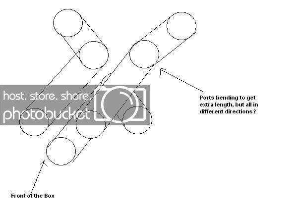

I am looking to use (3) 4" round flare ports for my two Mach 5 Audio 12.2 IXLs. First of all would (2) 4" flares be enough or would (3) be more effective. Next question is if i do use three of them the port length for each will exceed my depth of box, so i would have to curve them. Does direction the curve is matter? I have a picture that may help what im trying to ask. Any input would be great thanks!
you will have to wait for a responce from somone more "in tune" with round ports but from what i know having them going in all different direction is not a good idea
your better off changing port size and or number so they can all be the same length and straight

more port area the better generally, to a certain point though. with ports, you want them to be at-least a ports diameter away from anything. port direction doest matter, but try to have the ports face away from the woofers as much as possible. 90* from the woofer would be the worst for port noise.
