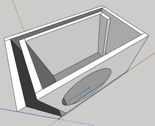

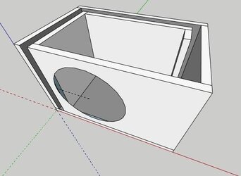

After an incredible journey of research, videos, reading, talking, searching...all the things, I have my enclosure designed.  Huge shout out to fithwheel for help in this, among may others on this board.  Here is my design for a Dayton 10" HO dual voice coil driver with an NVX 760W amp.  Box size is .86 net before bracing and 'should' be tuned to 30.5 hz according to the Torres Tuning Calculator.  Box is 18.5x11.75x13 and going in the trunk of a Chrysler 300.  Port is 1x11.5x30.  I guess I could make the box a little wider and not need the three wall port.  I'll be posting build pics once it get moving on it.
