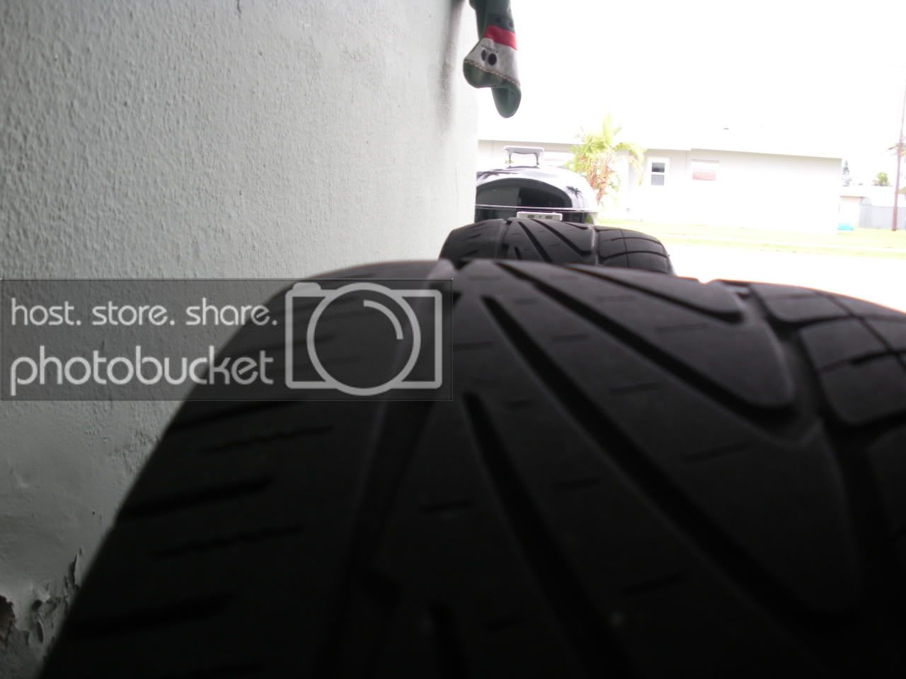

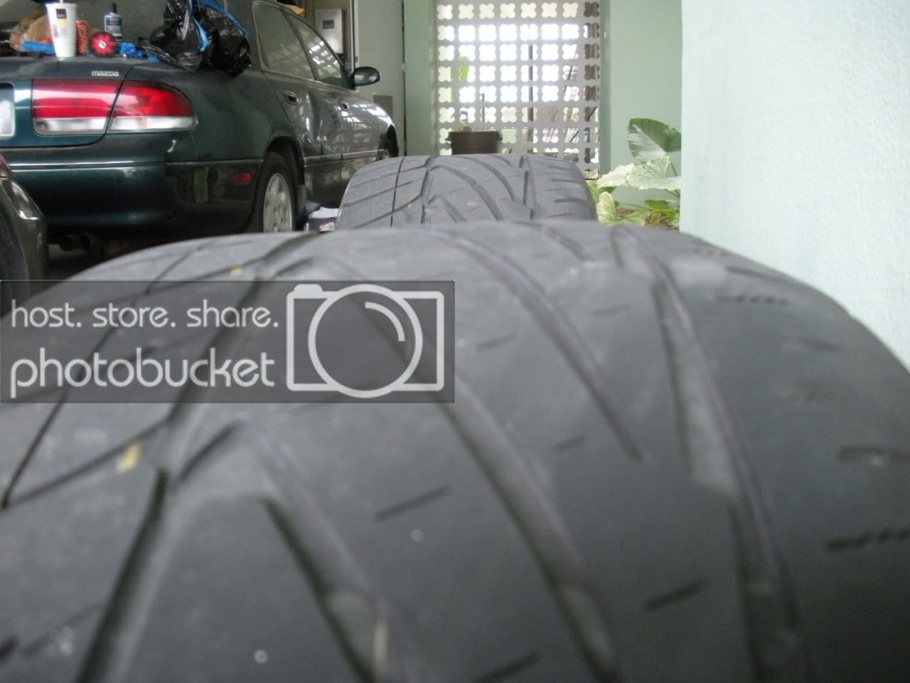

i decided to rotate my tires today cause i'm taking my car on a trip to upper FL and just wanted to get a good look on my tread wear. OUCH!
so guys, just check your tires. especially if the cars lowered. premature tread wear is FTL.
looks like your out of alignment. Negative camber FTL. I've never had a problem with any of my lowered vehicles.
i need to roll my rear fenders so my camber was set to highest possible w/o having the wheel hit the car. then with all the weight in the trunk it lowered the rear much much more and threw my camber way negative. so i need to make some adjustments but more importantly roll the fenders.
