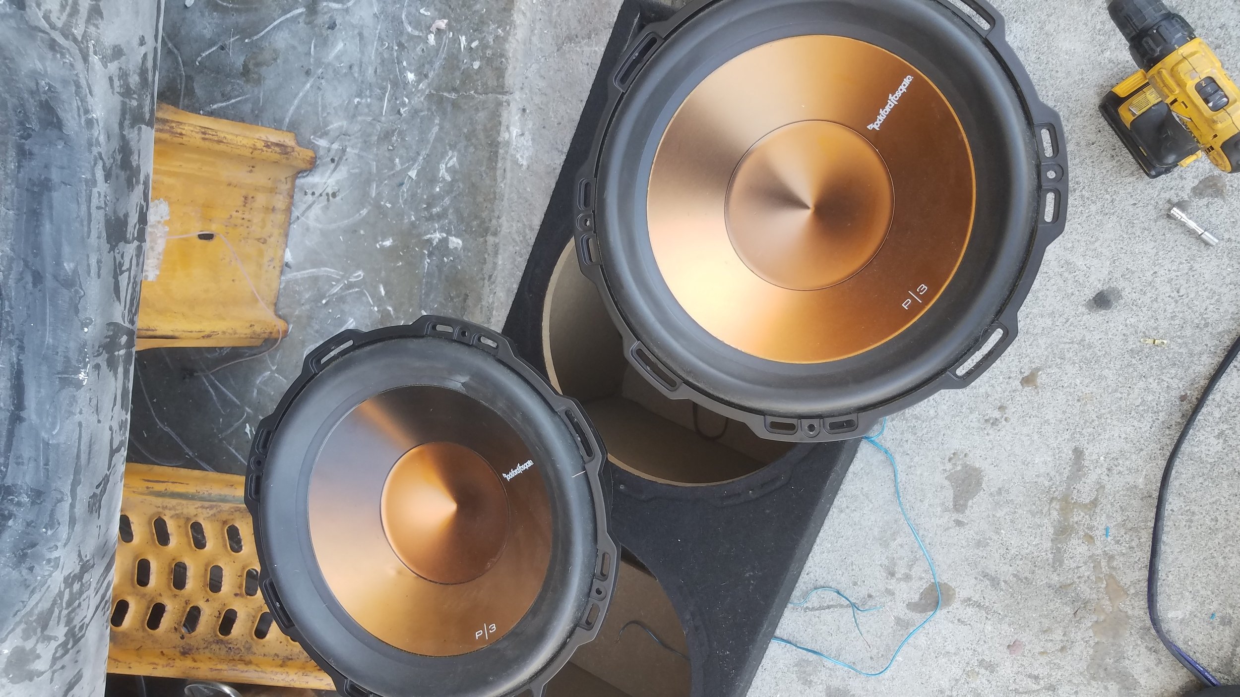

Ok thanks to you guys i found out that my rf p3 12s were well broken in. I decided to run one of the subs and pick another brand new. The subs weren't the same impedance so one will be put in my truck.
The car is a 73 nova. I have a rf p1000-1bd and p400-2 that will use for my doors.
I do have a prefab box that fits perfectly but i wanted something that will tuned for my preference.

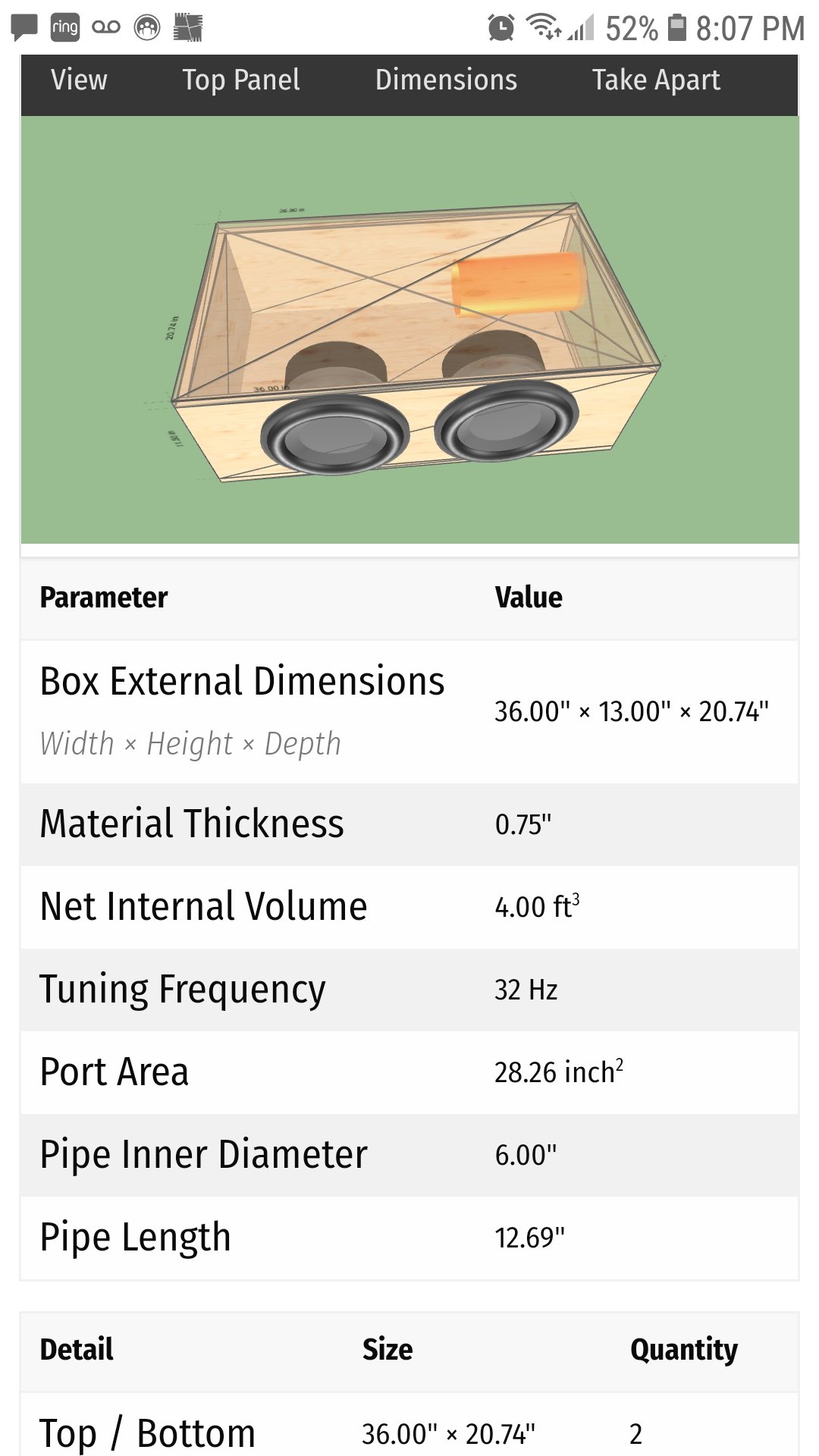

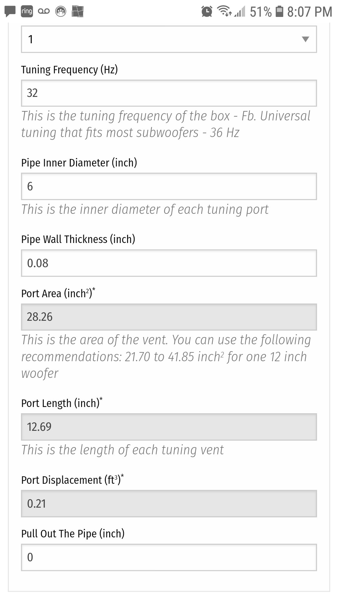

Hey. Ive been playing with the free program and this what ive came up with. Could you tell if this will work. I will also do a double front baffle which this program dont allow me to add.
Thanks for your help

It looks basically fine but why not put the port and subs on the same face?
Personally I'd be sure to buy a real aero too. PSP makes a good one.
Yep. Thats the free program. I plan on putting them on the same side. This does help. Im guessing i can move the port anywhere and still be the same.
Maybe add .3ft3 or so for sub displacement and some bracing on the larger panels too?
Idk if that program allows for sub displacements or bracing.
Yep... Subbox... my fav... :rolleyes:

The program allows for displacement but i wasn't sure if it took in the account its two woofers. I will do some math and check. I will also probably do some 45s and come up with something to brace the aero port as well
