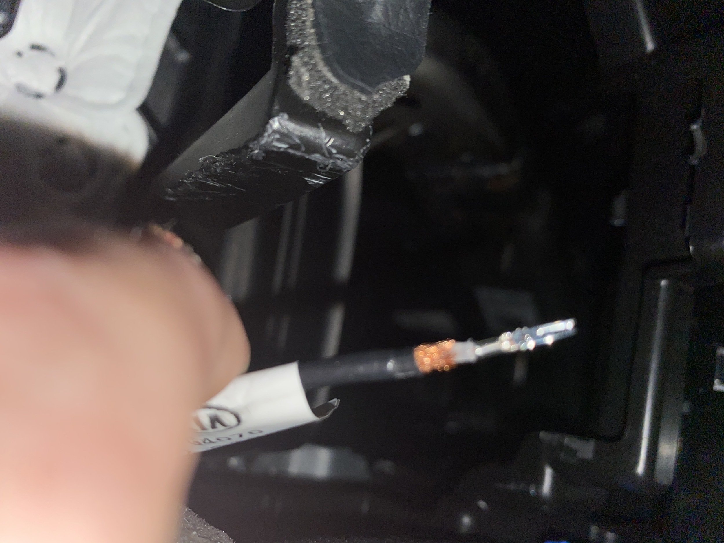

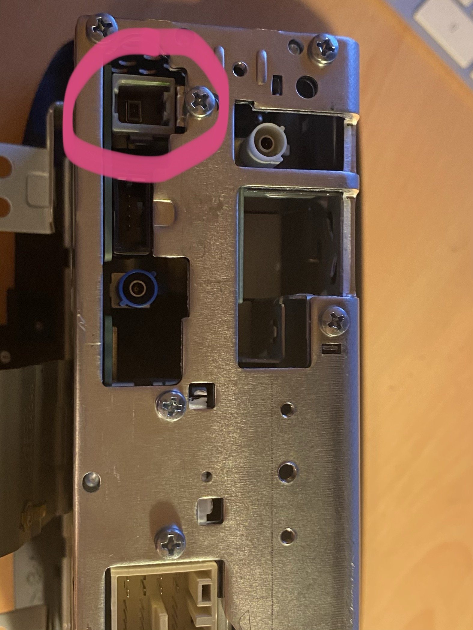

so....stupidly I pulled the pin out of the GT5 housing when reinstalling the head unit.

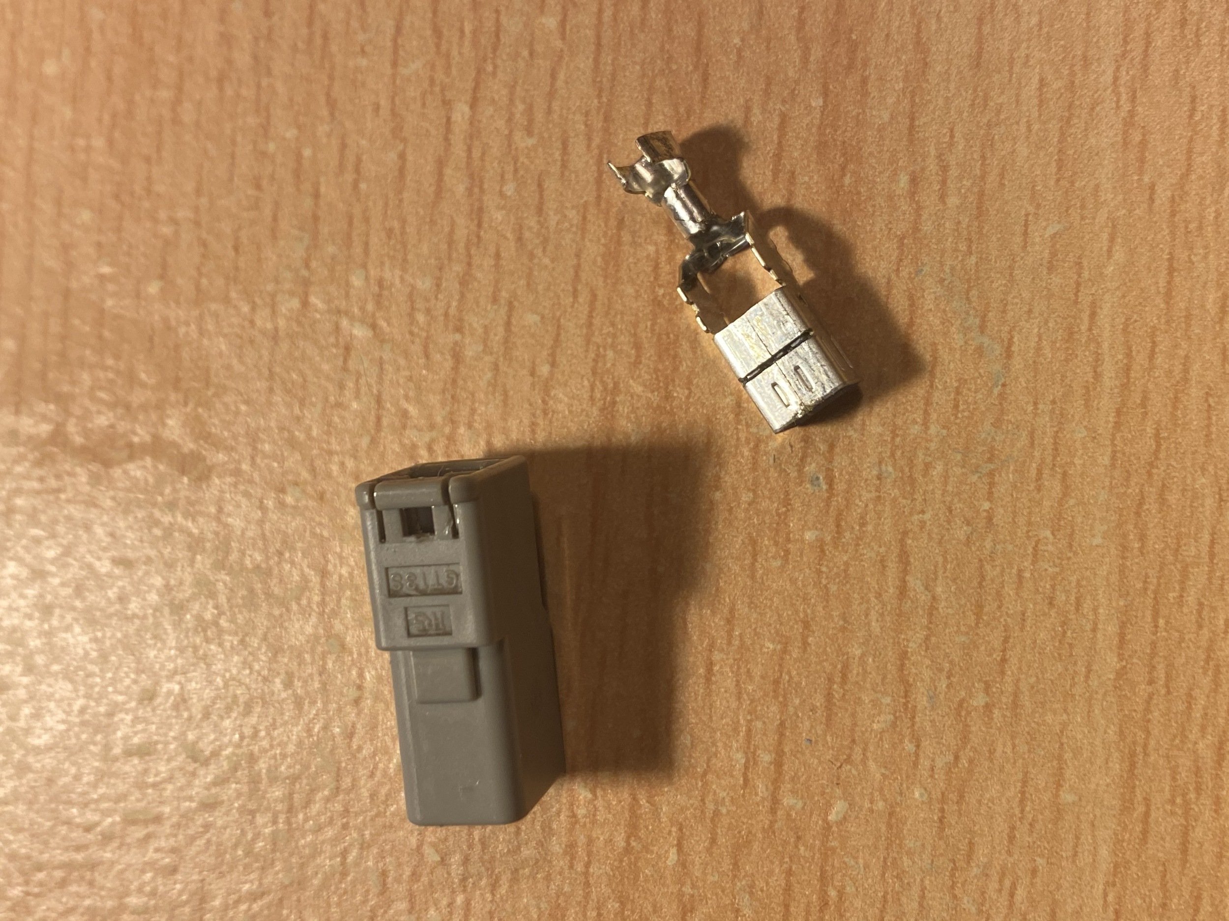

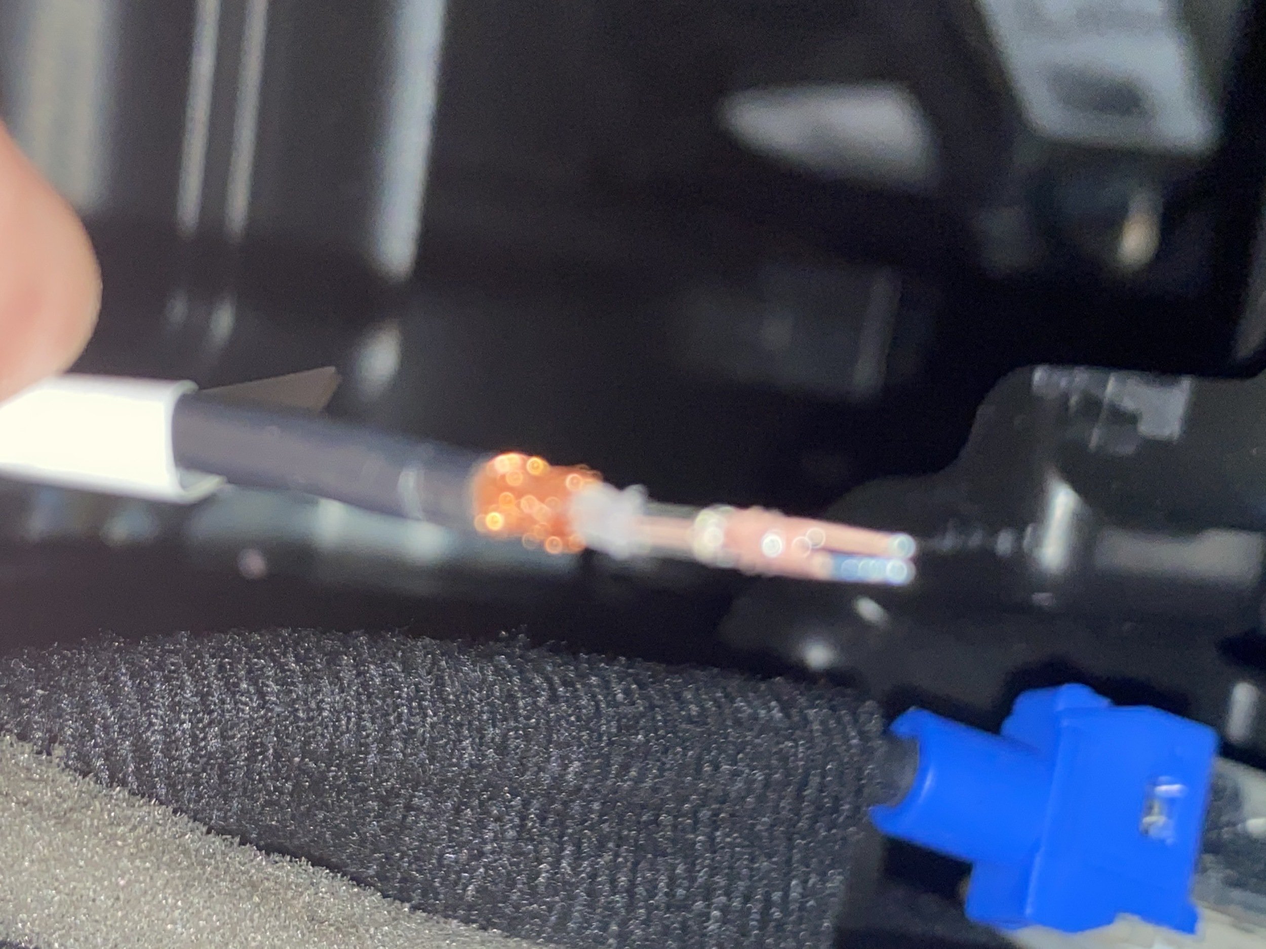

Ive noticed that on the connection crimped to the wire there is a "forked' connection...see attached pics
How do I rewire this back together?

It looks like the center portion of your cable has to be crimped to the narrow section of the connector; where the tabs are sticking up. Place the center wire on it and close the tabs. The stranded copper wire needs to be connected to the wide section on the connector.
Try looking up" wiring a GT 5 connector", on the web; to get the concept.
Good luck.
