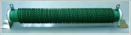

I was wondering something: Is it possible to use resistors to achieve a final desired load on an amp?
Like for example, you have a dual 1 ohm voice coil subwoofer but want to wire it to 1 ohm final load. Could you wire it to .5 ohm and stick a .5 resistor in there for a final load of 1ohm on the amp?
Sure you can. But you would need one of these..
And about half of your trunk space.
You'd also be wasting a ton of amplifier power. In your example you'd be much better off running the sub at 2 ohms. The resistor would simply waste half the 1 ohm power as heat and the power getting to the sub would probably end up less than if you just wired to 2 ohms. Not to mention that the amp would be running much more efficiently.
