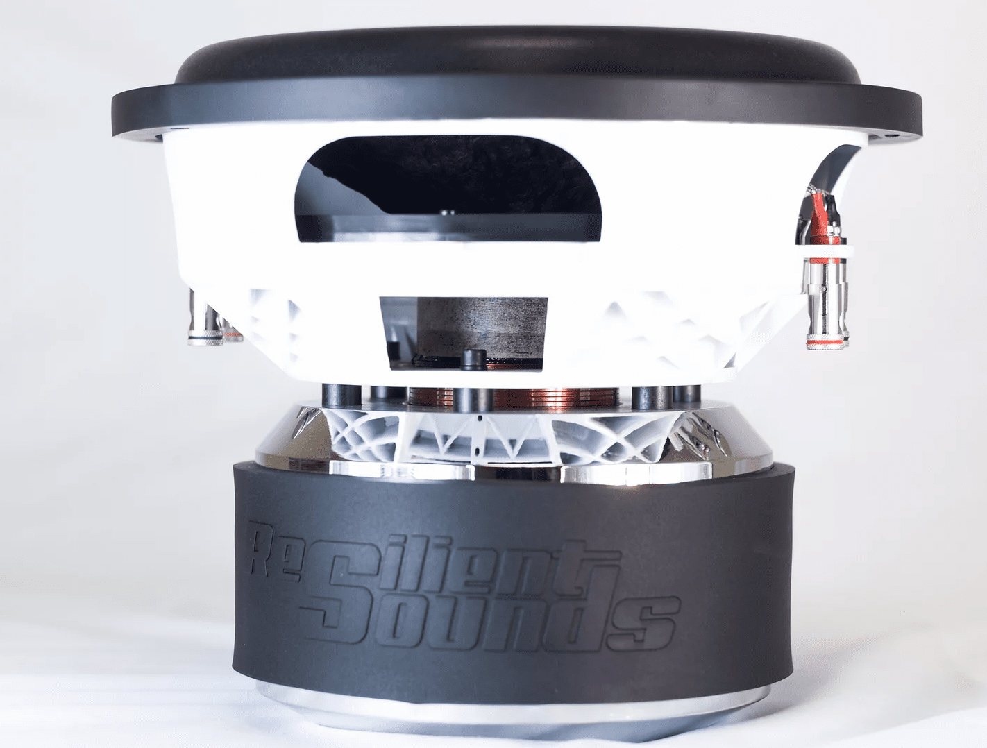

I've looking at getting a pair of heavy duty 12s and ones that caught my eye were the Resilient Sound Platinum 12s.
From a technical standpoint it has quite the attractive package in terms of power handling, huge BL and the inclusion of a shorting ring.
Physically, I also like the inclusion of what appears to be a collar on the triple joint and bolted-down spiders but my main concern is the usage of spacers on the motor (10mm from the look of it).
I understand that the inclusion of spacers should improve cooling but my worry is that it seems quite fragile. I am guessing the motor assembly weighs about 50+lbs and it seems like a high-stress point when the woofers are mounted vertically (as most people do). With such a large weight, if the box is to be jarred or dropped it would be an immense amount of force applied through the spacers into the frame and I could foresee the frame cracking. Even when statically sitting there, mounted vertically, it seems like it's suboptimal.
I'm purely speculating as this is the first time seeing such a large motor hung off such spacers. Does anybody have any opinion on this or am I just wrongly speculating?

The spacers aren't really a big problem. I'm not a fan of them but have had 100 pound subwoofers with them and no issues.
I would choose a different subwoofer personally.

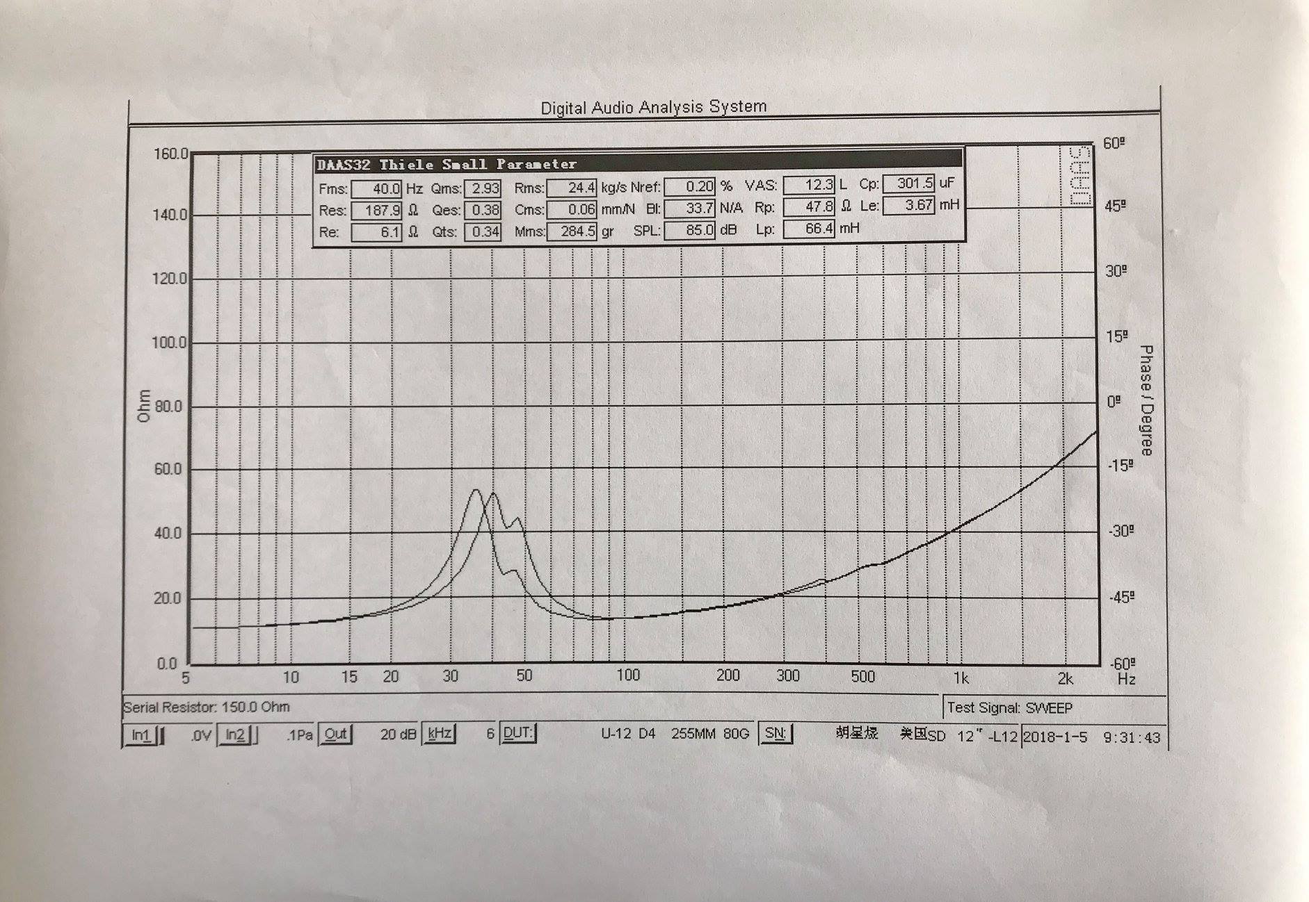

The other candidate that I'm strongly considering is the Sundown U12 as it looks like in terms of power handling, weight and build. One thing thing that is puzzling me is this strange impedance curve where there is a "double bump". I've never seen such a thing before (manifests itself on both D2 or D4 coil configurations).
Anybody have any idea of whether this is just an artifact during measuring or is it an inherent physical effect of the design?
