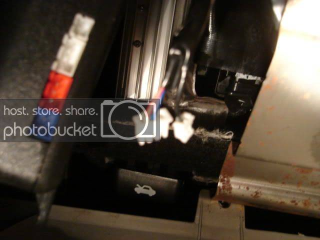

ok, here's a pic of what I'm looking at. I hooked the white 2pin connector (which has one black wire going to it) into the white 2pin male on the brain, and the white 3pin connector (which has a red and blue wire going to it) to the white 3pin male on the brain. I touched a wire to each pin in the blue 2pin on the brain, cycled the key 3 times as instructed by the manual, and touched the wires once quickly and again for a few seconds....nothing. Any insight? Am I missing something, or doing something wrong?

op its not as simple as just touching wires randomly there is a specfic sequence you must go through to get the alarm into progamming mode. FInd the manual for the alarm and use the given sequence just substitiute pressing the valet button with touching wires in the twopin connector
that's the exact sequence I tried - no luck. Maybe the brain is already fried, and that's why the connectors were disconnected and the transmitter didn't come with the car?
you sure it's all plugged in. like the power is plugged in, grounded, has 12v etc.?
I'm not, but I'm not actually sure how to check that. I wasn't able to trace the wires to the end. Is there a way I can check it from the end that plugs into the unit, or will I need to completely take apart the dash and trace the wires to the end?
