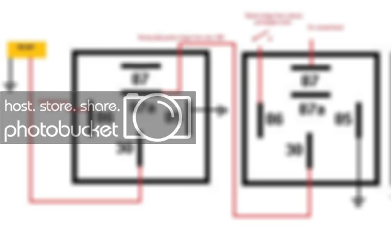

Normally open relay from the turn signals to a normally closed relay to the fog lights. No lights on, then no fog lights. When you turn on the markers, the normally open relay closes and passes power through the normally closed relay to the fogs. When you turn on the headlights, the normally closed relay opens and breaks power to the fogs.

All you need is a single relay but it's going to depend if your parking lights are a negative or positive trigger.
If they are positive, the relay would be wired like this -
85 - parking light wire
86 - ground
87 - fog light 12v wire
30 - constant 12v fused
And then you would just ground the fog lights. If your car had a negative trigger for parking lights onstead 85 would be 12v constant and 86 would go to the parking light wire.

should be able to do with just 1 relay
85: ground
86: head light +
87a: parking light +
30: out to fog light +
only works with pos park and head lights

The problem with that is your drawing the power for the fog lights from the parking light's power. Could be enough to pop the fuse, it would be better to run a second relay so you can use a dedicated 12V line. Kickerassman's diagram looks correct.
