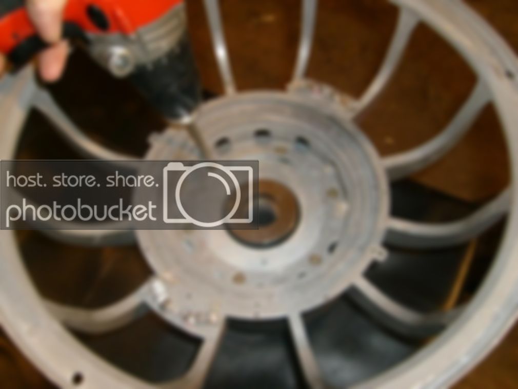

I didnt take any pictures of the really nasty part of the recone - stripping the sub.. This would of been just removing the old CA glue off of the basket. All I did to do this was buy some Aircraft paint stripper gel at Walmart and painted the chemical over the old crusty surround leftovers and let it sit overnight. In the morning, most of the material had bubbled up and a small metal wire brush was just used to abrasively clean off the black goo residue. I did NOT scrape, beat, or gouge the basket with a screwdriver or metal brush in order to get any of the material off. After stripper has been applied and let sit, the removal shouldnt be that hard to mechanically remove.
After you're done stripping the sub, clean off the surround and spider landings on the basket with Acetone to leave it as paint stripper and oil free as possible. You could probably skip that step, but for the amount of money and time you have invested in doing this, its worth a bottle of $4 acetone at Walmart - Right?

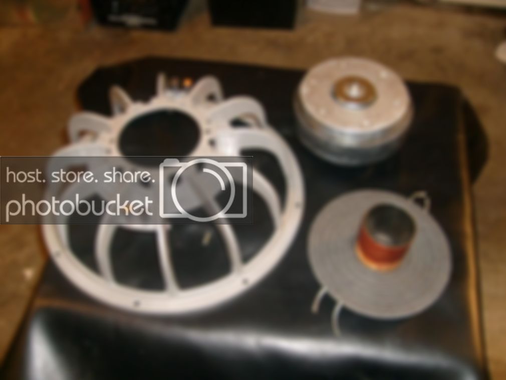

Here is the driver after its been cleaned and seperated from the motor.

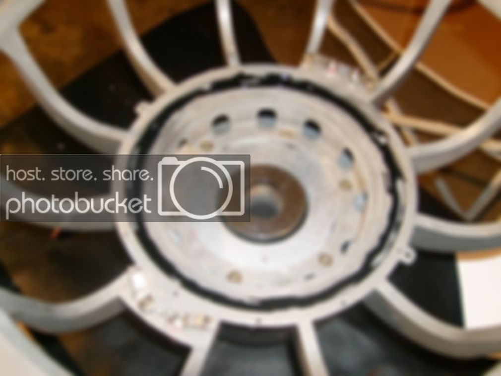

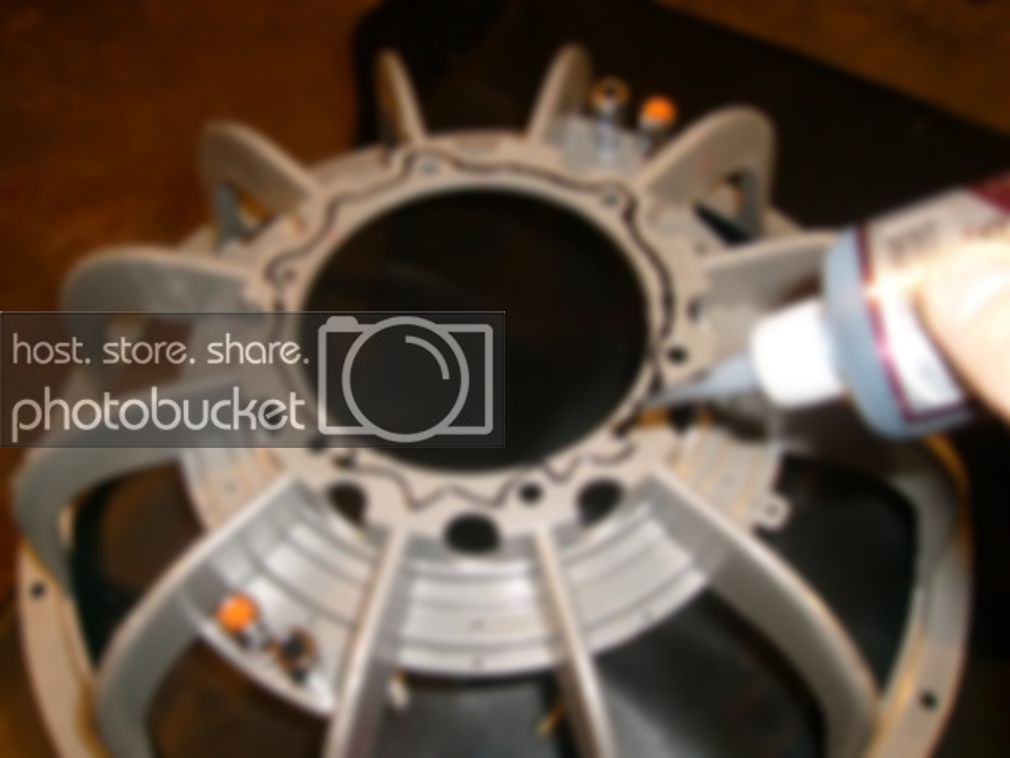

The motor top plate should be clean and clear of all debris for a perfect fit onto the basket assembly.

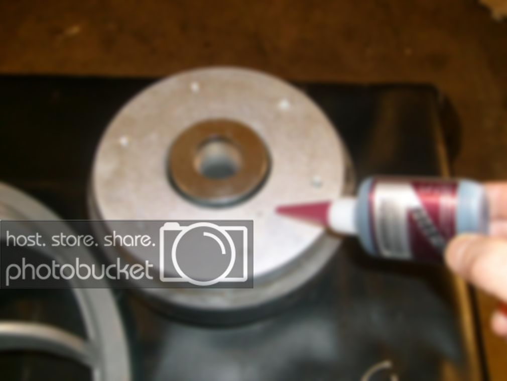

Apply a bead of CA glue to the bottom of the basket
Before the glue dries, attach the basket with the required screws. Do not overtighten, but make them a snug fit.

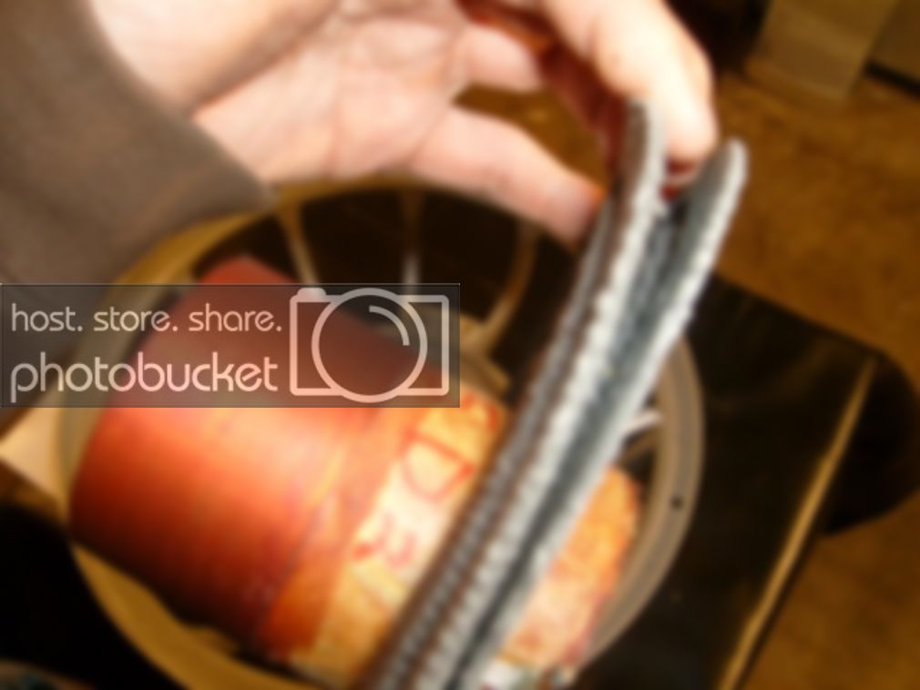

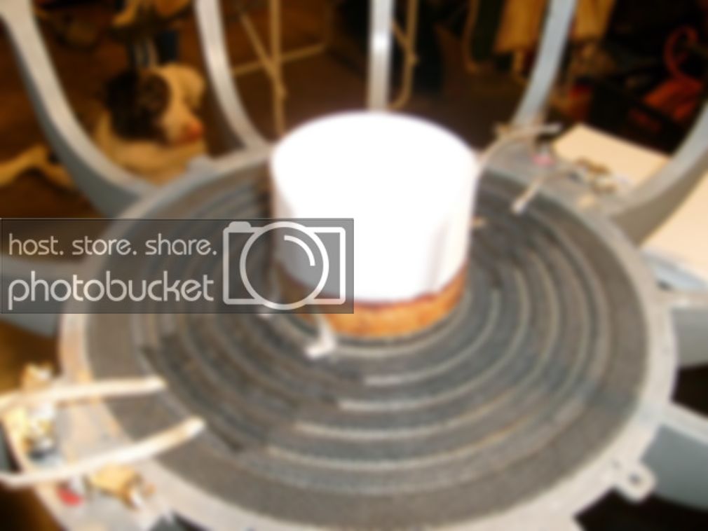

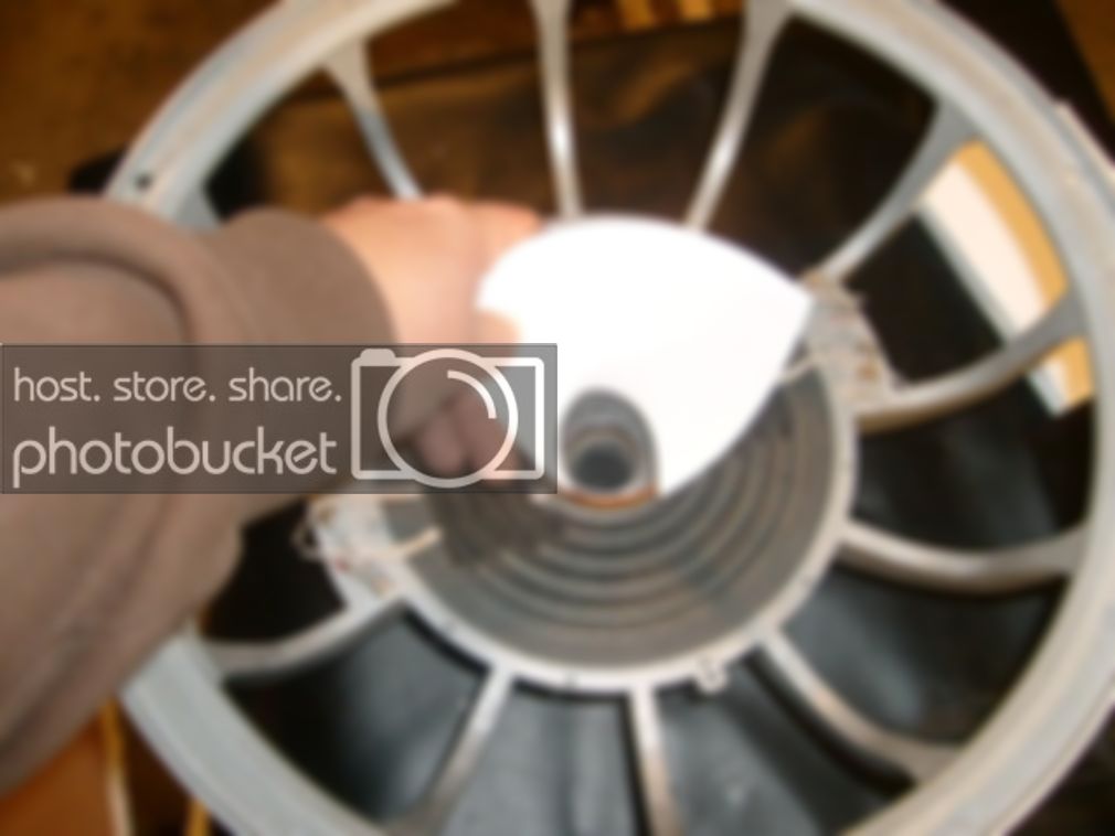

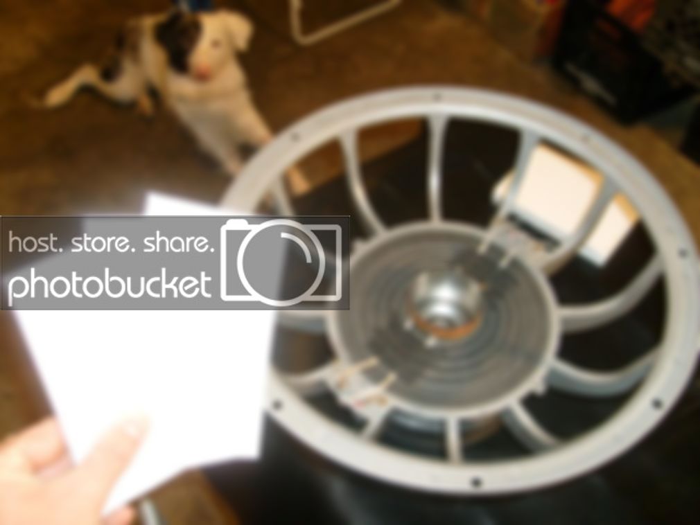

First, lets make the voice coil shims fit before we glue anything. As you can see, I am using three index cards I just bought at walmart.

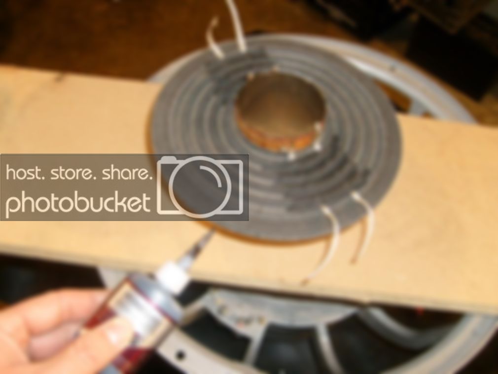

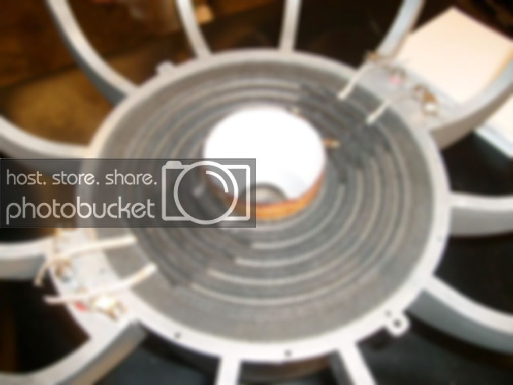

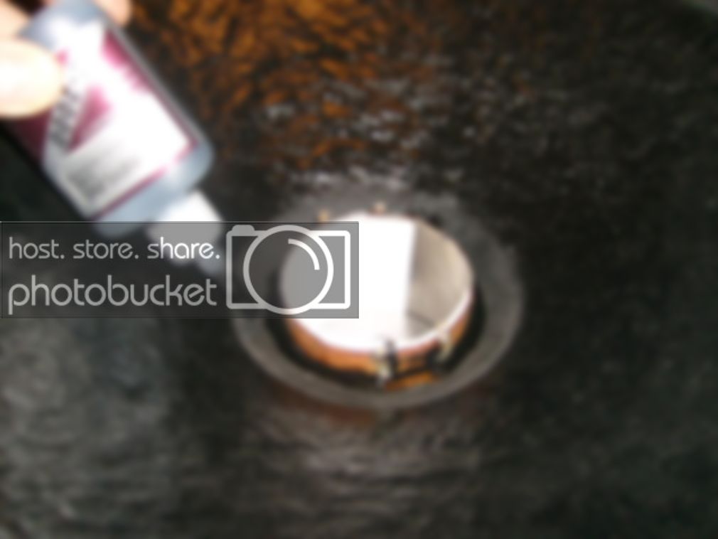

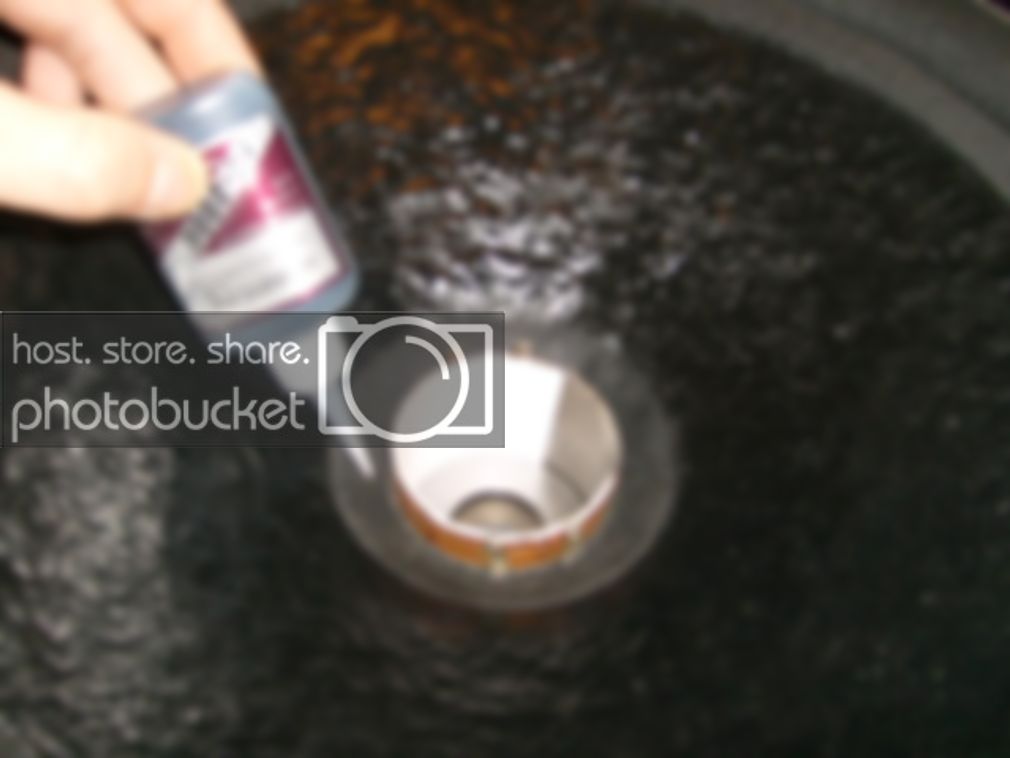

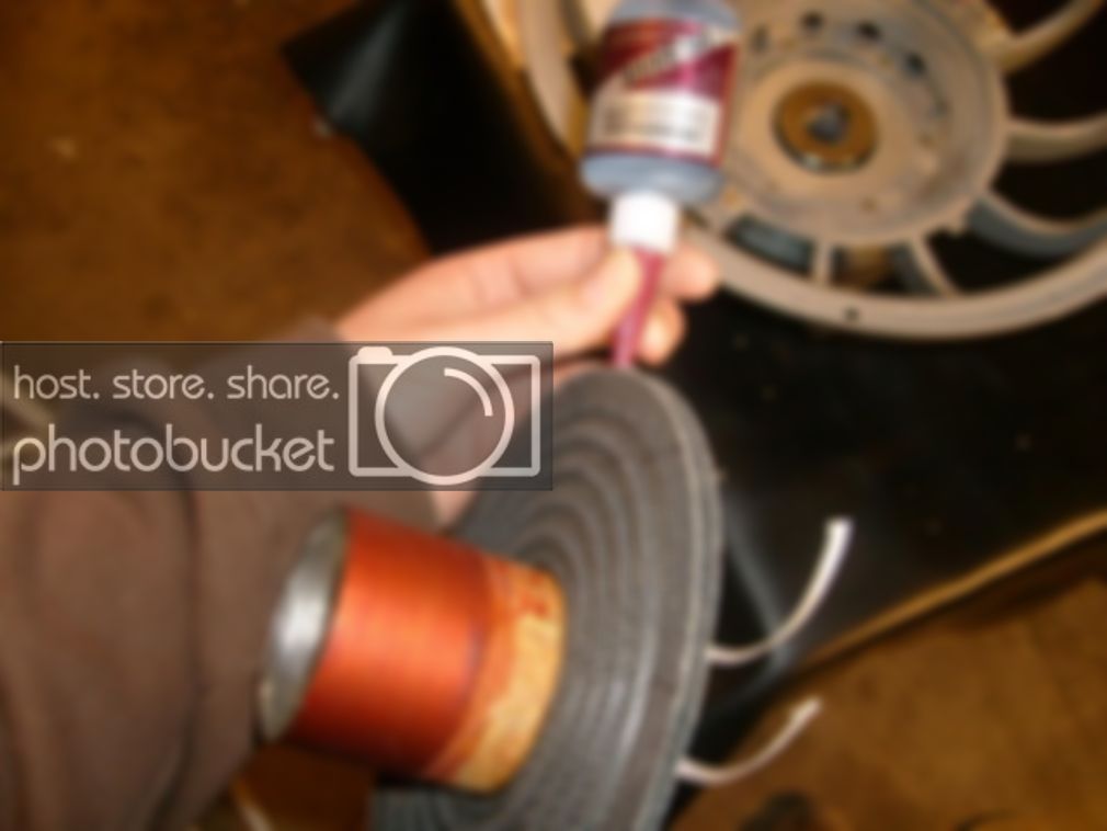

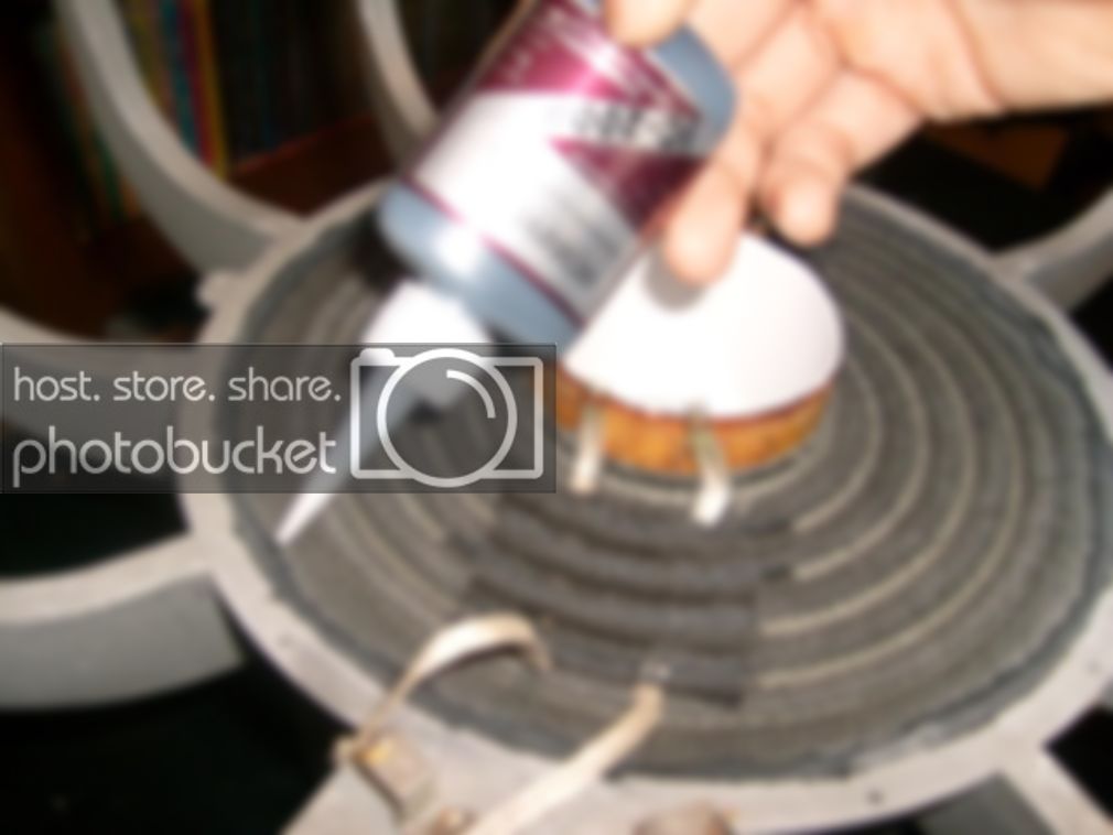

Next, we should apply glue to the dual spiders.
Now lets put glue on the spider landing.

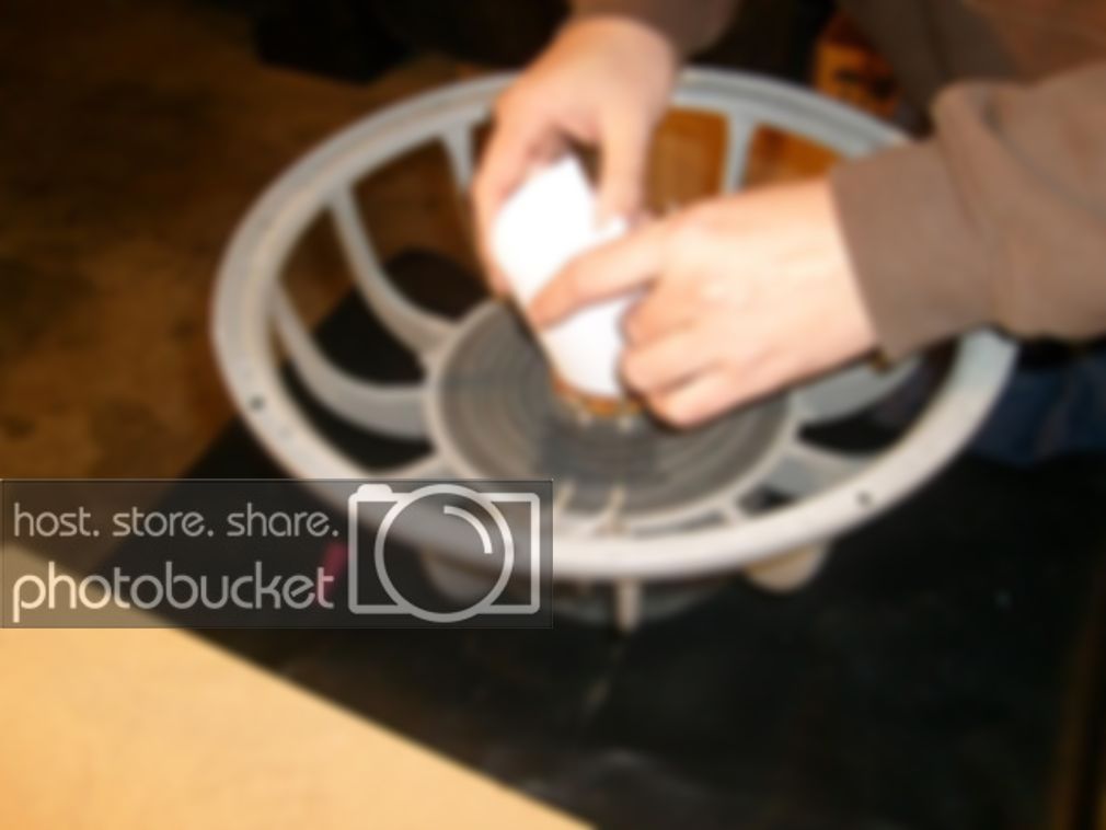

Then insert our shims inside the voice coil former
Now its looking great!

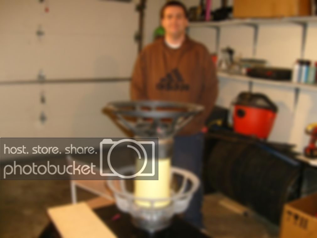

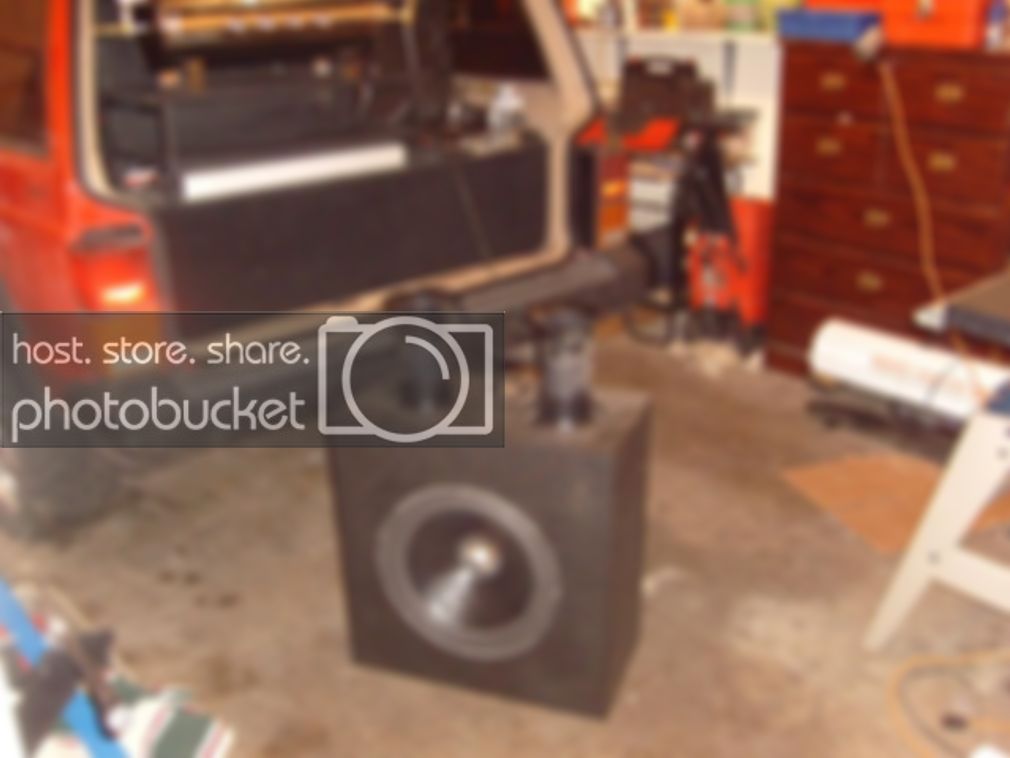

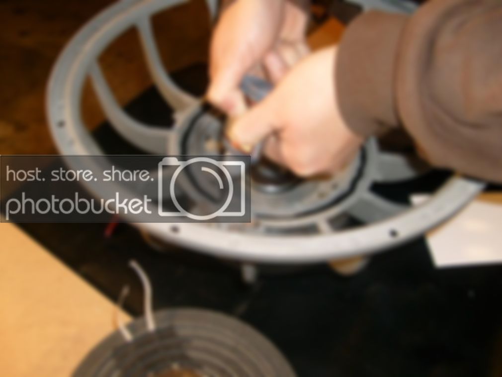

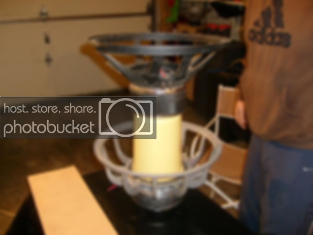

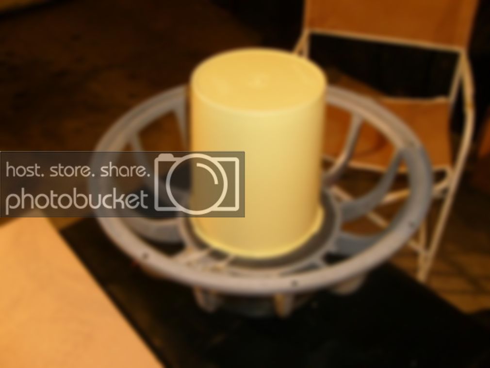

Next we’ll need some way to hold down weight evenly around the coil and spider. I found some odd shaped tupperwear from like 1970 for this, but as long as you get the general idea of how to disperse the weight evenly, you can use whatever you want.
Next I put a 35 lb Oz Audio Matrix 15 motor on the coil assembly so we can leave it to dry.
Me cheesing in back in the workshop

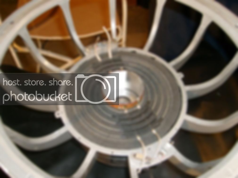

Since on this particular recone kit the spider ring was missing. The spider ring is just a plastic piece that surrounds the outside of the spider and you put 10 screws in it to hold it down to the basket. Since I don’t have that, I’ll just make a nice bead of CA glue around where this ring is supposed to go.

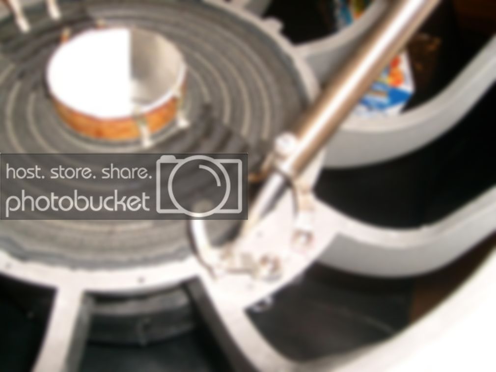

Now we solider on the tinsel leads.

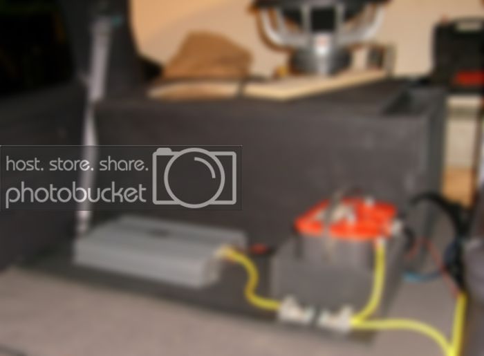

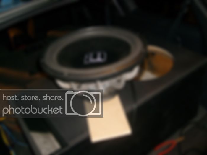

I got a new RD logo dust cap in, and slapped it on with some more CA glue. Then it was off to install it in my girlfriend’s Durango SPL setup.
I haven’t had a chance to put it on the meter yet, but it sounds great!
