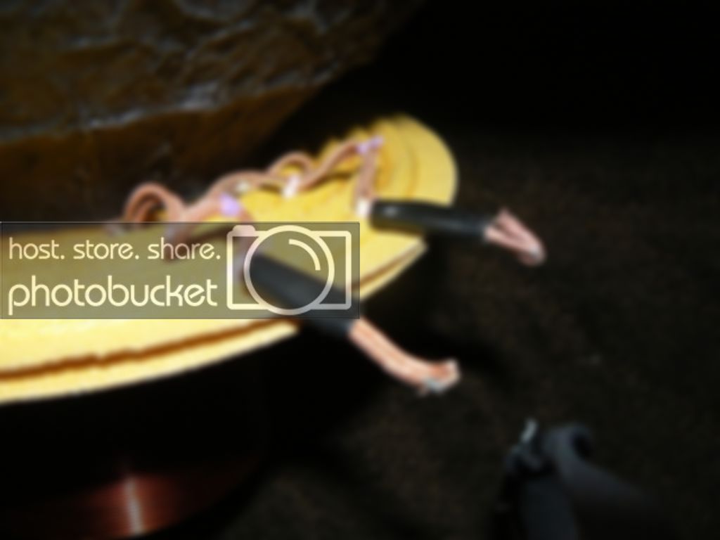

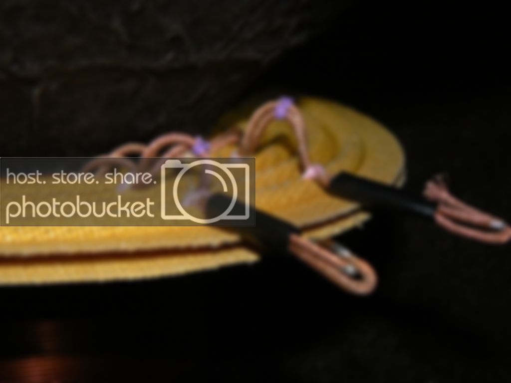

So I went back and beefed up those tensile stitching some more. I noticed the stock stitching had the tensiles in there pretty snug, and the ones I had made were noticably more loose. After adding more stitches all the tensiles feel as snug as they should be. I also put some threads around the middle humps of the tensiles to (hopefully) keep thier movement a little more uniform, though I'm not sure if it'll really help much....those tensiles will be shaking violently regardless.... I also added a little electrical tape to the ends of the tensiles to allow just enough exposed tensile for the speaker wire crimping.

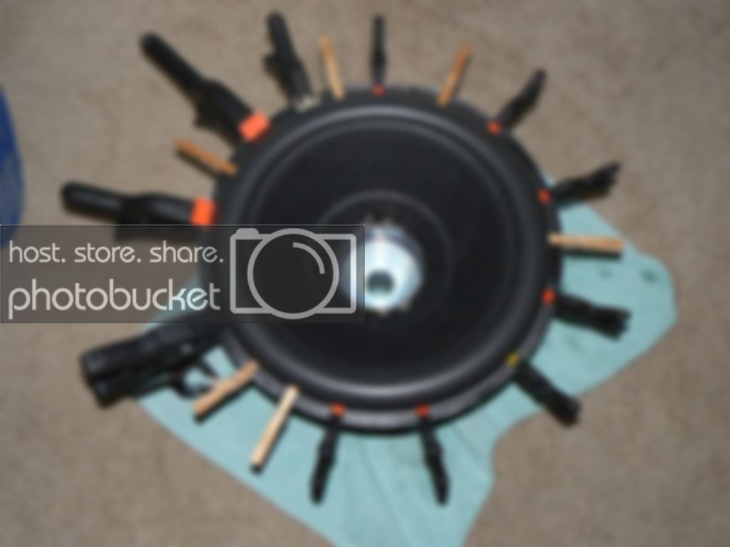

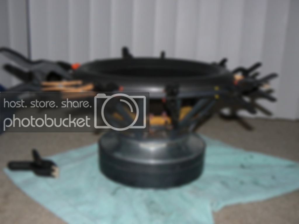

spiders are done.........surround got set tonight //content.invisioncic.com/y282845/emoticons/smile.gif.1ebc41e1811405b213edfc4622c41e27.gif

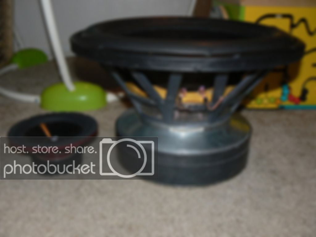

sooo......just waiting for the dustcap to come in the mail...had some minor delays with that //content.invisioncic.com/y282845/emoticons/frown.gif.a3531fa0534503350665a1e957861287.gif

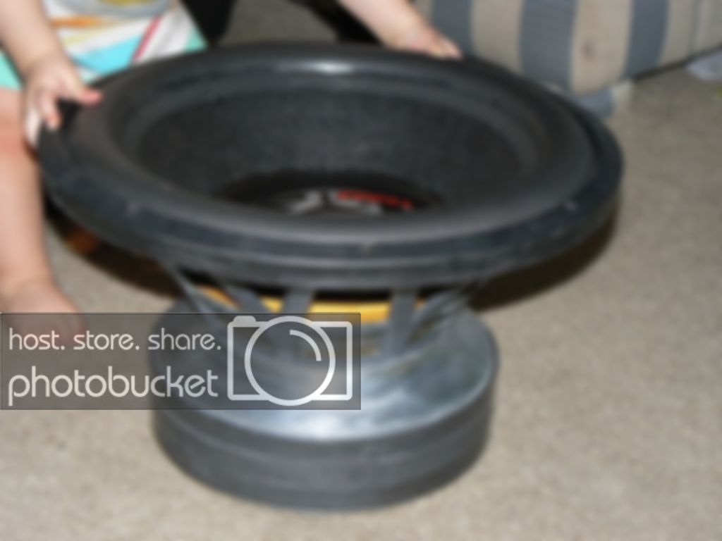

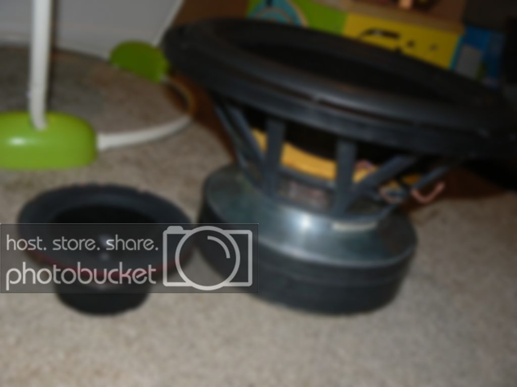

the surround is also having some issues....the surround is an original part from 2002-2003....the bad news is because of it's age it's actually cracking slightly in a few spots. I'm in talks with the recone builder to get everything taken care of. He's been helpful so far, though in the mean time I've glue up those spots.

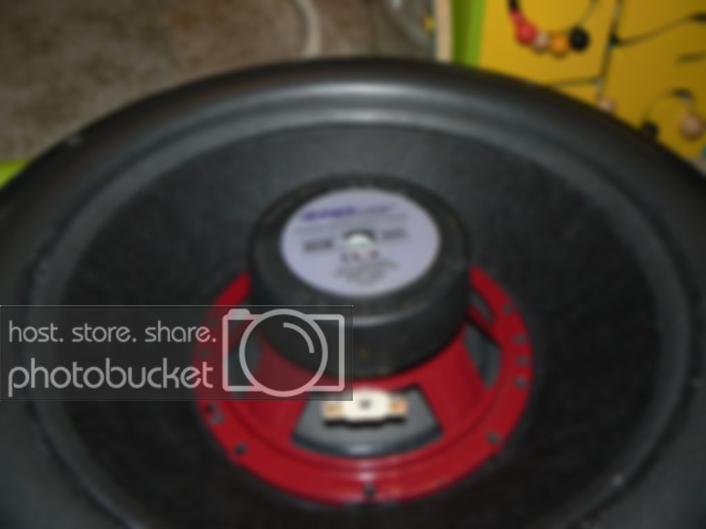

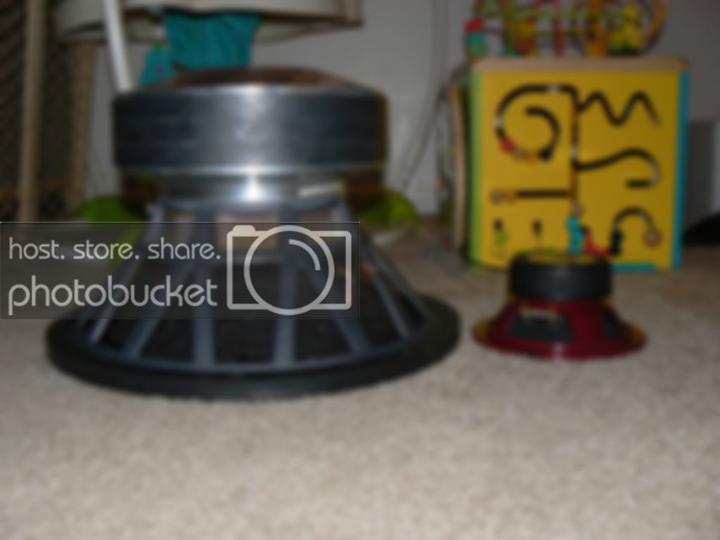

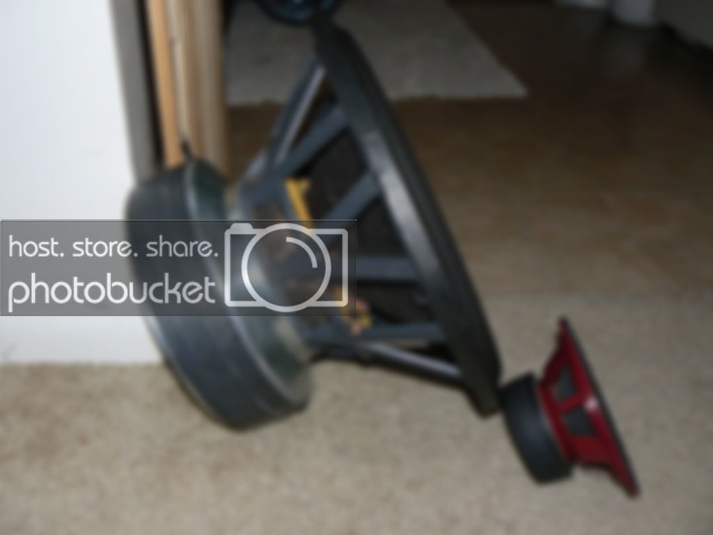

here's a few shots of the beast siting around burning a hole in my floor....in comparison to a cdt cl-6 midbass...

instead of waiting longer im just using my old scratched and ****** trf dustcap. since the surround now has glue on it to take care of the cracks im not as worried as much about perfect cosmetics for the front of the sub. should have by bass back and operational soon.
The parts I put in failed...bas glue advice from the seller....but the seller gave me some new parts, so here we go again.....
this time around I got a hold of some 220 grit sand paper and polished up the motor. It still isnt perfect, but it's sure as hell alot nicer looking than before....
